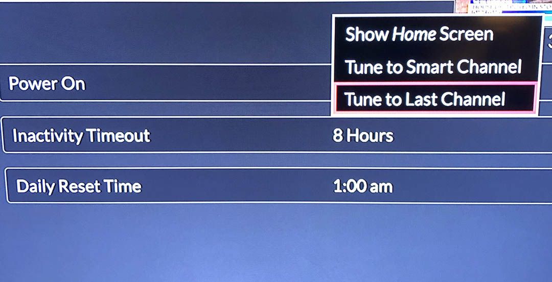

Apparently Dish has made a change that reset the setting for turn-on. I have the same problem in a Hopper 3. The fix is to go to Menu; Settings; Power; then change the "Power On" setting from "Show Home Screen" to "Tune to Last Channel".
Wow! 6 year old thread resurrection! By the way the option to choose between last channel and smart channel (which is what was discussed above not the home screen) has been around for years.
Settings, Power...............
