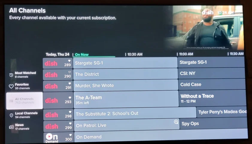

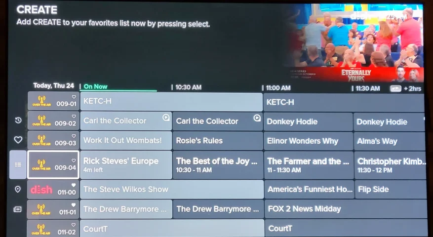

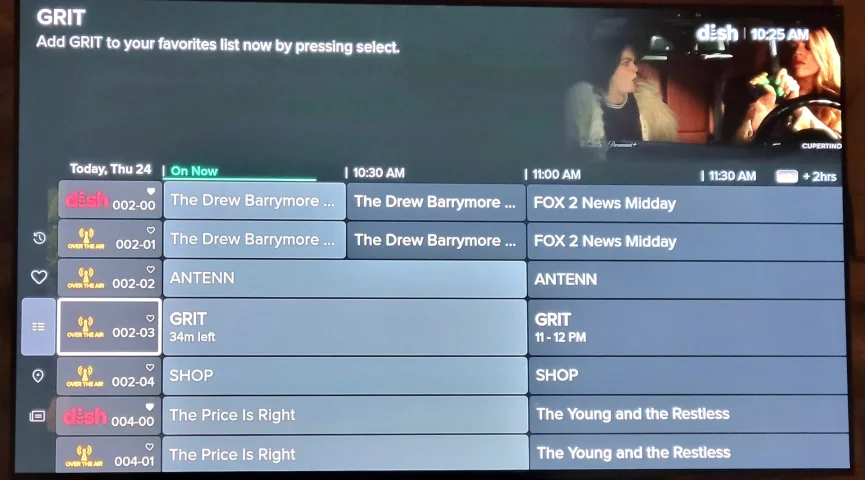

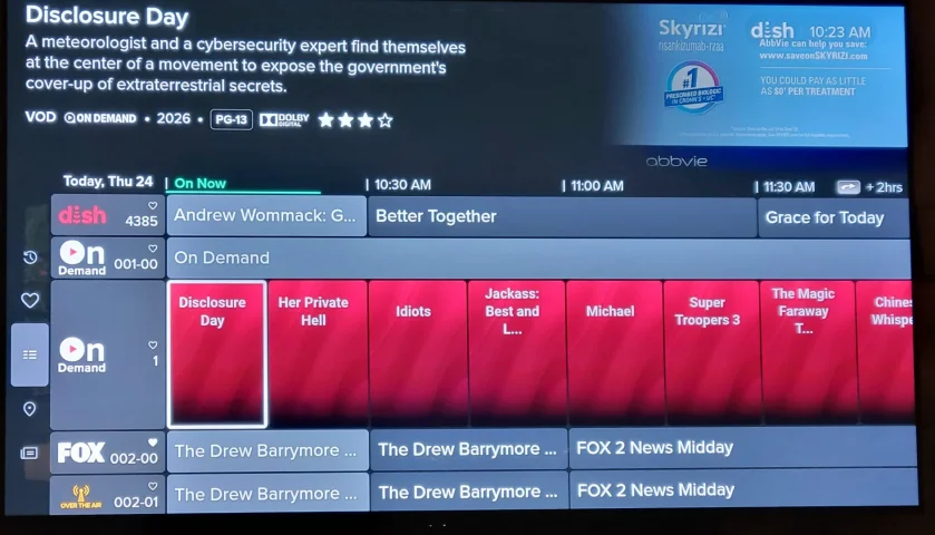

Has anyone experienced a change on the Hopper3's guide? Last week most of the names of the channels have vanished and been replaced with DISH. Attached are screenshots of what I'm seeing. Also, when I stop at the On Demand channel no pictures are showing. I've updated both the Hopper3 and the Hopper Plus.
