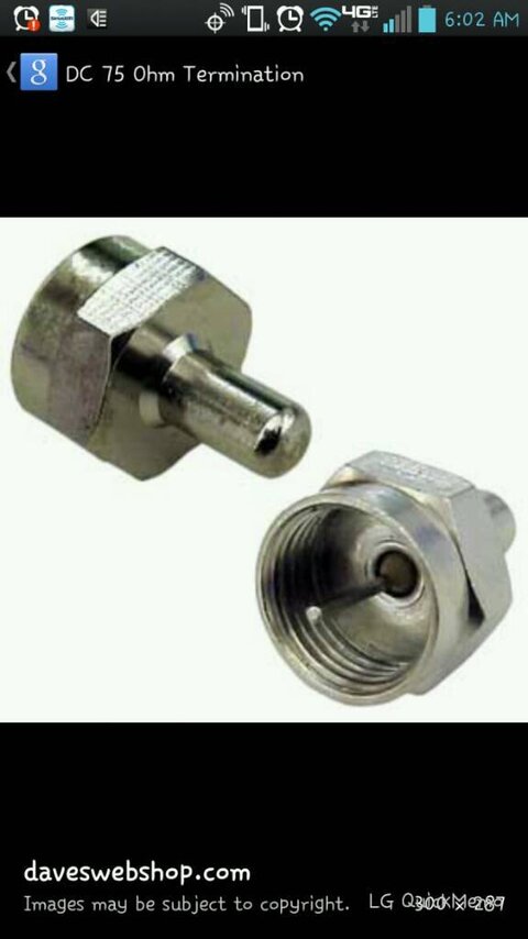

Yes, no power supply for the 44 switch means there's not enough juice running back to power the lnb. To terminate the open ports, they look like little silver nipples, and the have a stinger in them. I'll post a pic of one.
This is what you need to properly terminate any open ports in a hopper system.

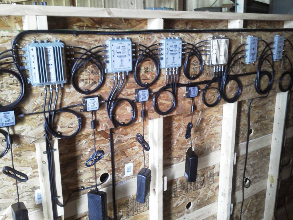

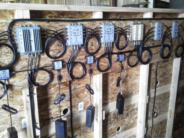

I setup a downloading station in our shop, to pre download receivers for our techs. I have a 1000.2wa feeding four 44 switches and two duo nodes. It wasn't working right until I capped off EVERY open port on every switch and both nodes.
