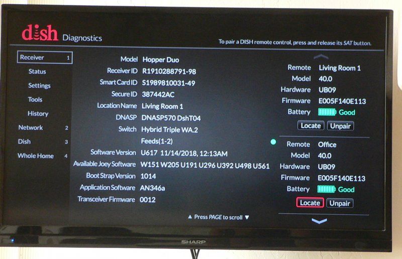

Another idea, so we can get an idea... can you take a screenshot of your info page where the remote is listed. Black out all of the information on the screen, except the remote information on the right.

Here's the picture that was requested. The TV is connected to the Hopper thru the HDMI port, and the picture was obtained by pushing the SysInfo button on the front of the Hopper. The TV does not have an auto-dim. Clicking the LOCATE in the red box causes the remote to respond.
Bill
