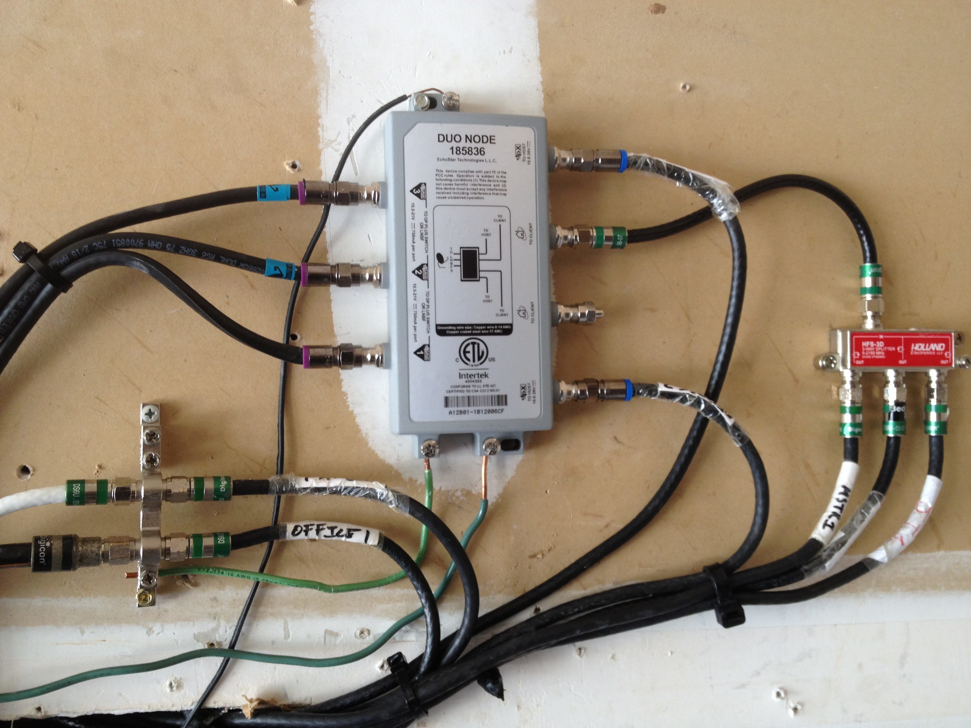

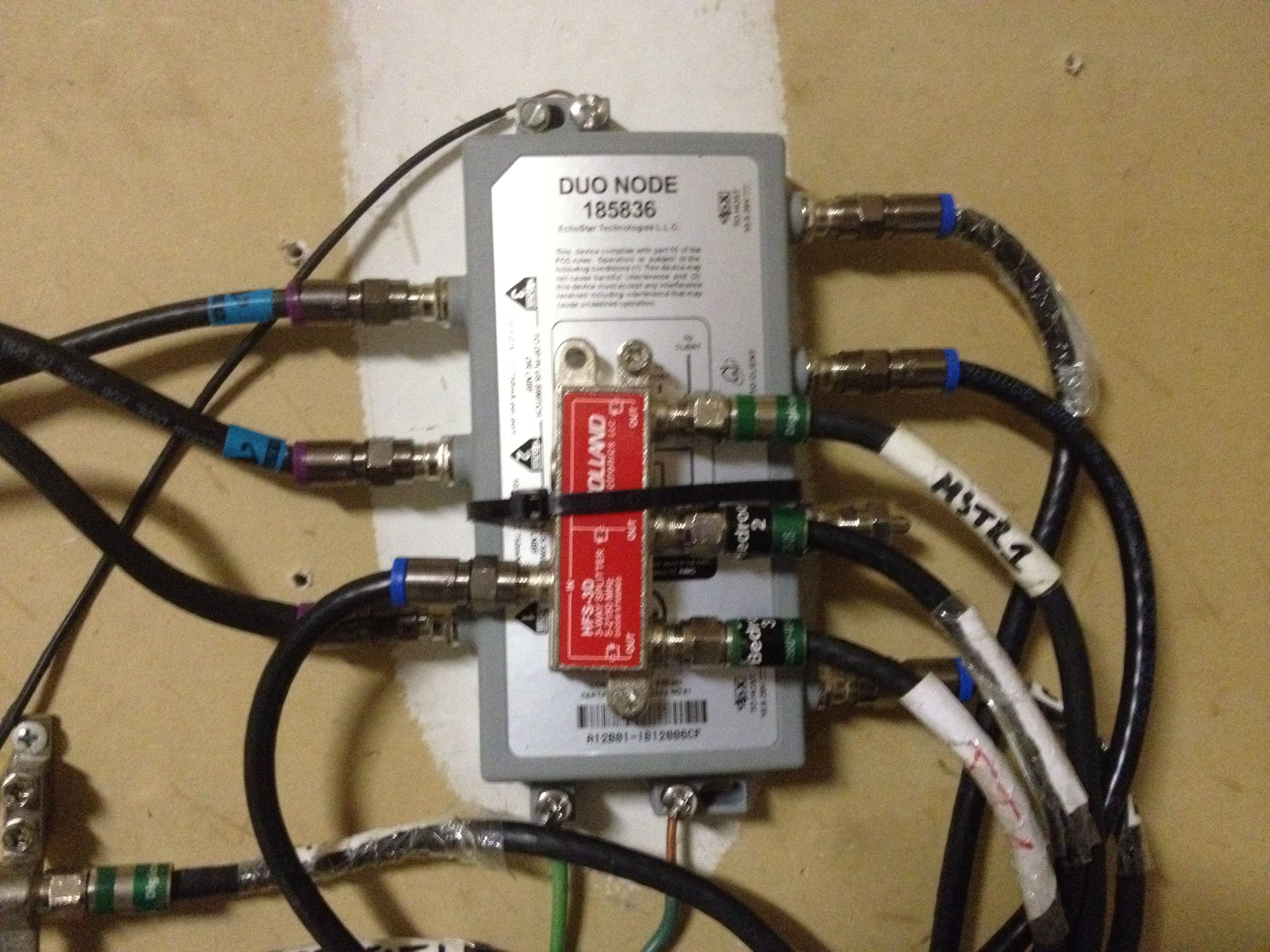

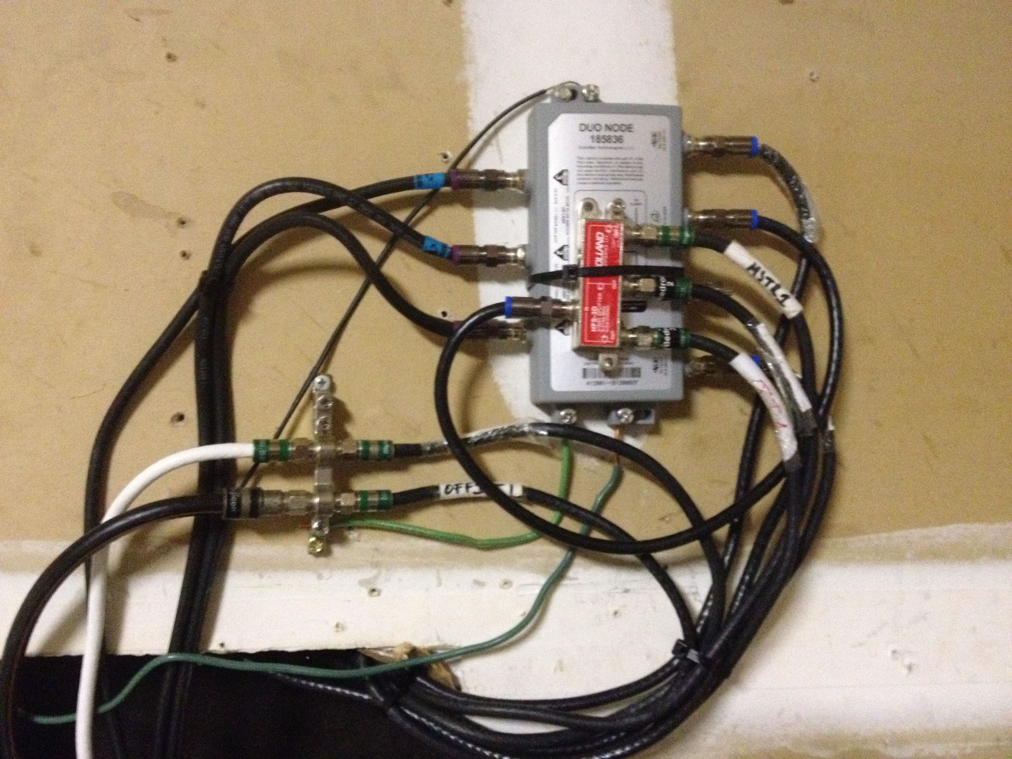

Some pics of the cables. Please note I also have an OTA antenna and Time Warner Cable coming in, so there are a lot of cable there that are not DISH.
