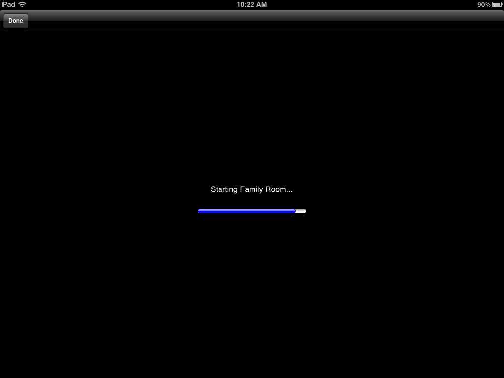

In my experience, about 80% of the time the Sling Adapter doesn't work on my iPad. The status bar progresses just about to the end, stops and no video is displayed. Attached is an example of what it looks like. To get it working I have to reboot the Hopper receiver either from within DishOnline.com or manually from holding down the red button on the front of the receiver. On page 2 of the System Status page, the Sling Adapter Status says Ready and the Adapter Version is R03.03.11. If anyone has experienced similar issues and resolved it please share. Thanks
