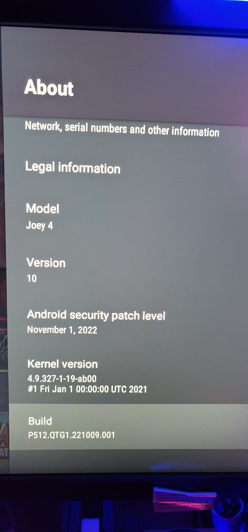

Early this morning. I tried to manually update yesterday buy the tools and even power cycling. Last time the Plus did not update with it. This morning both did. I suspected it crashed during the nightly update the bootstrapped back to the 110. Everything is so much better now!
Thanks for the response. I will have to check mine again when I get home. I also tried a manual update yesterday with no success.
Are you noticing your Joey 4 remote control work a little faster on P512?
