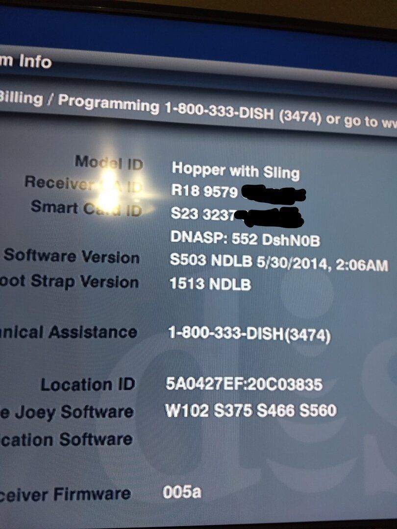

I picked up this hopper w/sling recently that appears to have been out of the stream for at least 6 yrs.. Software version S503..I activated it over a week ago with no problems and everything is working fine.. just stuck on old software.I tried several reboots with reboot button, unplugged,run checkswitch,Re-hit receivers with mydish app but nothing seems to want to update software...Any ideas?

Try forcing an upgrade using the "Upgrade Software" button on the "Tools" page of the "Diagnostics" menu. Press "Menu" twice on a 40.0 remote to get to the Diagnostics menu.
That's not on the old UI.
You also used to be able to go to ch 9607 and let it sit and would start downloading
When I go there I get the 140 code.. Unable to access this feature at this time.Data not available.Please try again later.

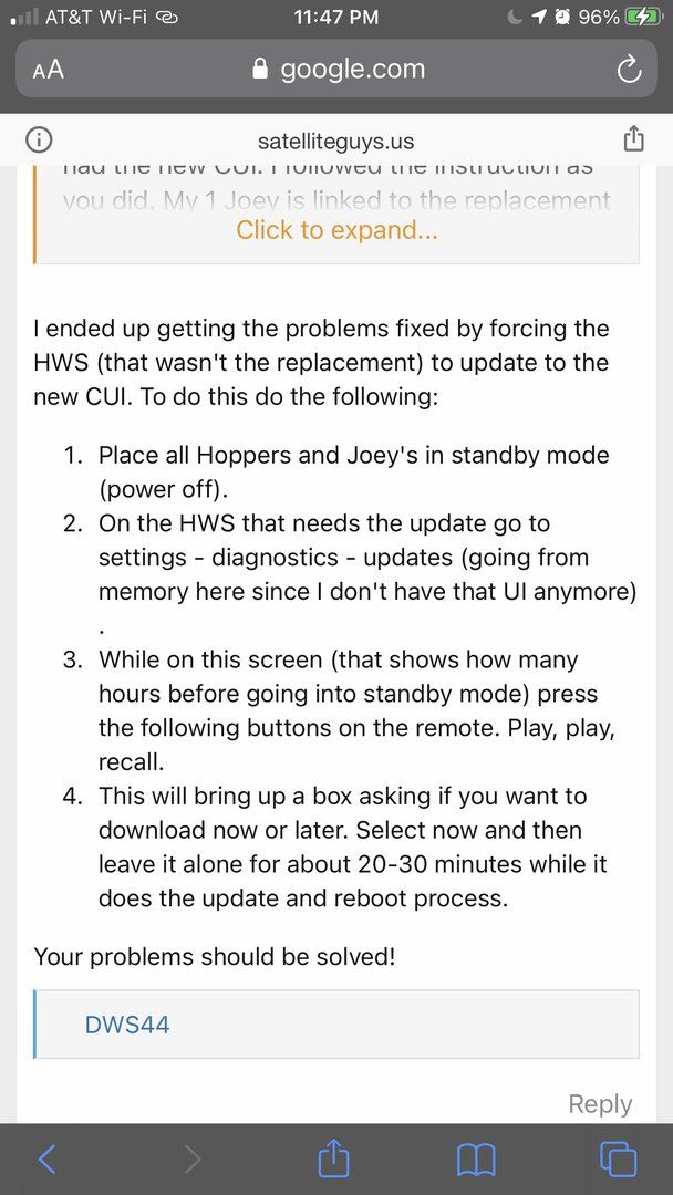

The 50 series remotes won't work with the old UI. You need a 40 remote although I would think the 20 series should work. If you can get it into Boot Strap, it'll update. Let me see or if anyone knows how to do that, it should work. One question, you are running via Solo Node, 2 lines from the Dish and a Check Switch passes?
blatimer1983 Thanks!! Those are the steps I was looking for.
Work like a charm.. Took about 20 minutes and updated to H201 .. thanks HipKat... your the best
