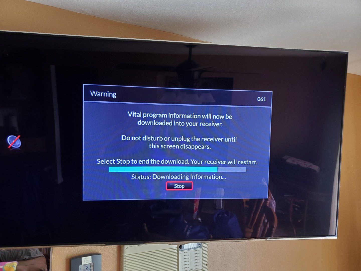

Then, if you have Joeys along linked to your Hopper, it will be best to put them in the stand-by screen. Putting the Hopper in the standby screen can cause the software to download if needed. Once in the standby screen, allow the guide to update and then the software download will happen 5 minutes with a 061 message.

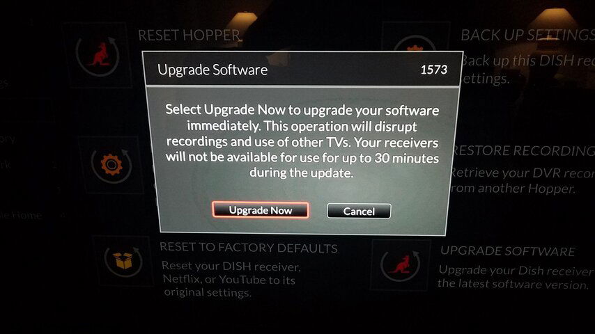

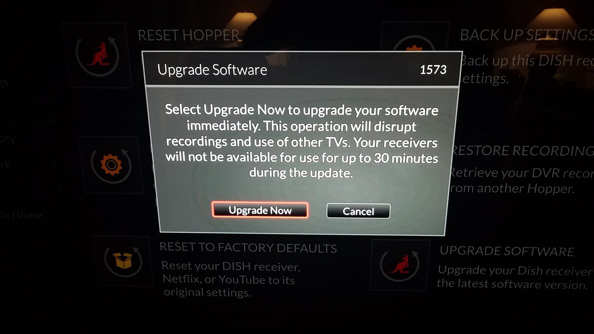

You force the software to update by pressing the home button three times (50.0,52.0,54.x remote) or Menu two times (40.0). This will take you to the DISH Diagnostics screen. Choose "Tools" at the left side of the screen, and then select "Upgrade Software". A 1573 pop up will come up where you can choose "upgrade now"
This will cause the receiver to reboot, then go to the standby screen, and finally to the 061 Software Download screen. Let's be sure to not use the receivers during this process.

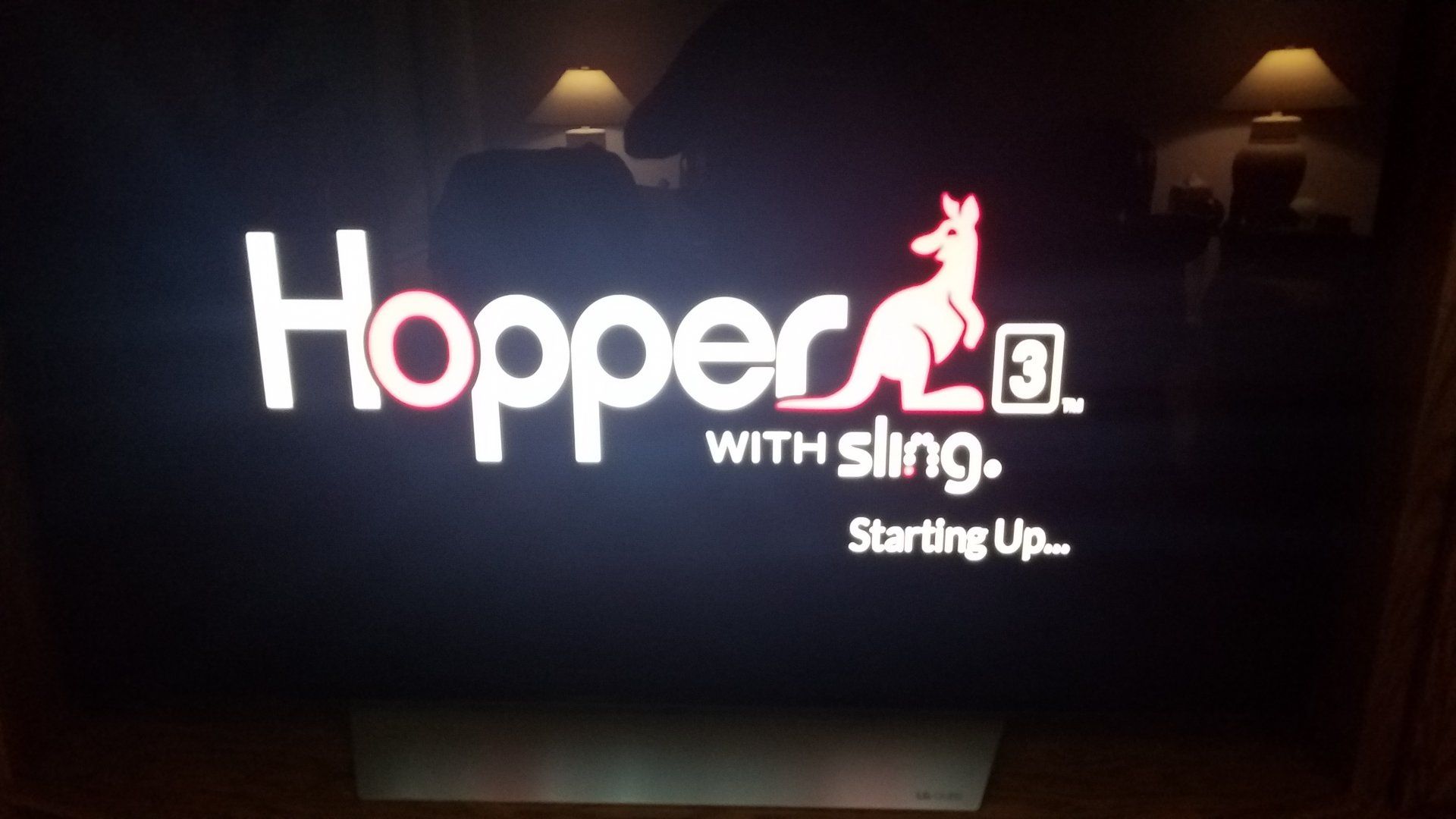

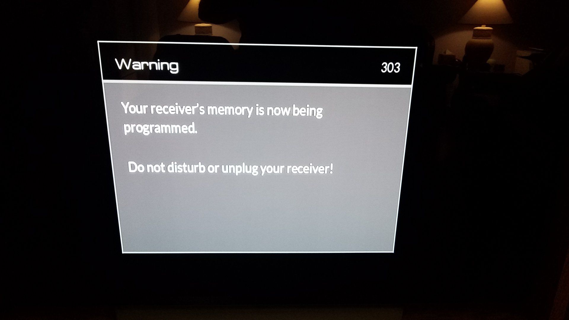

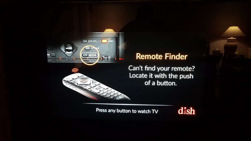

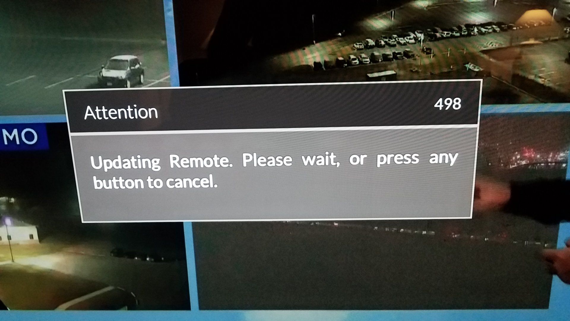

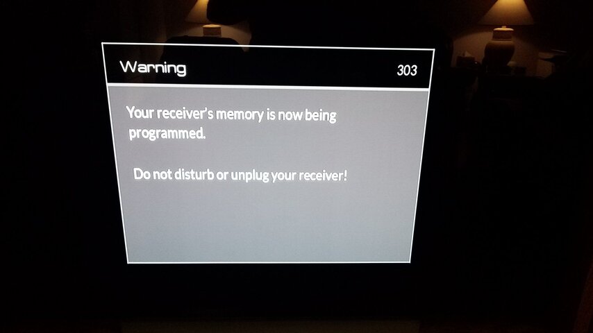

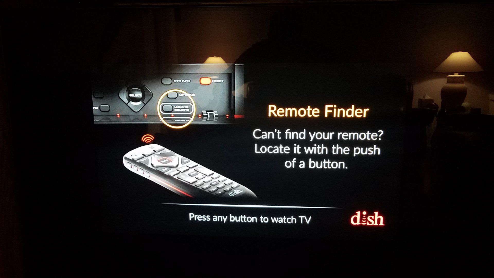

Here is a list of sequence of events that I made and I think it is still pretty accurate for forcing the Hopper software upgrade. Also attached is pics of the popups you will see.
