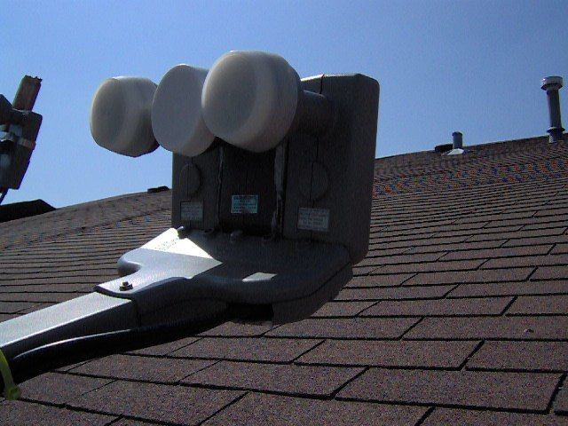

what dish do you have? A slimline or a phase III?
What happens if in the sat setup you put "3 LNB" (ie: phase III) regardless of dish. Otherwise I wouldnt worry if the channels come in fine
a slimline says "slimline" on it
a Phase III is smaller and has 3 equal sized "eyeballs"...the slimline unit has a bigger setup
slimline 5 LNB setup (since you mention 119 this is what it looks like)
62038d1298525236-slimline-3-swm-self-install-i-sl5_zoom-jpg
Phase III looks like this...well this is actually the LNB setup of a Phase II. The old Phase II dishes allowed you to put separate LNB's in it and has a external switch. Phase III has 4 outputs and it one LNB mold
62049d1298585594-how-my-signal-levels-im000796-jpg
