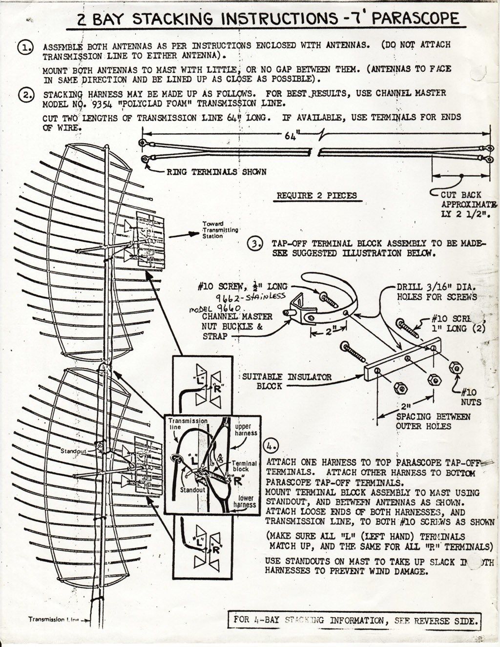

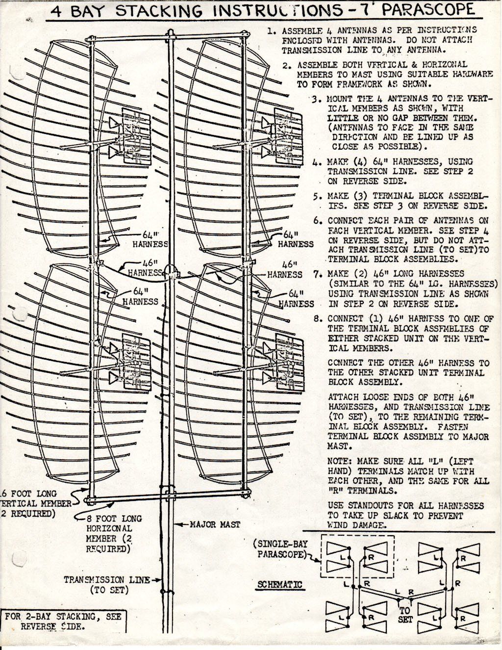

What is everyones opinion on the attached info. The signal of the dipoles are not 300 ohms
If you can find 2 or 4 of those antennas, it'll work fine.
I would not draw any other conclusions from those directions.
And you will need an industrial strength tower upon which to mount them.
One of those 8 ft parabolic reflectors gets you about +19dB gain so 4 will probably net around +27 dB.
For the effort and cost, they are not worth it.
