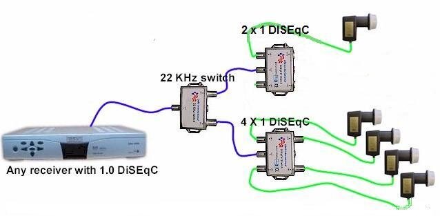

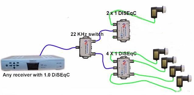

Gary Z SatelliteGuys Pro Original poster Jun 27, 2005 942 0 Seguin, Texas Oct 3, 2006 #4 Would something like this work? Attachments 5lnb.JPG 20.7 KB · Views: 217
gabshere SatelliteGuys Pro Aug 20, 2006 3,720 21 Rison , Arkansas Oct 3, 2006 #5 you could do away with the 2X1 Diseqc switch and hook 2 lnbs to the 22k and then to the 4Xdiseqc and other 3 lnb's to the 4Xdiseqc then to the receiver

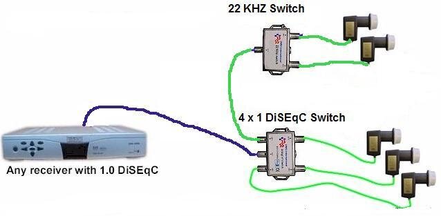

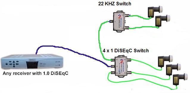

Gary Z SatelliteGuys Pro Original poster Jun 27, 2005 942 0 Seguin, Texas Oct 3, 2006 #7 Is this what you mean? Attachments 5lnba.JPG 19.8 KB · Views: 202
M Mr Tony SatelliteGuys Pro Supporting Founder Nov 17, 2003 3,644 15,898 Mankato, MN Oct 3, 2006 #8 yes 4 way diseqc and on one output put a 22k switch LNB's on those cant be universal...the other 3 ports can be
Gary Z SatelliteGuys Pro Original poster Jun 27, 2005 942 0 Seguin, Texas Oct 3, 2006 #9 Thank you for all your help Larry, gabshere, MikeI and Ice! :
iafirebuff SatelliteGuys Pro Feb 10, 2006 4,394 8 Waterloo, Iowa Oct 3, 2006 #10 It works like a charm!
