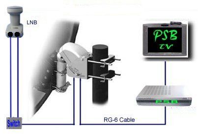

hmm i have my switch before the motor. you mean it works after the motor? let me see. i have the disc switch after the motor. ok let me think i have the lnb connected to the moter then to the disq switch. wow confusing. Is that right?
ultravox said:
anyone have a diagram? or pic? for some reason its confusing me.
I have been meaning to do one for a while now, thanks for the motivation :)
