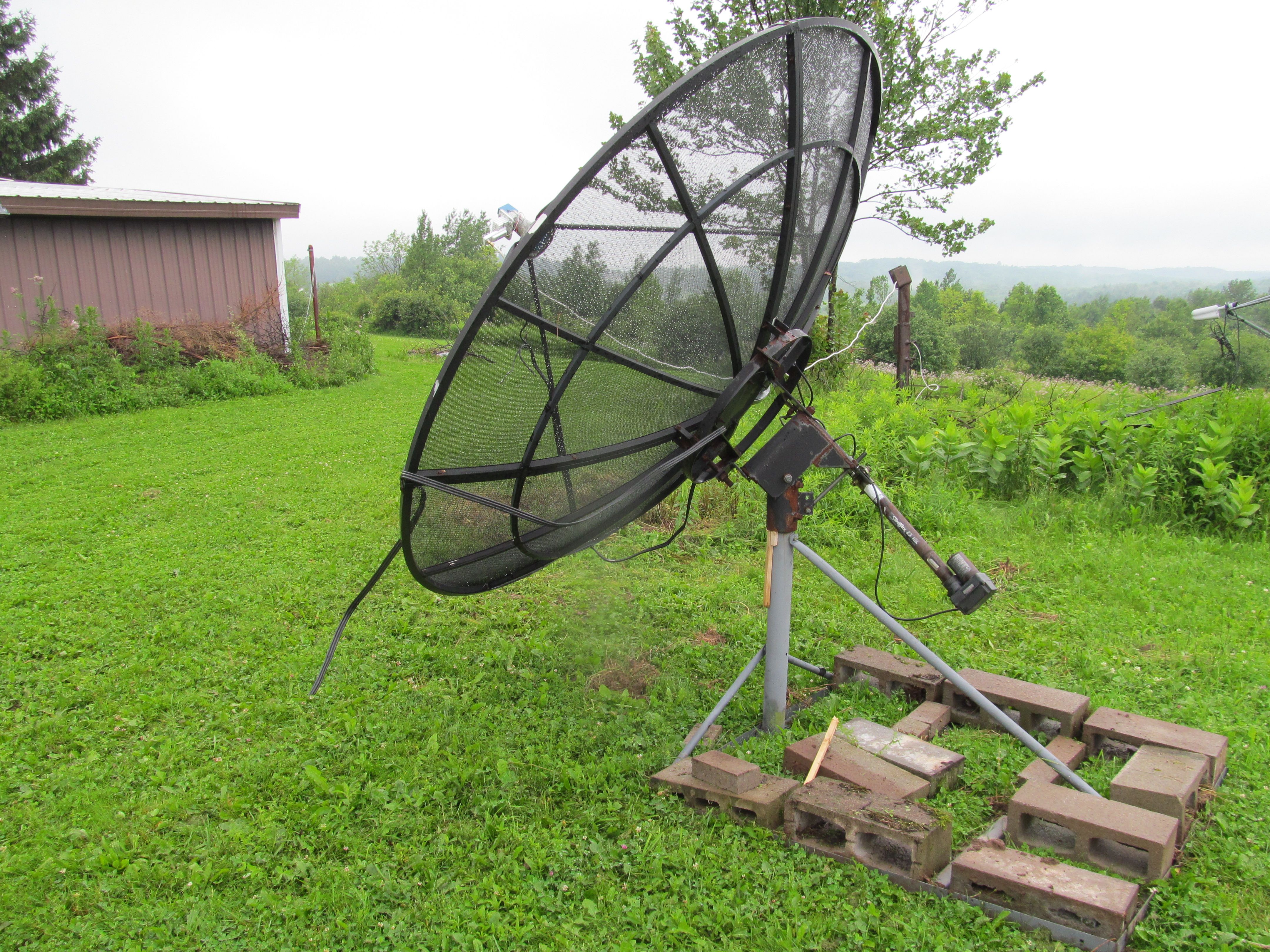

I have an 8' C band dish I that needs a 4" poll BUT only have a 3" roof mount thing. Looks like a pallet so I don't have to put holes in the roof.
It is on the mount that sits on the ground now BUT need a better way to convert it?

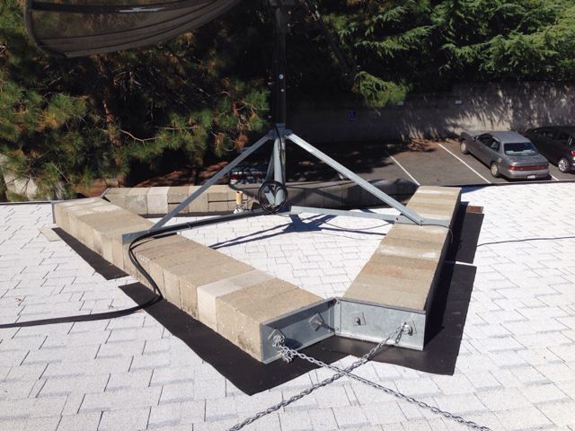

This is the size of NPM base and approximate concrete block ballast for a 8' dish. I might consider making a full height sleeve if the base and ballast were appropriate, but topping with a 4" adapter is pushing fate. Tremendous wind load on this large reflector. Also advised to install safety lines.

Yep! The building engineer confirmed the load before I hired the crane. We do have an occasional snow up here in the Sierra foothills, so the roofs are engineered better than down in the central valley. :)

Think that NPRM is meant for a max of a 1.2 meter offset dish. Way too small to reliably hold a BUD in the air.
I'd want it, at least, doubled in area. Take a look at a cement NPRM

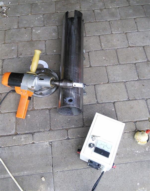

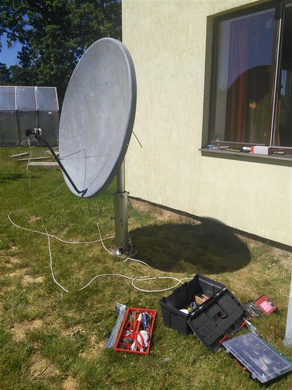

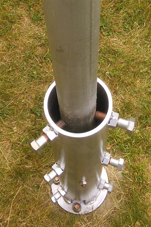

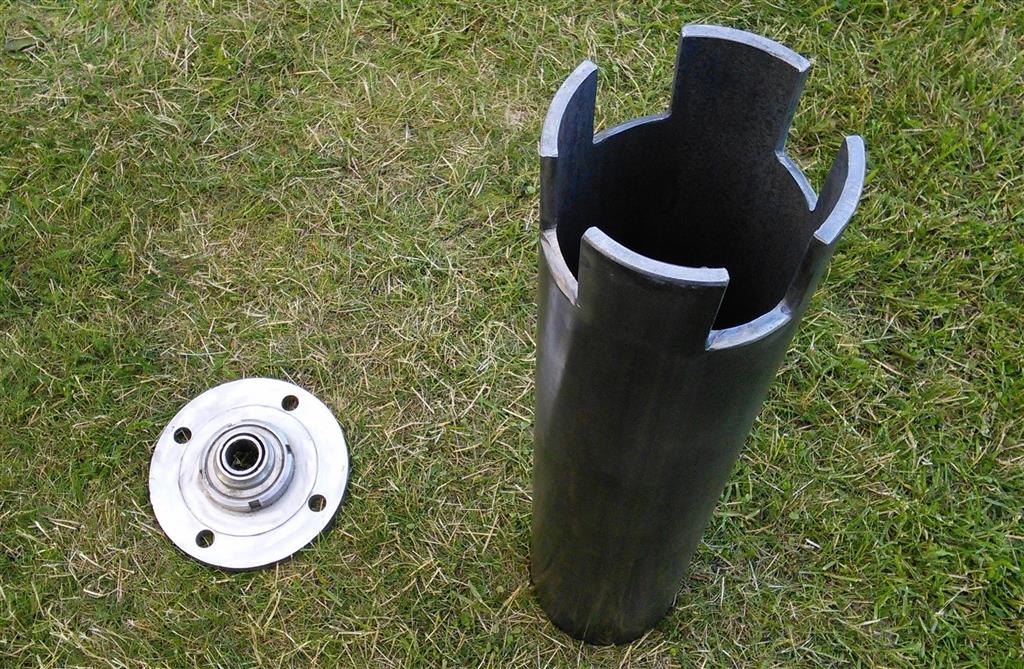

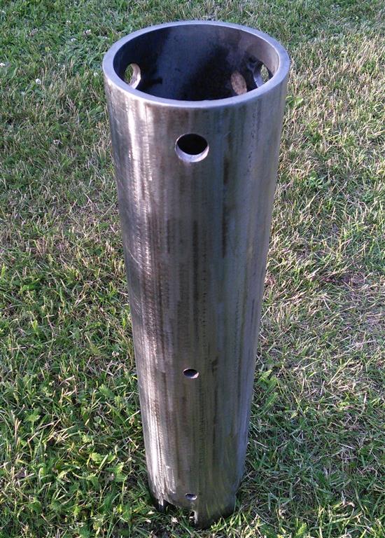

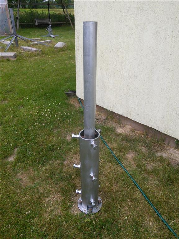

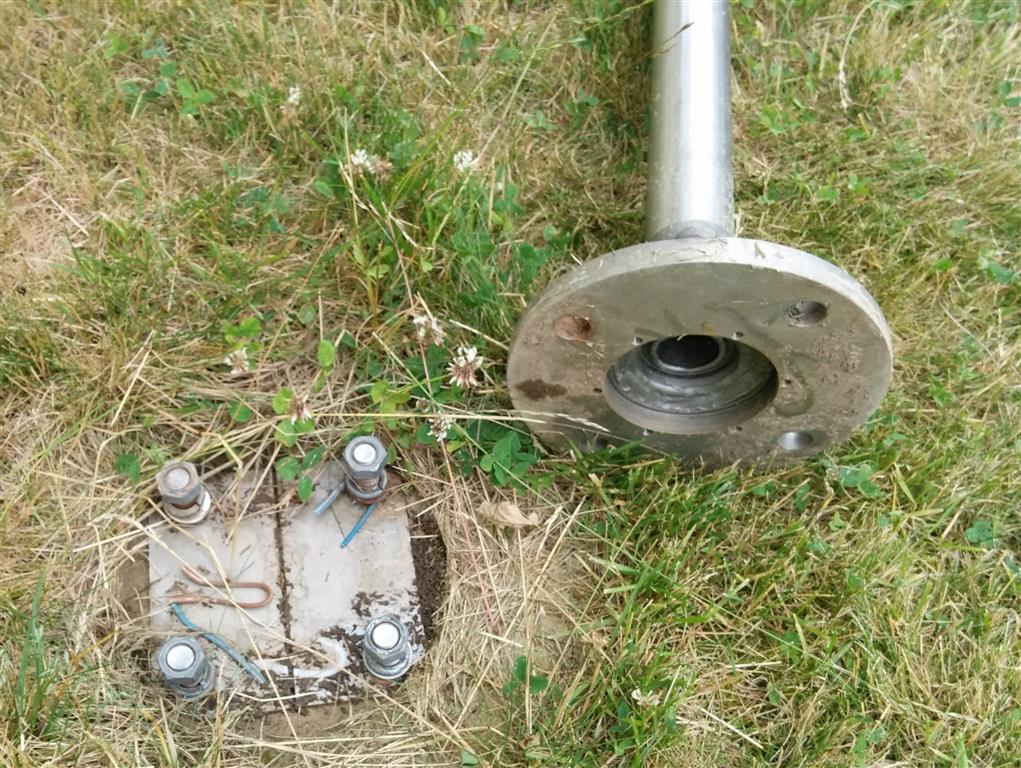

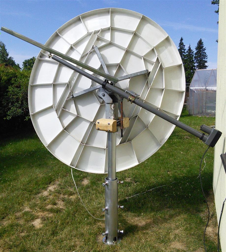

I've just recently made adapter out of 125mm (inner diameter) x 8mm wall thickness pipe. Drilled 9 x 20mm holes and welded 9 x 20mm nuts to it. So, pipe is connected to concreted infrastructure in the ground. I can put inside of this adapter any pipe up to 125mm and also make it plumb. I also have ground stand with 100mm pipe on which I had 1,8m Prodelin mounted. Right now I have installed 1,4m plastic dish on my test-bench.
IMG_20150625_183900 (Large).jpg IMG_20150626_193042 (Large).jpg IMG_20150627_174935 (Large).jpg IMG_20150627_195949 (Large).jpg IMG_20150701_084818 (Large).jpg IMG_20150701_084848 (Large).jpg IMG_20150701_125422 (Large).jpg IMG_20150701_132216 (Large).jpg IMG_20150701_125457 (Large).jpg

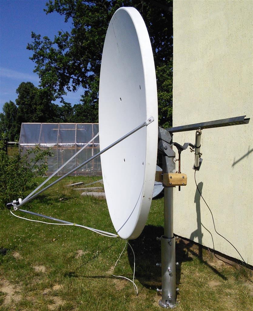

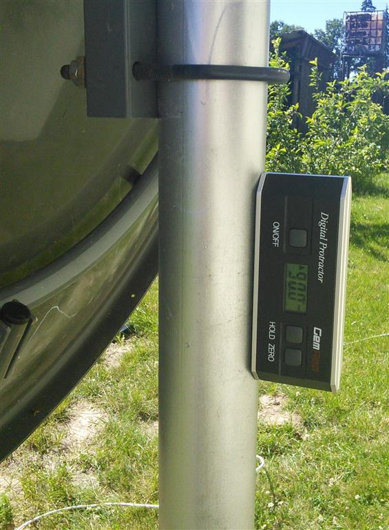

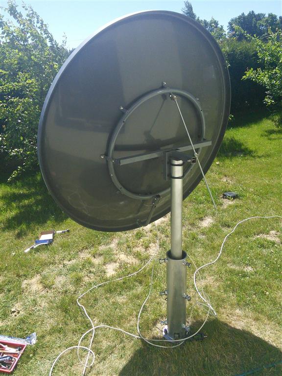

To install bigger antenna on the same ground stand I just replaced inner pipe. Now there is 89mm pipe and 1,8m plastic motorized dish on top of it.

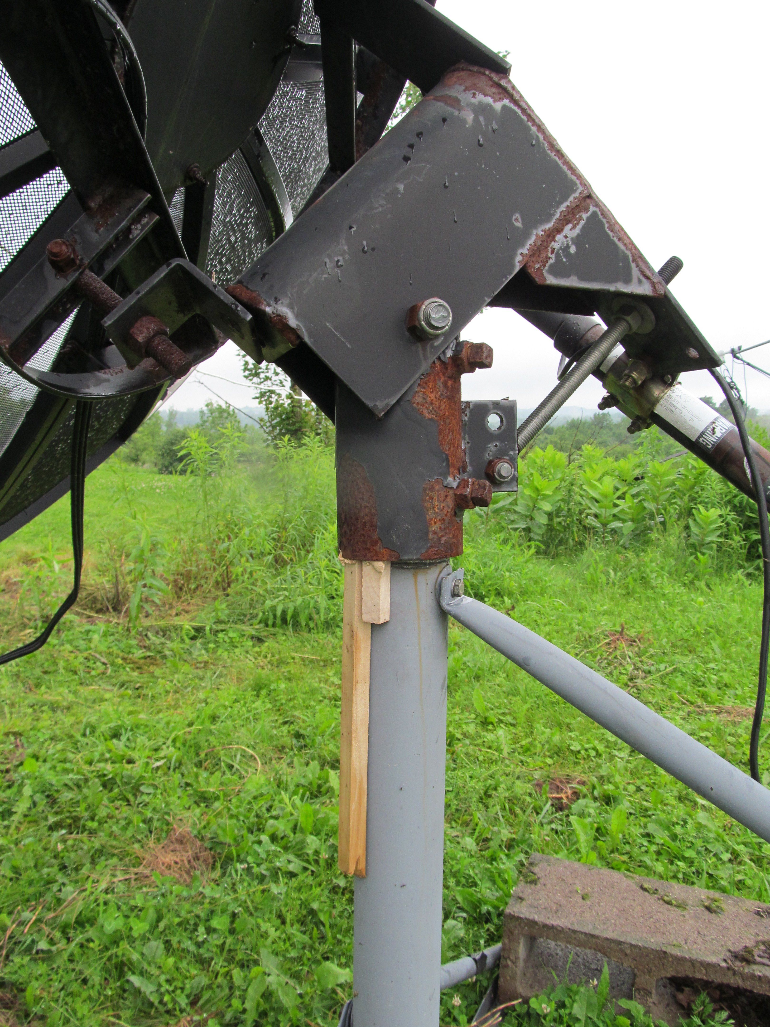

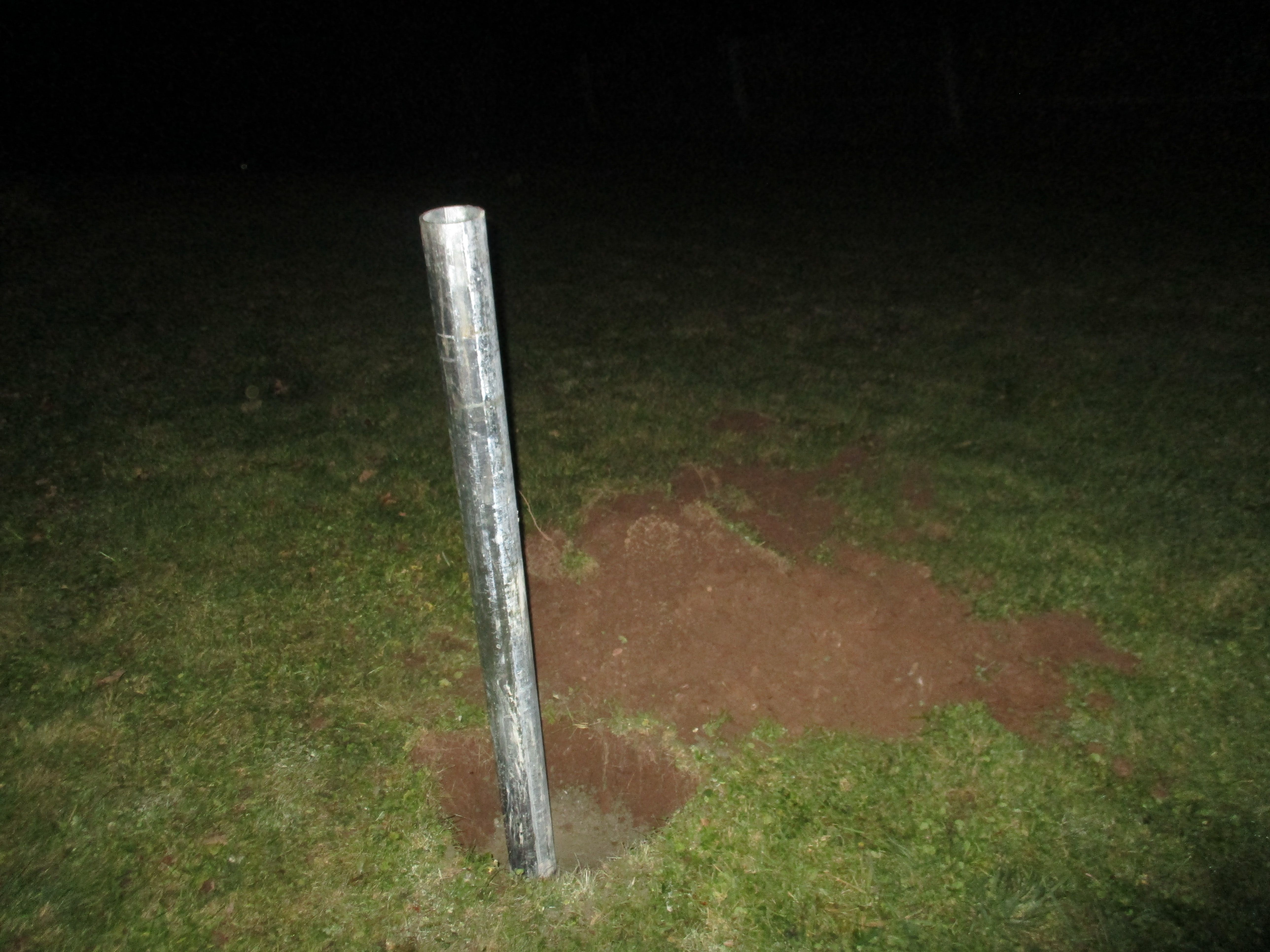

Lets back the boot up a min.
It was a 3.5' post I need and i think the mount was 2.5" or 3" I get back to you on that.
Well it kinda of a pain so I put a 3.5" inch X 6' pipe in
2.5' hole
80 lb of cement with 3/8" X 12" rod to keep it from turning
It is setting up now

Something else I didn't notice early this morning : Is 30" below frost line for Central NY State?
I believe I would pull it up with a front-end loader once the concrete has set,dig out some more,and re-set it in more 'crete. (Wash the previous concrete of good first.I THINK the 2 concretes would bond ok then)Only 80 lbs of concrete should pop out easily.
Not news you want to hear,I'm sure,but easier to fix now than later.;)
2.5' hole
