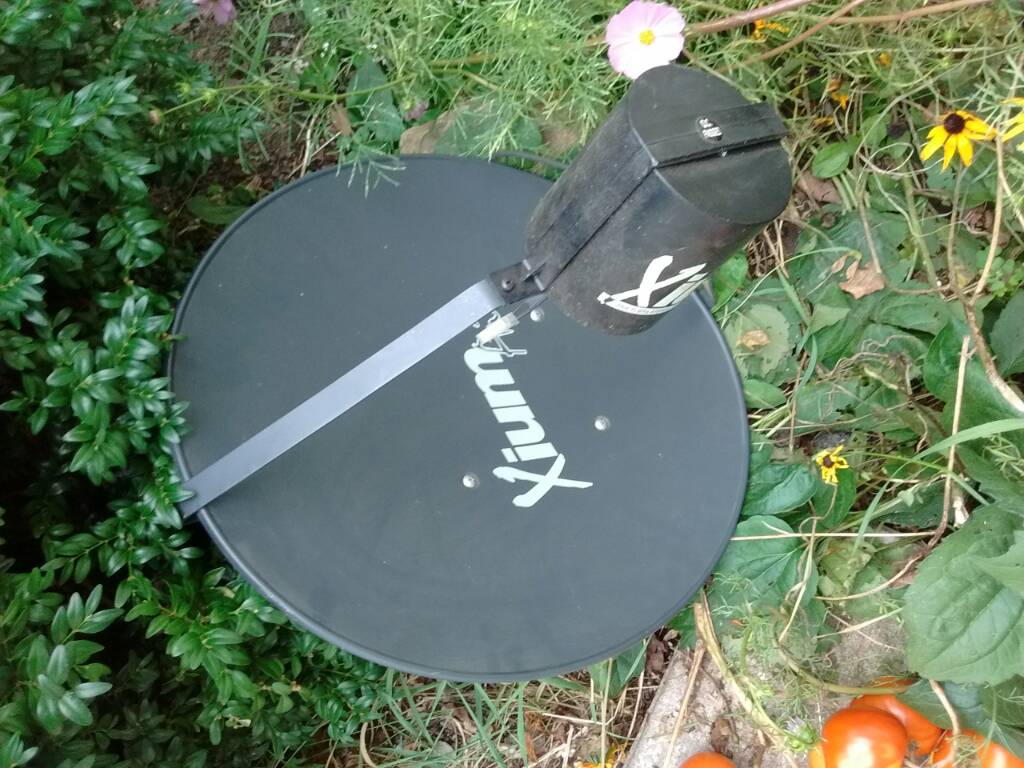

Found one of theses antennas xium antenna "dish looking"
xium dish looking one
About 20"
Sent from my XT1526 using the SatelliteGuys app!

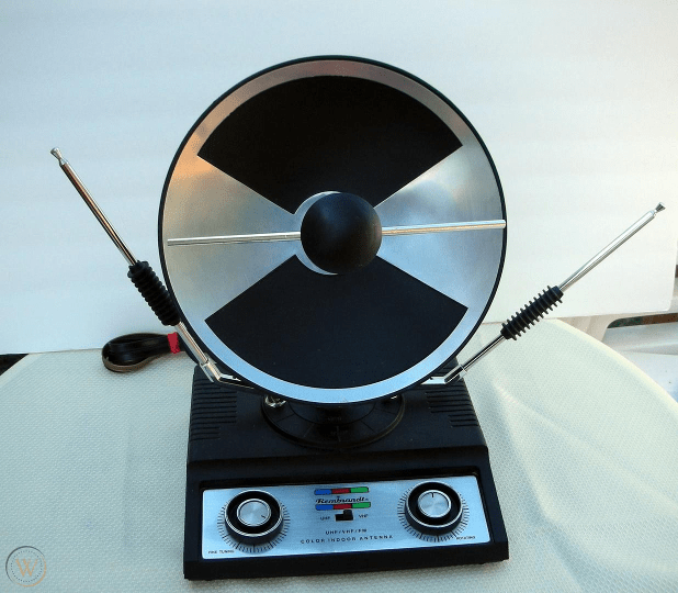

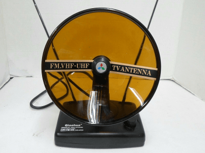

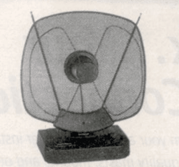

While not the specific one that I was thinking of (it had kind of a Death Star pattern of raised bumps), here are some other examples.
I'm not sure what these are supposed to represent. It looks like they outfitted the dish with divining rods to make some sort of dipole.

These dish looking indoor antennas are a joke. They are not dishes, just toys that make some people think they have secret sauce. Give up on the satellite dish idea, I suggest a conventional aluminum outdoor antenna with decent gain.
