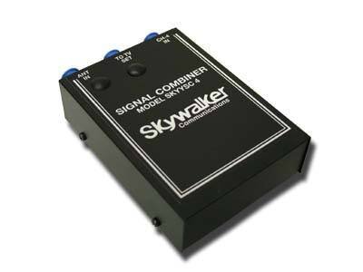

If I'm understanding your question, I think you could use a signal combiner, such as a channel 3 or channel 4 combiner. For instance, if the VCR you want to see through your system can output on channel 4, you could combine that ch 4 signal with your ota antenna. The combiner has filters to prevent interference to the existing ch. 3 signal if there is one. If you don't have a ch. 3 or 4 OTA in your area you could use two (one of each) to inject a ch. 3 & ch 4 signal into your OTA antenna coax. In my case I send the FTA satellite signal through my house coax on channel 4. We have an OTA ch.3. They don't interfere with each other. On ebay I was the only bidder on a box of them so I ended up with 15 of them for less than $20. Guess what I'm giving as Christmas gifts this year!

Would a signal combiner work in front of the fta reciever's ota in port, brining vcr signal from upstairs in as well as real ota channels from the antenna? If so, one of those would be fine. Would a 4 or 3 channel one be better? 4 is dvd player at the moment in living room and 3 is fta receiver + vcr in living room. I want, if possible for signal from vcr upstairs to be seen on living room tv... I'm guessing a channel 4 combiner would be best since we don't have the dvd player on at all times, and it'd cause vcr signal from upstairs to act with dvd player's signal the same as vcr in living room is acting with fta receiver signal at the moment where you push play on vcr and see vcr hit power off on vcr and you see the fta receiver's signal?
See attachements... which type would be better? I'm thinking the combiner type from skywalker or whoever, but want to make sure from you all first before I do any ebaying or anything...

Thanks. I'll be off to ebay tonight. :)

Hey, Techpuppy, thanks a ton. I just got a box off of ebay for cheap too! :) Got about 15 coming my way. Not bad for a little under 20.00.
