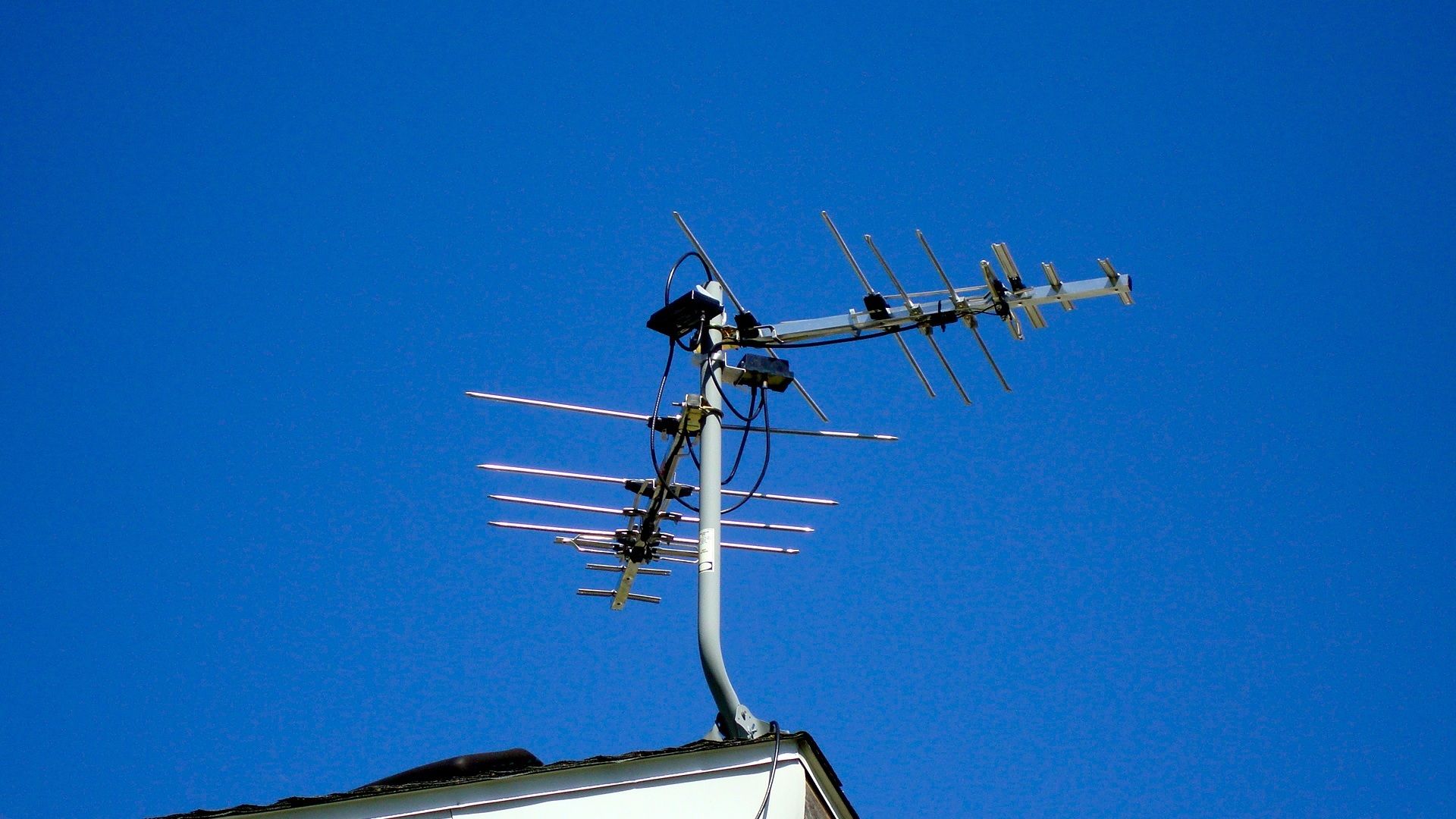

two antennas combined:
Here's my setup ... lots of people have said this can't possibly work, but yet it does:
The preamp is on the top, the upper antenna is pointed toward the Toledo antenna farm. Next is the combiner, and the lower antenna is pointed toward Detroit. The farthest stations' towers are ~50 miles away and signals come in reliably 99% of the time.
All on a four-foot pole, 20 feet off the ground.
Thats a nice setup.And since they are not really over lapping each other except at the reflector,I'm sure it works great. I think what needs to be put out here is..the best way to combine 2 antennas is to amplify first,then combine. This looks like what you have done here,and it's failrly high and looks to be in the clear. I guess I was talking more about stacking twin antennas and other larger antennas Enjoyed the pic!!
Thanks. The guy who sold that to me told me that people need to forget the old analog days. Digital TV is much more tolerant of interference than analog was.
Exactly the opposite is true, a ghost on analog TV translates to multi-path on digital TV and often it kills the picture totally.
Digital has a superior picture as long as the signal is clean and strong enough to be decoded - otherwise you get nothing.
