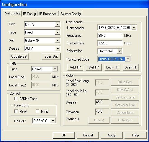

Anyway, attached is an example of the DVBW config screen to illustrate what has to be done.
