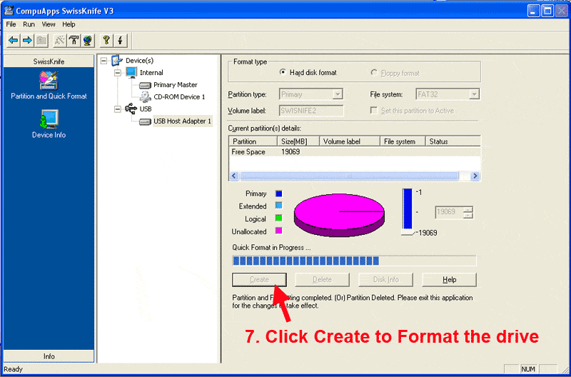

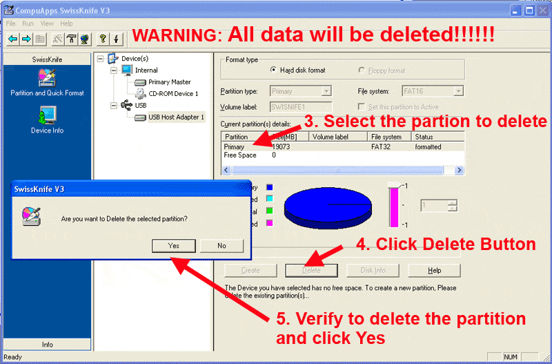

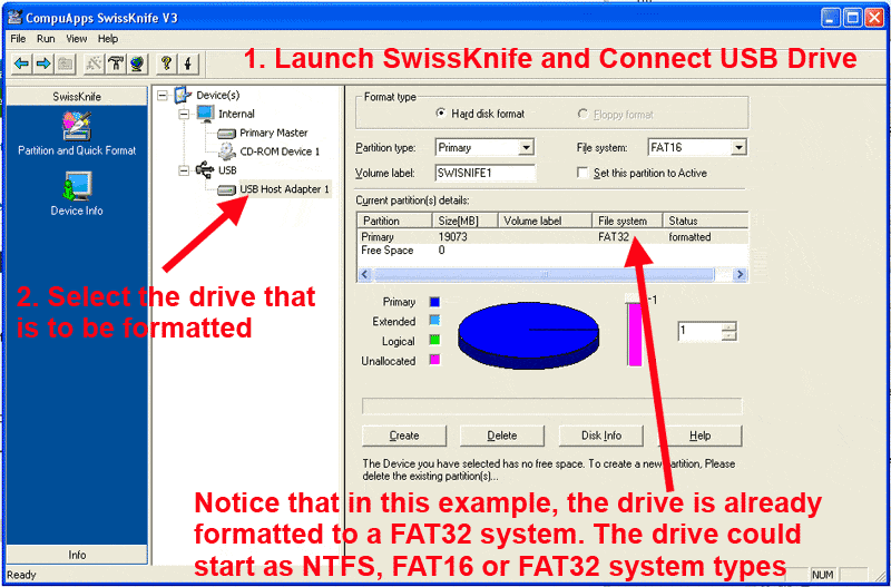

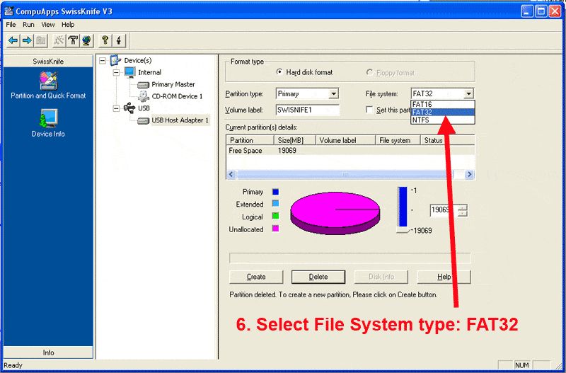

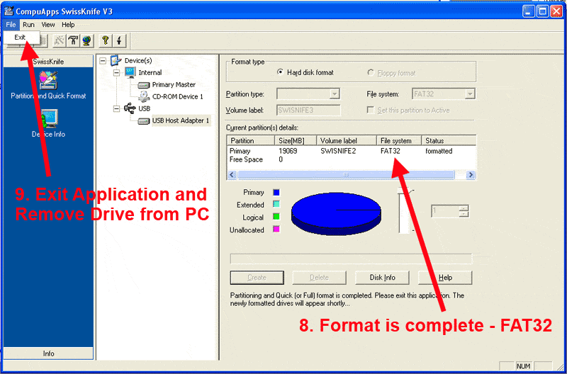

How to Format a Drive to FAT32 using SwissKnife
Version 3.0
Be sure to format any drive prior to recording.
Warning: All data will be erased and all recordings will be lost.
Always format a drive a second time with the USB Format menu function in the GEOSATpro DVR1100c receiver
