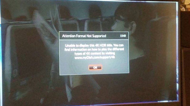

Why are so many people chasing hardware issues when it is quite clear this is Dish software blocking?
Even my 1080 tv wants to play the 4kHDR recording from H3 dvr but has a Dish software error-message block.
Yes, I think if it was hardware / HDCP issues those of us on non-HDR units wouldn't get any signal. You're getting picture on a 1080p, I'm getting picture on a 4k (non-hdr). The only thing stopping from watching is the alert which is done by software.
If this was a restriction due to HDCP issues of the newest version I'd expect we'd get something more like this
filestream.ashx
My 1080 tv connect to H3,
wants to show the dvr'd 4kHDR program,
Somehow down converted?
by either 1080tv or H3?
Shows program behind grey window and error message tile.
Error message forced by dish software on otherwise playable content.
It is quite possible that Hopper is capable of downconverting this channel to HD, but Dish has chosen not to allow that. I can see several possible reasons for that:
1. Licensing restrictions from NBC.
2. The downconversion is not working too well (e.g. wrong color space)
3. They want to avoid support calls from customers who would get the channel in HD, but not in 4K HDR as advertised.
Anyway, the purpose of this particular thread is to explain how to get the video in 4K HDR, not to speculate why things were implemented one way, not the other. We have other threads discussing that already. Let's not derail this one.
