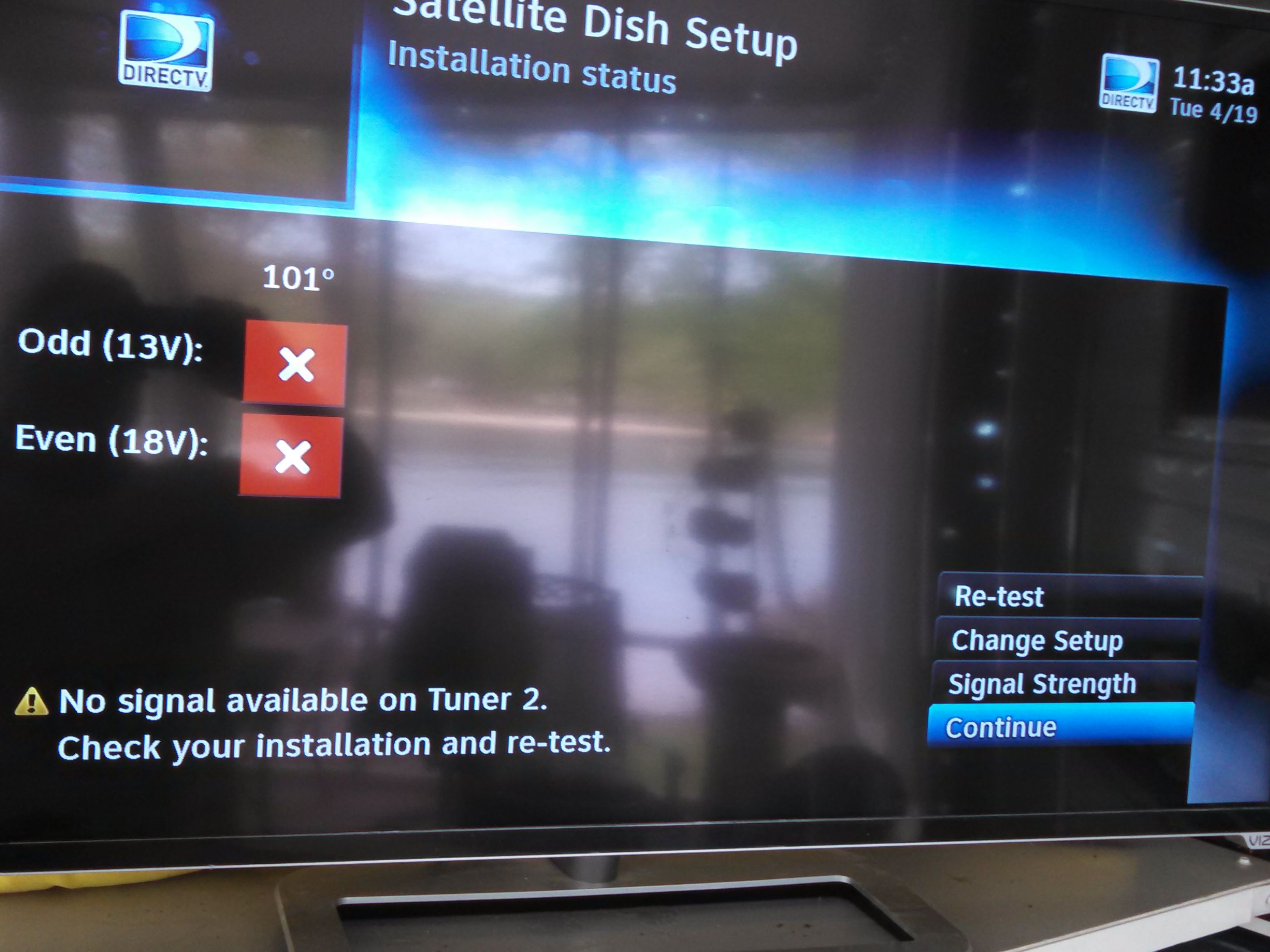

I swapped the cables, went through the setup each time with same results, "No signal available on tuner 2" , I attached a photo of the screen below.

When you check the signals on all the transponders on tuner 2, are they actually zero?
Are you sure you are pointed at tthe right satellite? Can you actually watch programming?
Can you post pictures of the signal levels on Tuner 1 and Tuner 2, please? Also, what happens if, while watching normal programming, you press the down arrow? Does this start the double play feature? Do you get an error message? If you press the record button while watching a program, then try to change channels, what happens? Message?
Well, at some point one of the fixes fixed the problem. I am now recording 2 programs at one time. I had not checked it after the last couple of changes because it still says "no signal on tuner 2". But it is working.
I really appreciate all the help. You guys are great. Thanks so much.
