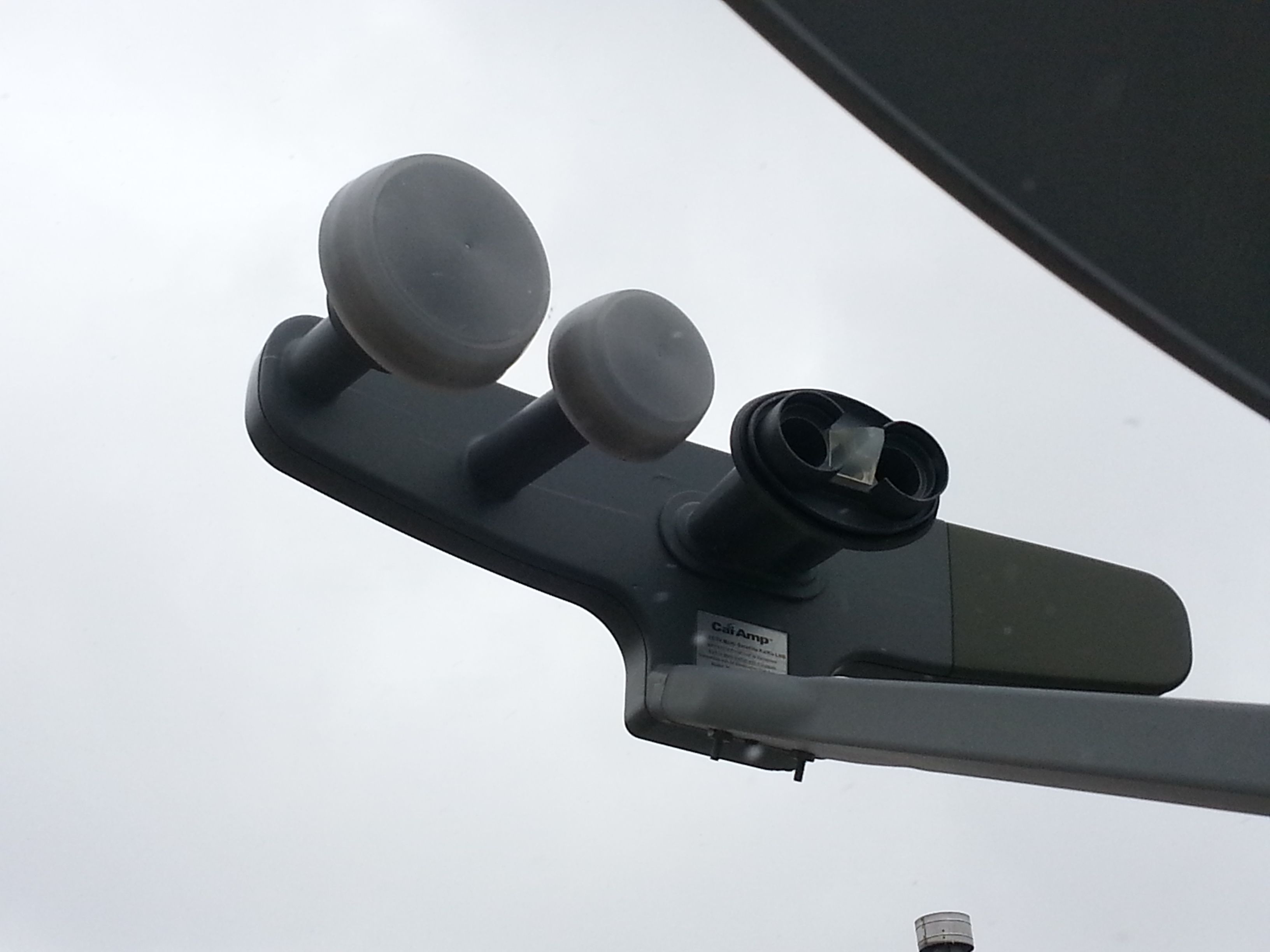

I was watching Directv Saturday night in HD when I changed channels and got a 771 error message. I still had SD channels, so I was a bit puzzled. Sunday morning had no change so I went to look at the dish. I found that the plastic cap on the 99-103 part of the lnb had broken off. I was able to get a replacement lnb, but when I installed it, I was still not able to get my HD channels (SD channels still come in though). Is it most likely that I have to realign my dish or might it be another problem? It's still cold where I live, so I'm hoping to have things fixed by midweek when the temperature warms up.

Is this the Same LNB you had on I t ?
try running the Repeat Sat Set Up.

can you post your satellite signal levels for the 101, 99 (ca,cb), and 103 (ca,cb)? its probably an alignment issue, but knowing those would help.

The 99 and 103 Sats are where you get your HD channels from, therefore, your probably out of alignment or have a bad LNB, these would be where I would start.
do you have any signals on the 119 sat in the 90's as well? if so i find it dubious that the satellite alignment is off by SO much that you have all zeros on the 99/103 and not at least some non-zero reading. possibly LNB like jimbo said.
