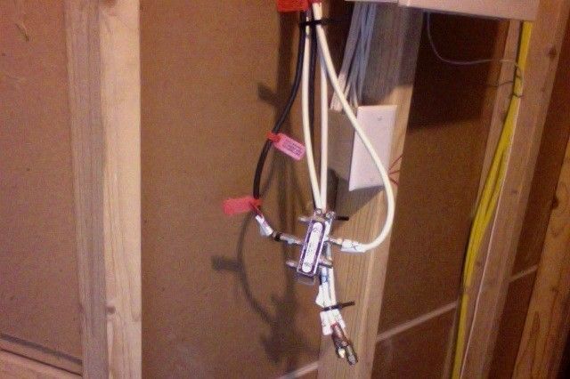

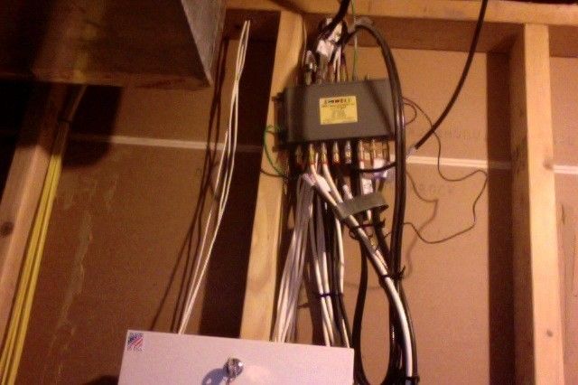

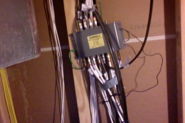

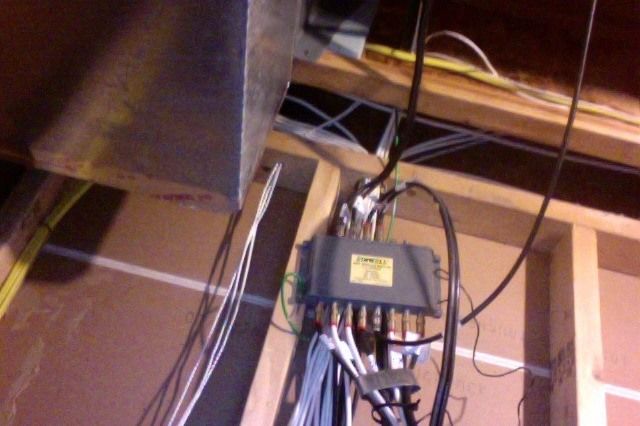

This is to clear some things up. MODEL: H25NC-500. I purchased it from a private company and DirecTV has confirmed I do own it. NOW, for the photos. This gives you a taste of the wiring involved. There are 7 bedroom coaxial outlets (all aren't in use and don't fit the switch), 4 or 5 various coaxial outlets in the house. Coaxial going up some pipe from the basement into the attik out to the dish. It's a mess. And then Comcast Internet came and added the red tags. Sorry the pics are really out of focus, camera was dead, webcam built into computer isn't great.

the H25 wont work with your setup. That is the older setup and you need a SWM setup which is one line from the LNB into a splitter then out to the receivers
You will need to get a swm type lnb, the kind that has one output on it. You can use the same dish. You will also need a power inserter. Or you could do like royrdsjr posted and get a swm type multiswitch instead of the swm lnb. It sounds like you don't have any experience in setting up a satellite system. I would recommend contacting a local installation company if you aren't comfortable doing this yourself.
