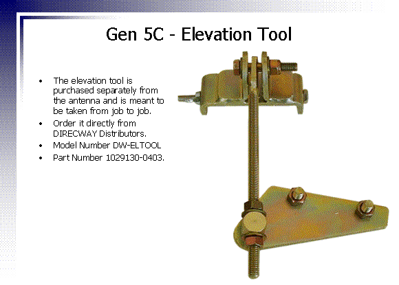

HughesNet is currently rolling back their systems, starting in mid Feb they are going to have their installers start installing KU band 7000s systems. I have installed a few 7000 systems and well over a 1000 9000 systems. The biggest reason for installation purposes I like the 9k better is the fine tuner adjustments that take up the weight of the dish for pointing. I salvaged part of a fine tuner off a 2 watt commercial system I upgraded, but it does not fit on the current model 7000 AZ/EL mounts. Does anyone know where I can purchase one of the elevation brackets that I can use to aid in the pointing process? I can only find 2 online retailers that carry and they are both sold out. Any help would be greatly appreciated.

This one?
//greg//
Perfect-10...
You don't really need one.. You can step the dish down to fine tune the elevation. Start off 1 degree higher, lock elevation on both sides and peak.. Then loosen the right elevation bolt and watch the signal get higher and lock it down. Next loosen the left bolt and watch your signal... Keep doing this until you peak it out. Obviously they have that tool for a reason, but this work fairly well also.

Yes, Greg that is the one I am looking for. I have found a few websites that sell one that works with the DW series the one for the HN series metal dishes are sold out. The one in the picture looks like the one I am looking for. Would you mind posting the link to where you found that photo?

I think I may have one of those still in my toolbox... I'll check tomorrow when I get home from work and if so, I'll let you know.
I haven't used it for years, but I think I still have it

you have a PM
I found mine, but it is missing the top bolt, but I used to just use a screwdriver, should be easy to find a replacement
Thank you Greg, I had most of those but there was one that I didnt and it looks like they have it in stock. I appreciate your help.
