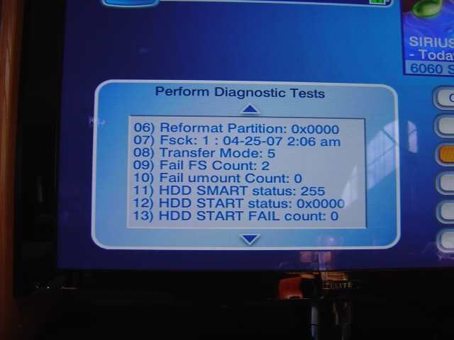

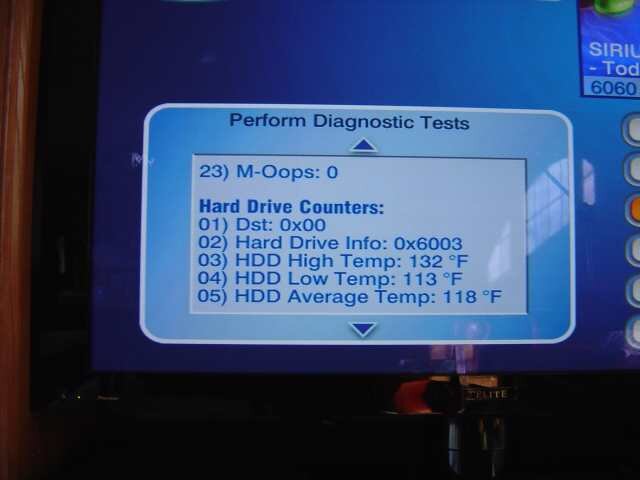

Here we go from the diagnostic screen:
Dst: 0X00
Hard drive info: 0x6003
HDD High temp: 132
Hdd Low temp: 113
HDD ave. temp: 118
reformat partition: 0x000
Fsck: 1: 04-25-07 2:06 AM
Transfer mode: 5
Fail FS count: 2
Fail unmount count: 0
HDD smart status: 255
HDD start status: 0x0000
HDD start fail count: 0
I do not see a reman. sticker on it.

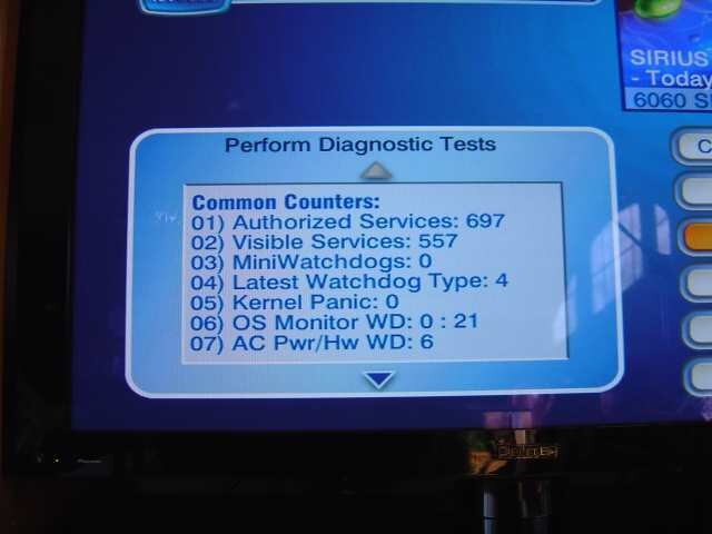

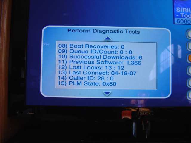

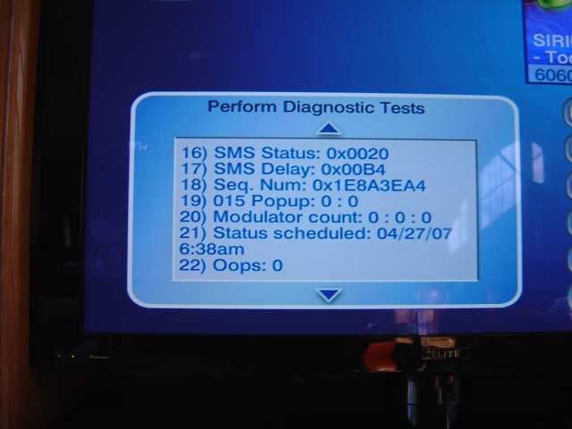

here are the diagnostic screens. click to enlarge.
SMART STATUS should be zero - you have a bad hard drive.
He MAY have a bad drive. Actually 2 hits on smart status is not very significant. It would be nice to know what the 255 code meant. But the normal process is to run a more extensive test if you start getting some Smart codes. I believe that the drives used was Maxtor's and so they recommend running their POWERMAX. Trouble is there is now no way to run it on this drive.
Trouble is there is now way to run it on this drive.
Exactly, which means ship it back to Dish and let them do it since they do not provide a way to correct for possible "correctable" errors. The only good status for Dish DVR's is 0.
Until Dish builds drive analysis and repair into the receiver, he is still out of luck and the error code still indicates a bad drive - whether it is the electronics, the platters, or the data sectors.
For the right error code, one hit on SMART is catastrophic.

Your HDD SMART Status should be 0. Looks like you have a bad hard drive. This is what is causing all your problems. ...
Thanks again. Dish is sending a replacement :)
