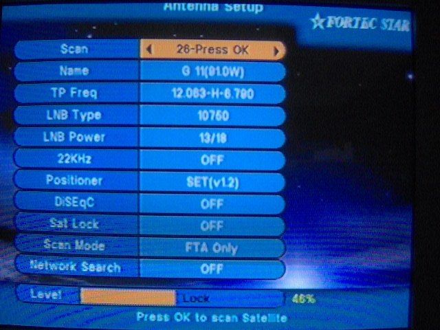

Hey Ice, is he using a Fortec receiver? I know my Fortec NA came from the factory set for a universal lnbf...I am assuming that he has it set for the standard lnbf in the antenna set up. My concern was that he said he wasn't getting much signal on 121wl (which is very strong) and that if the tree is filtering that much signal on 121 G10 may be out of the question. I had the same problem so I moved the dish and now I get an awesome signal on g10.

You have it on 10750, right? See the attached picture. It's a different satellite than G10 but it should be setup as such
Scan
Name-G10RK
TP Freq-11800 V 26657
LNB Type-10750
LNB Power-13/18
22K-Off
Positioner-Off (in my picture I was using a motor)
Diseqc-Off
Sat lock-off
Scan Mosde-ALL
Network search-Off
