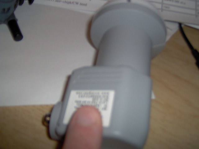

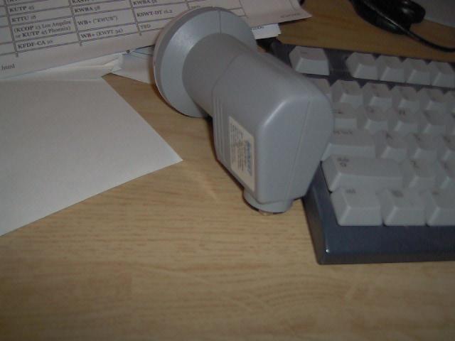

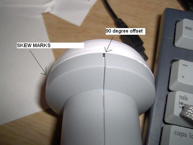

Here is a stupid question. The LNB you have. I now the plastic around it you can crack open (its 2 pieces). Are the skew lines lined up with the crack (the 0 spot is even eith the split) or is it on the side?
Here is something weird....I have a LNB that shows the skew lines on the top of the LNB and the "split" of the plastic pieces 90 degress off(on the side). I tried and couldnt get it to work. I turned it 90 degrees (to line the crack up with 0 THEN skewed it from there and it worked). I'm not saying this will work but I just am wondering (and giving out ideas).
Here's what I mean Larry
the skew marks were on the one side so I skewed from there and couldn't get anything. I turned it 90 degrees then skewed from there and it worked
2nd picture is how 0 skew should be
3rd picture is how 0 skew actually is
Its a long shot but worth a shot
