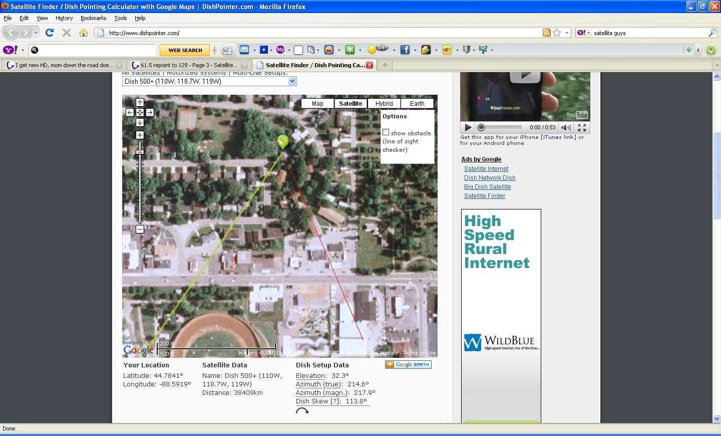

Before I start climbing up on her roof and changing these dishes and things I wanted to paint a better picture of Mom's situation. She has what appears to be two 500 dishes, her original dish pointing SW which wasn't HD, green in the pic. The other newer HD dish 500 is pointing SE represented by red line in the pic, this dish also has "DP PLUS" on it.
Her menu-6-1-3 screen has 119, 110, and 61.5. From what little bit I know about this, I want to repoint the 61.5 to the 129, correct? Are the linked instructions how to do so? Help a totally lost and confused son out, thanks, pfan. satellite situation.JPG
If you have 110, 119, and 129 on your Menu, 6, 1, 3, and you are satisfied with all your channels, then yes, re-aim her 61.5 to 129.
