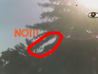

The satellite signal is more likely coming in to the left of the pine tree as indicated below. I marked it as the signal more likely coming in to the left of the dots in the space where the X is at.

How can you be so obtuse???
It quite obviously is in the upper right quadrant of the photo.

e0rbay said:
uhh... the signal isn't NOT coming from that x. if it's not coming from the area i circled, it would be from above it and slightly left.
If you are referencing my picture, you need to look closer. ;)

i am... and i see your big NO, and a marking in the upper right.
i just took a lazer pointer and set it on the lnb arm... it IS pointing where i circled.

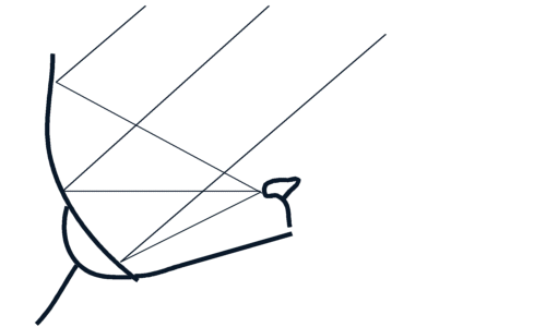

Now to be serious... you say you laid a laser pointer on the LNB arm and it points towards the hole in the trees. The dish looks at a point well above this elevation, as pointed out in an earlier post. Imagine looking at the dish from the side, draw an line from the lnb to the center of the reflector then off into space at an equal but opposite angle. That is where the dish is looking. The rough illistration attached should make it more clear. :)

That laser pointer will give you a azumith direction only, not the elevation of the satellite. The angle of the arm is not that of the satellite beam. (It helps to think of the satellite beam as a cylinder as big around as your dish, coming off the dish at the angle specified by your pointing screen) If the opening in the tree isn't at least as big as your dish, you're blocking signal.
If you can, take a picture from a point equa-distant from the tree and your dish, and the same distance from that point as it is between the tree and the dish. Take your favorite photo editing software and add a line angled at your elevation and attach one end on the dish. If it clears the tree in your picture, you should be golden.

thanks for that graphic though... that clears up a lot.
