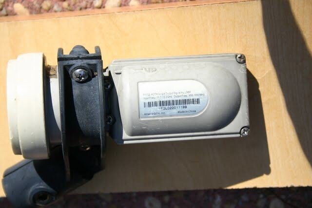

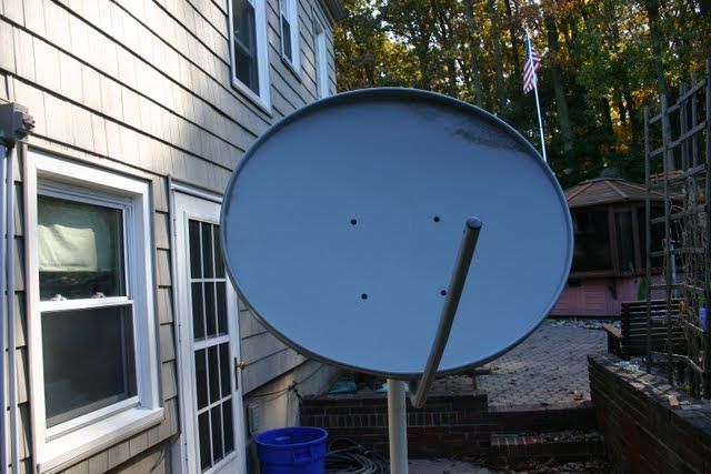

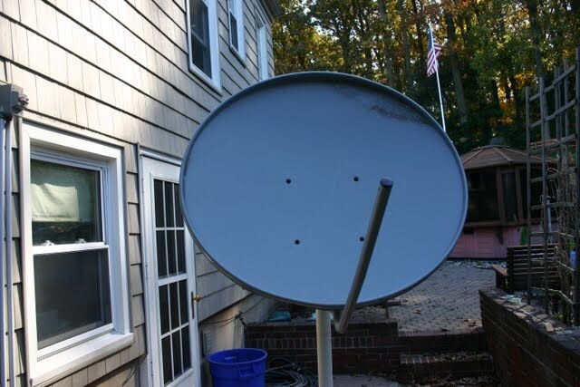

I'm looking to get started in FTA reception on the Ku Band sats. I already have a 90cm W x 80cm H (35"x31") dish and a LNBF – P1705 ADTH Single Output Digital - Input Freq.: 11.7 – 12.2GHz – Output Freq.: 950-1450 MHz that I found a few years ago in a neighbors' garbage pile. Does this look like a good starting point? (I hope that I uploaded the pictures correctly:confused:) Any suggestions for adding a motor to this dish?

tail wagging the dog?
The dish should be fine to get you going.
Search for happy users and more info.
The LNB seems fine, just off hand.
I didn't do any research, but what you posted sounds generic.
I like the receiver. If it's $50 delivered, and in excellent shape, I don't think you're going wrong.
If it needs factory firmware, here's how to restore it in this recent thread.
Most PBS reception will require a Dolby AC3 decoder.
That means a coax or fiber optical cable from the FTA receiver to a hi-fi amplifier with a suitable decoder.
...or use of an external decoder; search on Sonic Voom for info on this $20 accessory.
Motor? If you get one of these, just make sure the dish will fit the motor's output shaft.
Measurements are listed for each motor.
Larger shafts are for heavier dishes.
Good looking dish! I wouldn't use plastic pipe for it though-especially if you want to motorize it (after you move it to the location you want). The pole needs to be rock solid and as close to plumb as you can get it, to be able to track the satellite arc.
Anole - It's 50 + 15 shipping... I may see if it's still there and pull the trigger. Thanks for the info on the motors and the AC3 decoder. I'll start looking for these.
turbosat - that plastic pipe is temporary. Just want to get the dish off of the ground. When I bring it up to the barn, I'll put in a suitable metal mount!

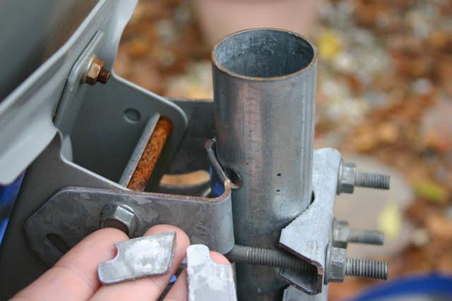

Got A Visionsat IV 200 now! Next is a motor!?!
Now I want to get a motor for the dish. But I think that I need a motor that has the tube facing 'UP' and not "DOWN' like the Powertech. There's a tab at the top of the dish mount that stops the support pipe when it's inserted from the bottom. If you look at the back of my dish you'll see what I mean.
http://www.satelliteguys.us/attachment.php?attachmentid=43581&d=1256567485
What do I do now?
Dennis

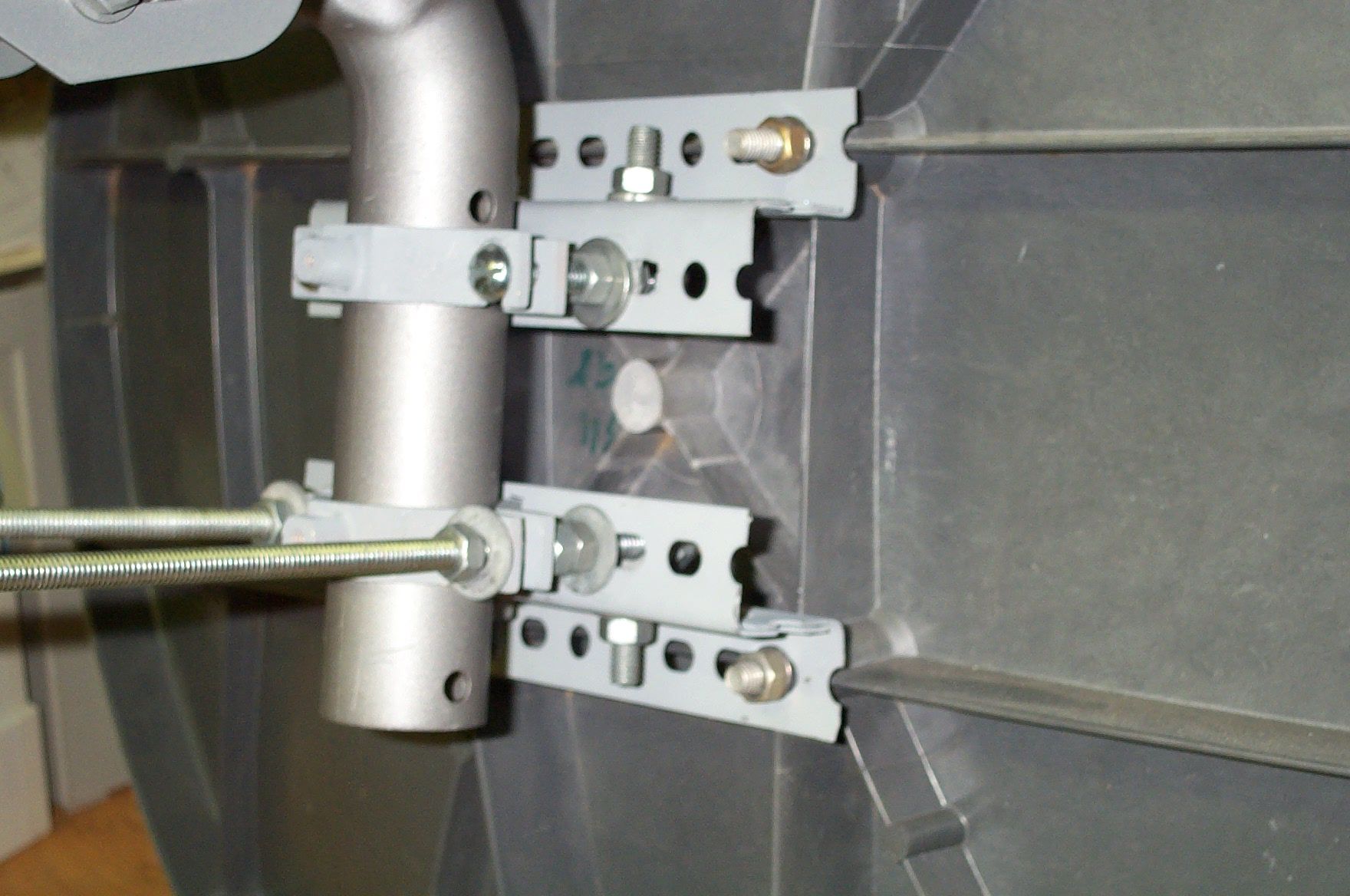

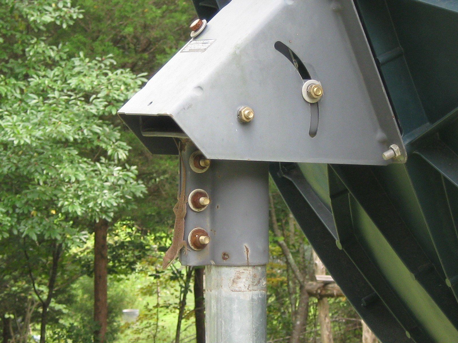

Well, you ask the anole!! (first pic) Here's the way one guy did it. I took a little different slant when I put my primestar dish on the 380, mostly the same except I used a big muffler clamp at the top of the tube, and a 2 1/2" conduit hanger at the bottom. That way there is room to adjust the dish elevation at the bottom of the motor shaft. Been working since April or so, no hiccups yet.

So, If I cut off the tabs I can use any motor that has the tube going DOWN? and not need to get a Stab HH-90, 100, 120? (makes sense to me, but what do I know)
Hopefully Anole will chime in here. In the meantime I'll start looking around here for more info.
Dennis
Wait... What if I take the mount off of the dish and flip it - if it's even possible? Would that mess anything up when setting up the angles?

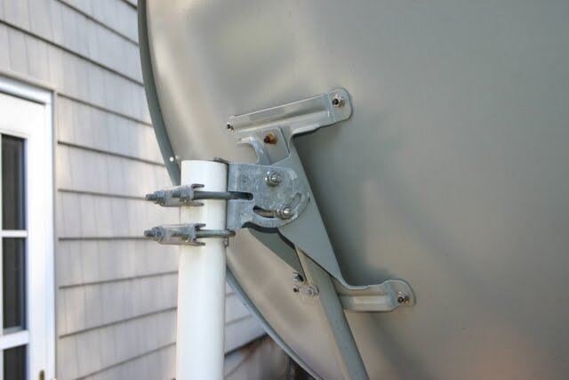

I cut the tabs off of the dish mount (just a few wiggles with pliers did the trick) and mounted it on a 1 5/8" pipe. Everything looks good so the next step is looking for a motor mount (and waiting for the Visionsat IV 200 to arrive). Which of the following would be a good choice? SG2100, SG6000 or DG280.
