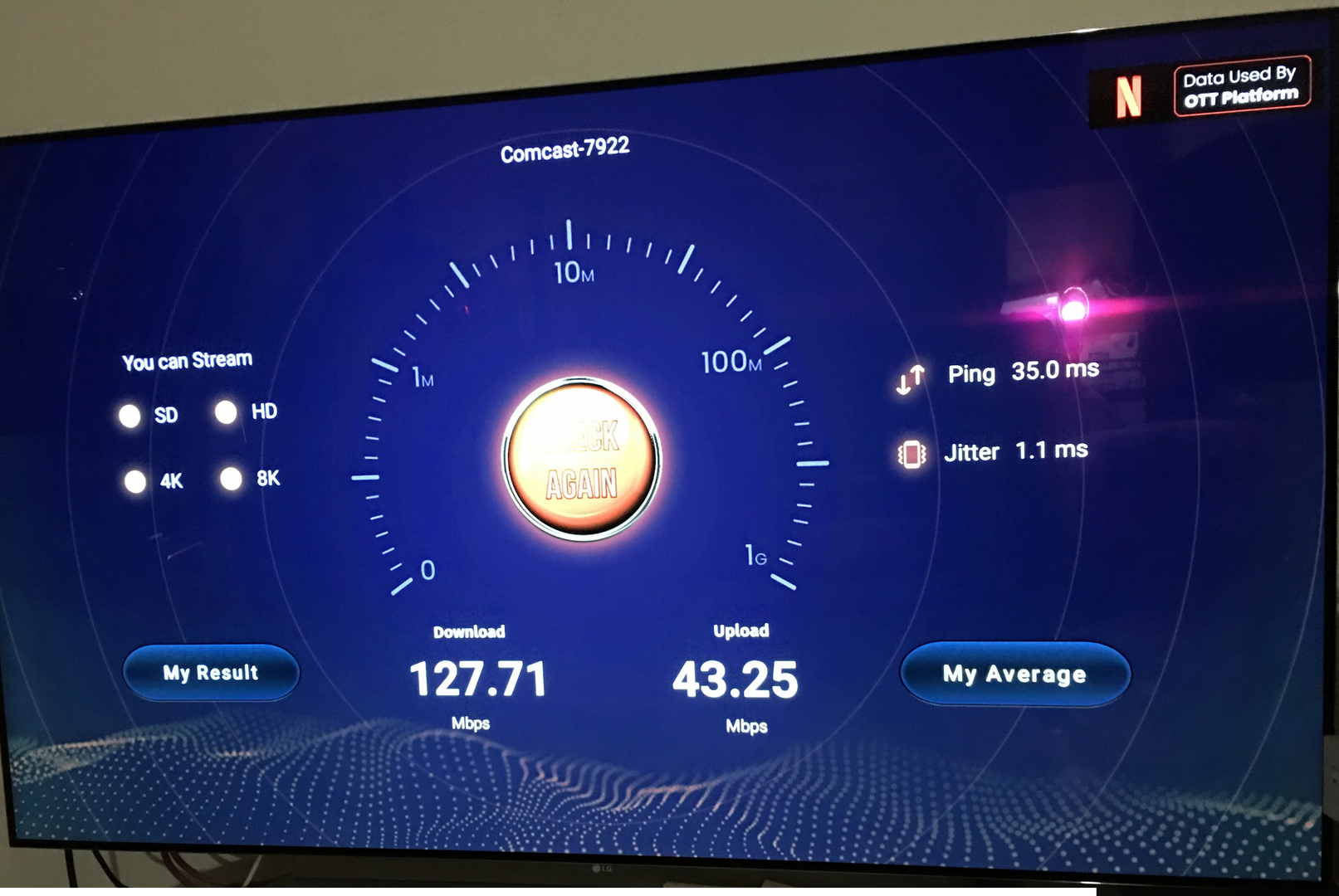

How do you find what the actual transfer rate is on the Hopper 3 as I thought it only showed signal strength? The only way I can show what speed it is by using a Speed Test Android App on the Hopper Plus which uses the Hopper 3's internet connection which shows 127.71Mbps down/43.25Mbps up as seen below.

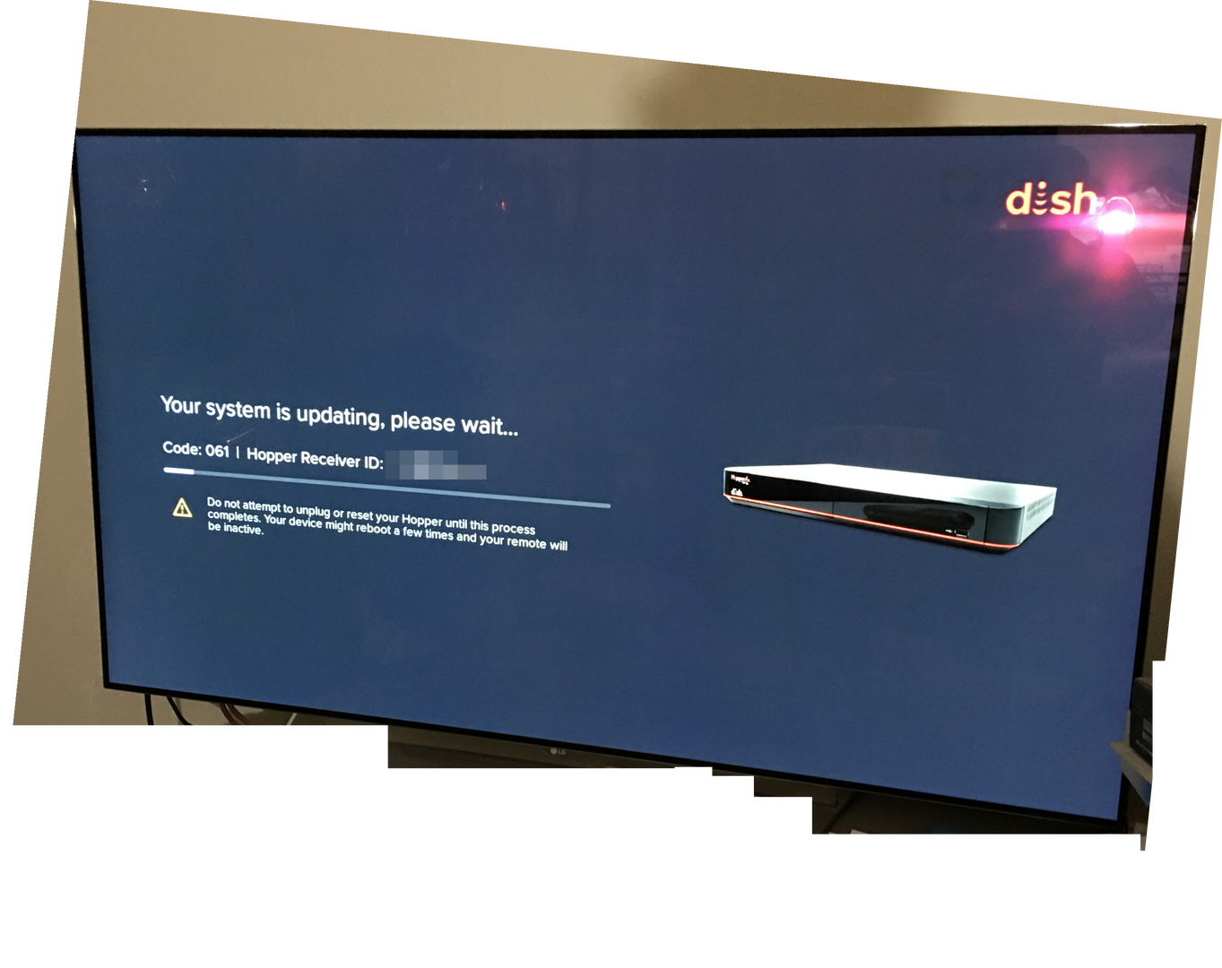

Just forced update to Hopper 3 with H378 from H376 with a Hopper Plus P12902 and didn't see what happened before the following screen is new, atleast it now shows the upgrade progress on a Hopper 3/Hopper Plus combo instead of in H376 when updating from H375 where instead of seeing the updating progress, there is no video at all and eventually, there is no video other than a black screen as if the TV was off. The Guide is available and hitting option on TV Activity will show I think 6 tuners in use, 1 and 6 says Available and 2-5 that says Software Updating but after idling, the video will be black again as if the TV was off. After some time, it will reboot and in the Diagnostics screen, Available Joey Software will only show the J and W versions and no longer the P versions needed for the Hopper Plus which is the same even if I manually rebooted again. When I goto Tools -> Technician Settings -> Download ATV files, it will show a box:
Download ATV Files 3000
This device is not currently targeted for
Android software
[OK]
Using the Hopper Plus to update would also show Target failed.
In H376, the nightly reboot is what fixed the Hopper Plus software showing up as a Reset Hopper did not.
Also, think this is new in H378, atleast I don't remember seeing this in H376... In the Hopper 3 Diagnostics screen under Tools, there is now a "Reset Hopper Plus" in addition to the "Reset Hopper". H378 still has the issue where 119GB-120GB free is considered 100% full on the HDD so the last 119GB-120GB can't be used at all.

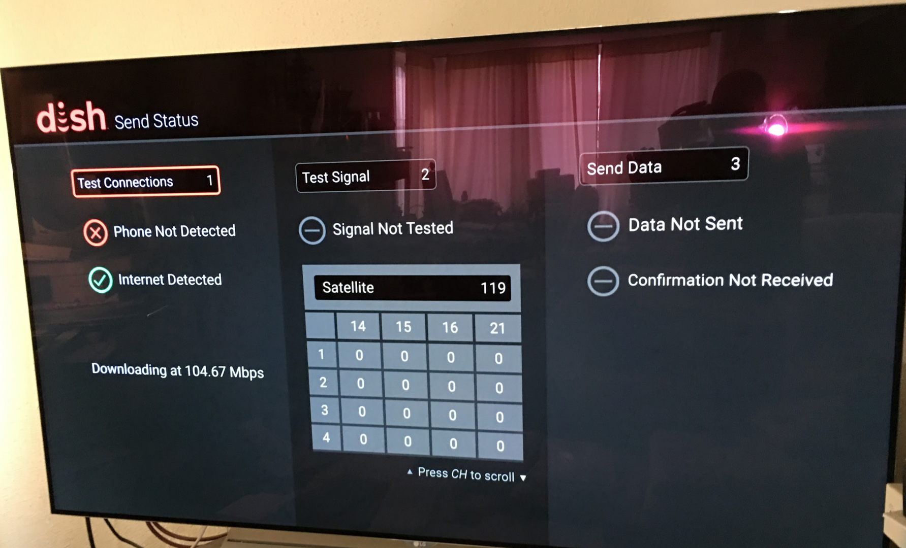

To show the download transfer rate on the Hopper3 do the following:
1) Hit the home key 3 times to get Diagnostics page.
2) Select Status from the left menu.
3) Select Send Status button on right.
4) Select Test Connections.
You will get a Phone Test and the Download Speed.
dweber - Thanks but if one has a Hopper Plus with the Hopper 3, #1 needs to be changed to 1) Hit the home key one time and then choose cogwheel (settings), then selecting DISH Settings and then choose diagnostics as hitting home three times will still land you on the same Home screen as when you hit Home once when a Hopper Plus is involved.
But in any case, I am still getting over 100Mbps down and I am on a 1.44Gbps connection. A lot of times, the connection performance is not just the connection speed alone but the design of the providers network, their peering and upstream connectivity.

Josh.M and brittanygarden - Just wanted to report as a update to the earlier post for H378 - I hope H378 cures my audio dropouts.
That despite the nightly reboots, the Available Joey Software is not showing the Hopper Plus software on the Diagnostics screen and ofcourse the Software Update on the Hopper Plus menu reports Failed, no target so there is no way to know what the current software version is for the Hopper Plus software and/or even update it as that is completely broken in H378... H376 had the problem but the nightly reboot fixed it. I already tried power cord pull and red button reset as well as two nightly update reboots.
