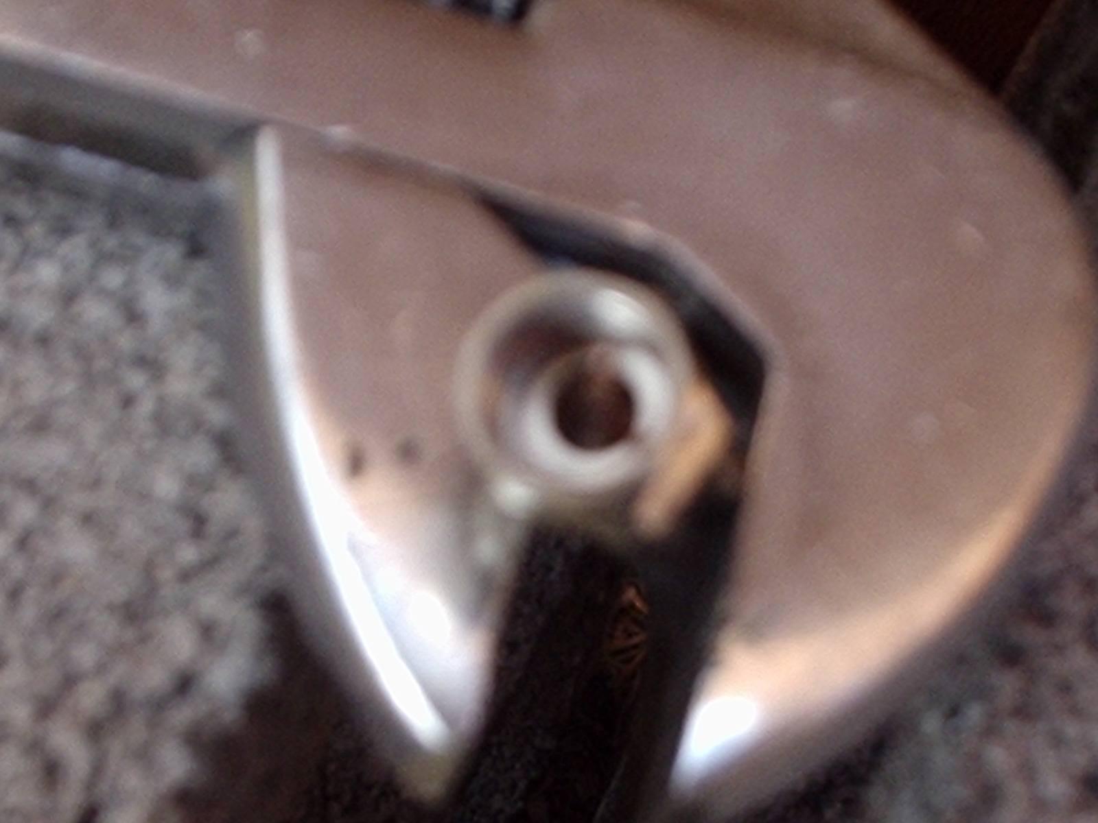

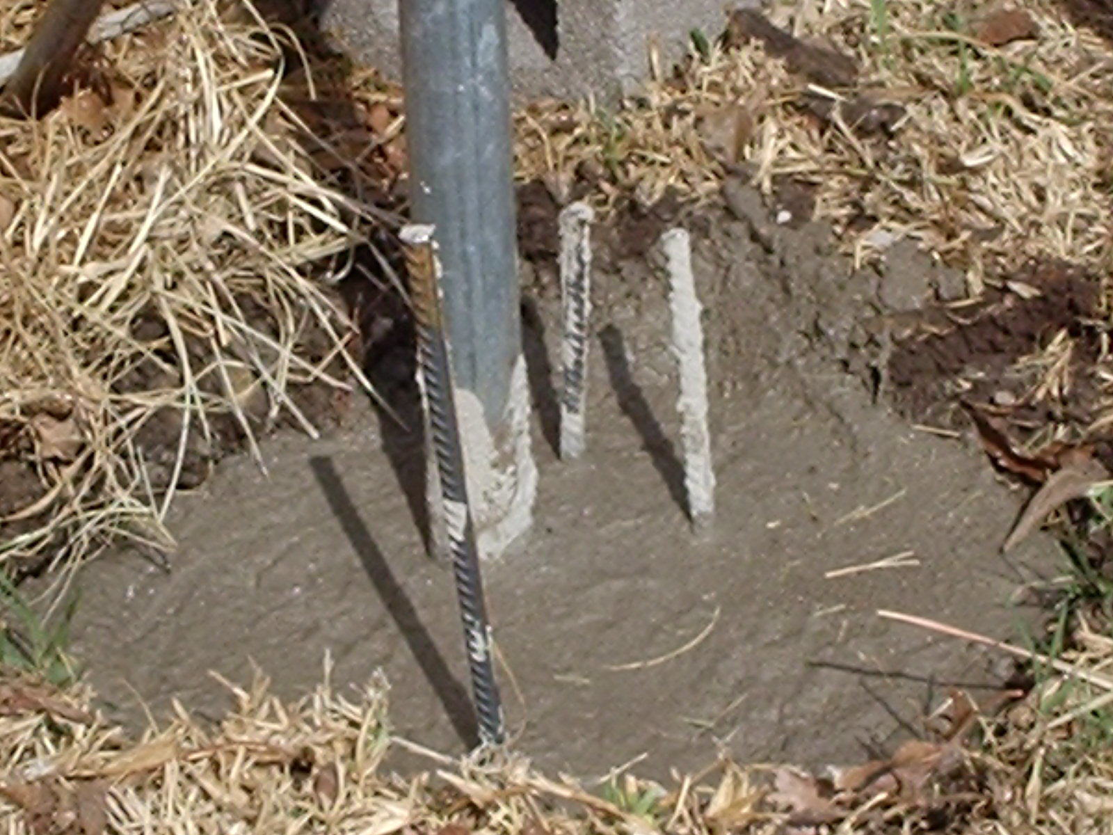

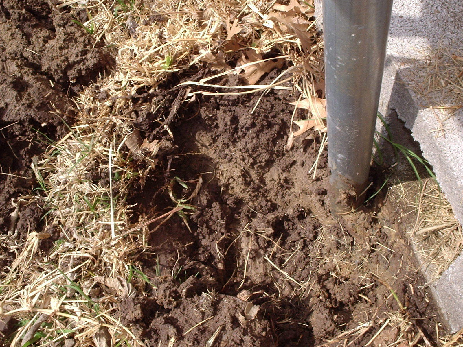

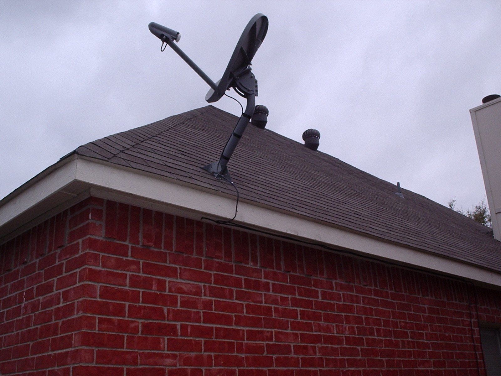

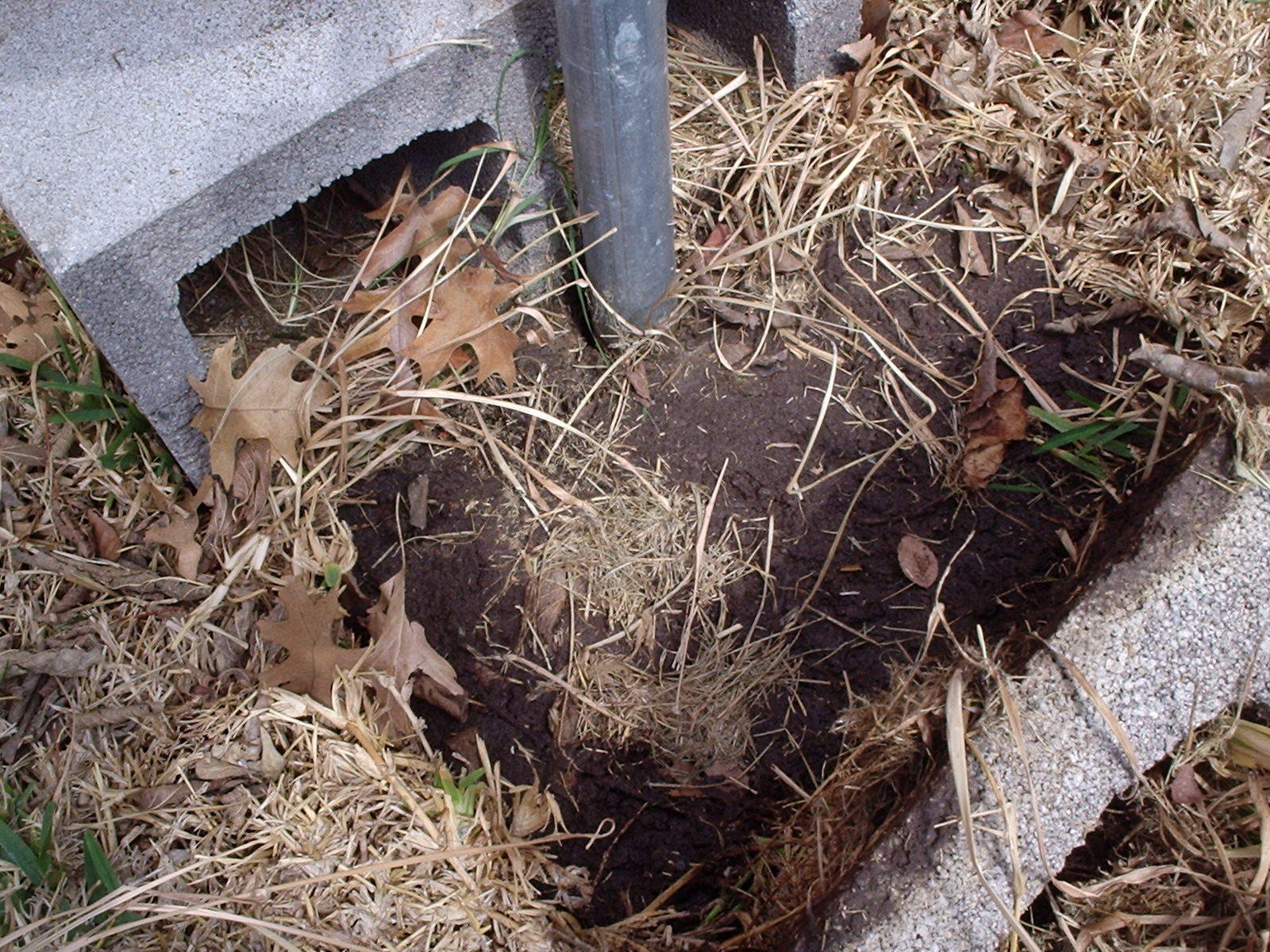

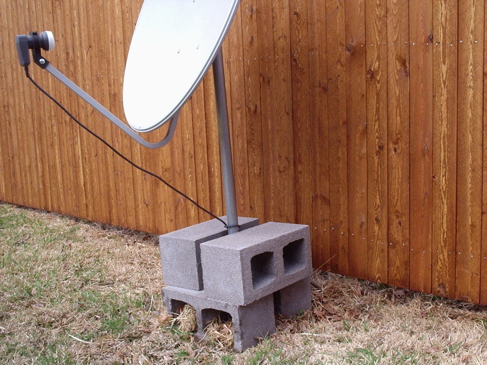

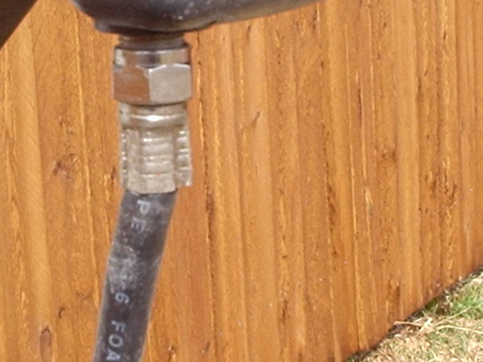

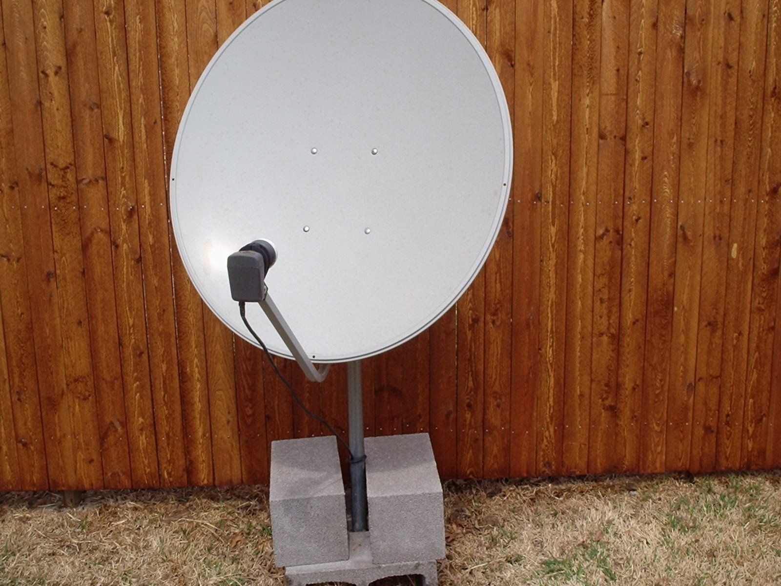

Had an work order from ETTV a customer lost signal, found out this customer I did a service about a year back also has no signal, but this time, the problem also related to installation that I was not detect last time.
This system was installed by a local dealer/installer that has many years so call experience but I did so many his after installtion service calls, there another local chinese dealer I also done some after service calls for him, these two dealers has one thing in common, never ground the system no mater its FTA, or dish or DTV.

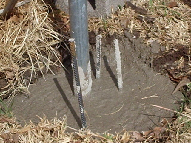

Check the pictures and see what the installation is, and finally I use cement to hold the dish pole in place.
