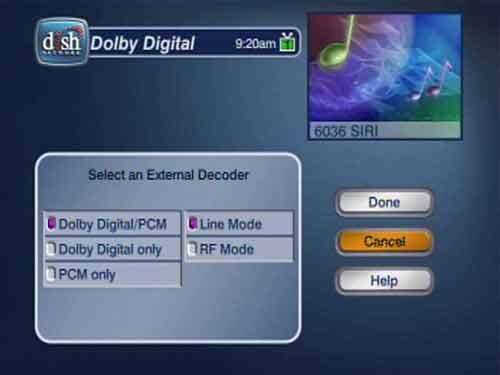

If I go into the 622's menu, and select 6 (System Setup) and then 7 (Dolby Digital), I have two choices to make.
The first one asks: Dolby Digital/PCM, Dolby Digital only, or PCM only.
The second choice asks: Line Mode or RF Mode.
What the hell should I answer? I don't know squat about any of these terms, and I don't know what the implications are if I answer one way or the other.

That's Normal...........it's doing what it's suppose to be doing !
And the Setup you have in that Attachment is Fine !!

Dolby digital/ Pcm and Line mode. Thats what I have and it gives me the best sound.
Only Dolby digital/pcm matter for optical. Line/RF matter if you are using RCA connectors. Line if you connecting to a Dolby Stereo surround receiver with RCA connectors. RF is suggested if a simple stereo or to your TV speakers.
