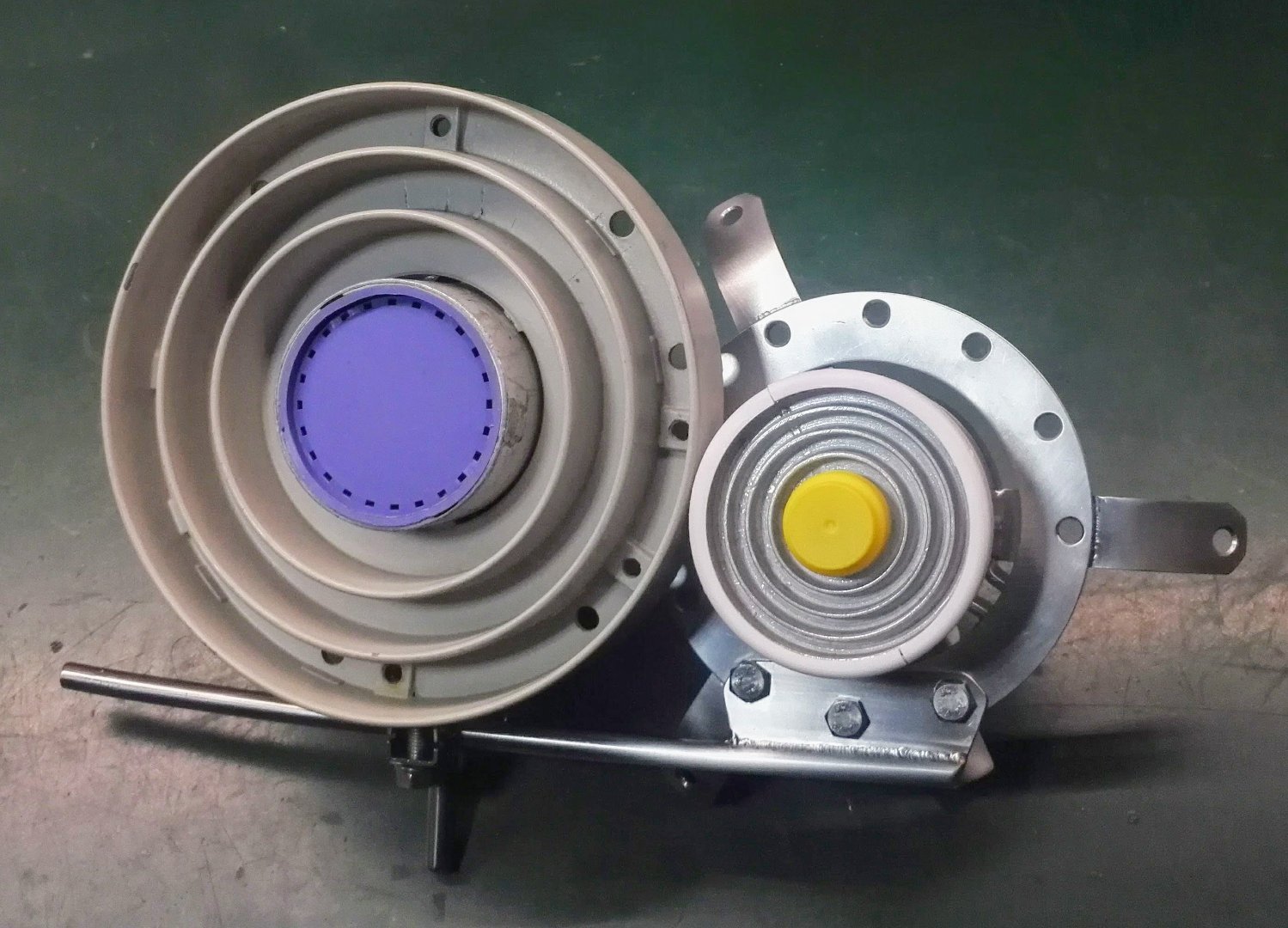

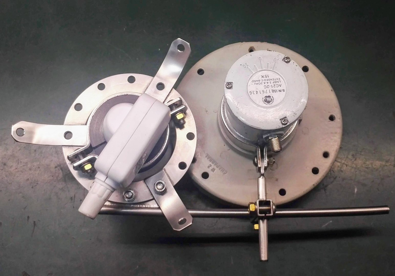

You can do it a few different ways depending on how much money you want to spend, this is the cheapest way using Chaparral Corotor II Plus c/ku-band Feedhorn
But if you don't want to use a servo motor ... you need to use a bullsyes feed horn for C and KU.....

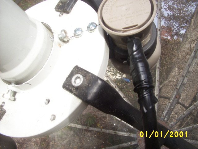

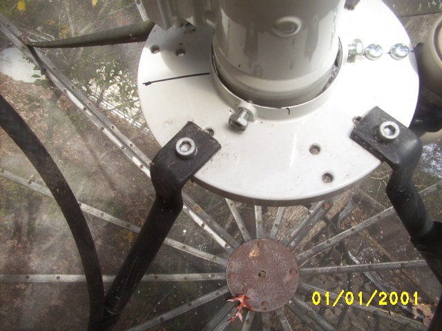

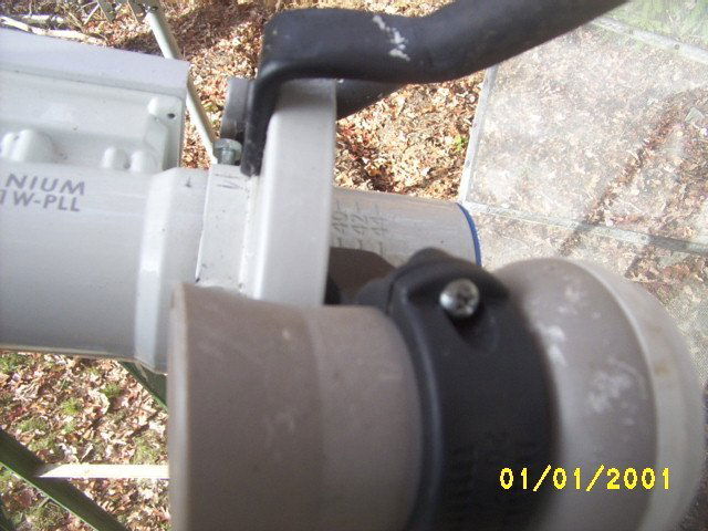

cheapest way it sidecar your ku lnb....iget the same strenth as i did on my 48 inch ku dish. 3 pictures attached

Testing the new Titanium C138 Performance Plus C Band LNBF
