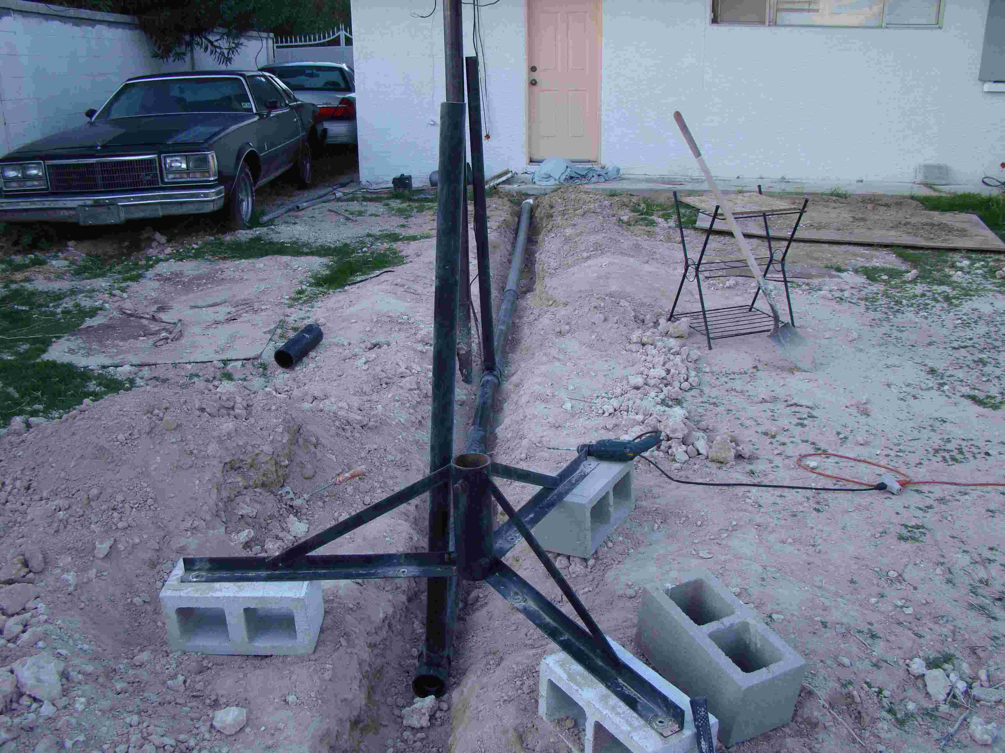

ok thanks to all of you i think ill try 6ftr and hold it down like linuxman but instead of cinder blocks ill use a couple bags of cement its on a flat roof that i could walk to it no latter needed the roof of the garage is lower than the house and my land lord said a deck can be built there so it definitely can hold a 6 ftr just dont want to penetrate so i dont so i dont damage the roof
good luck

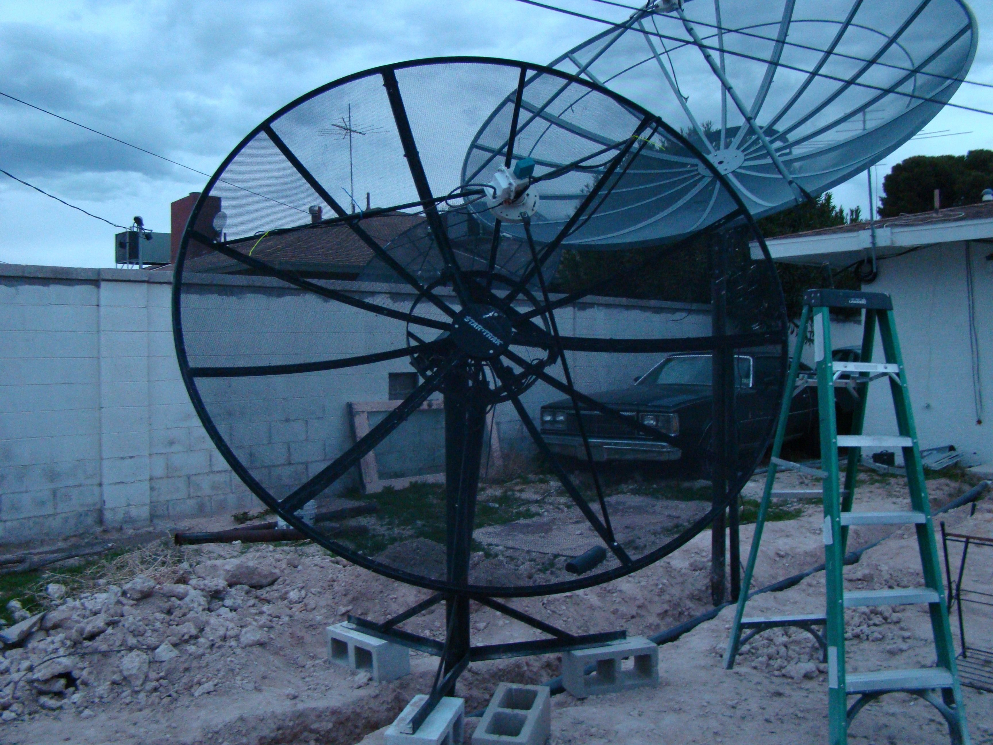

another dish 7.5' 3 years old now
What satellite was this? One other question.
Multi-feed system on a C-Band Dish backbone
