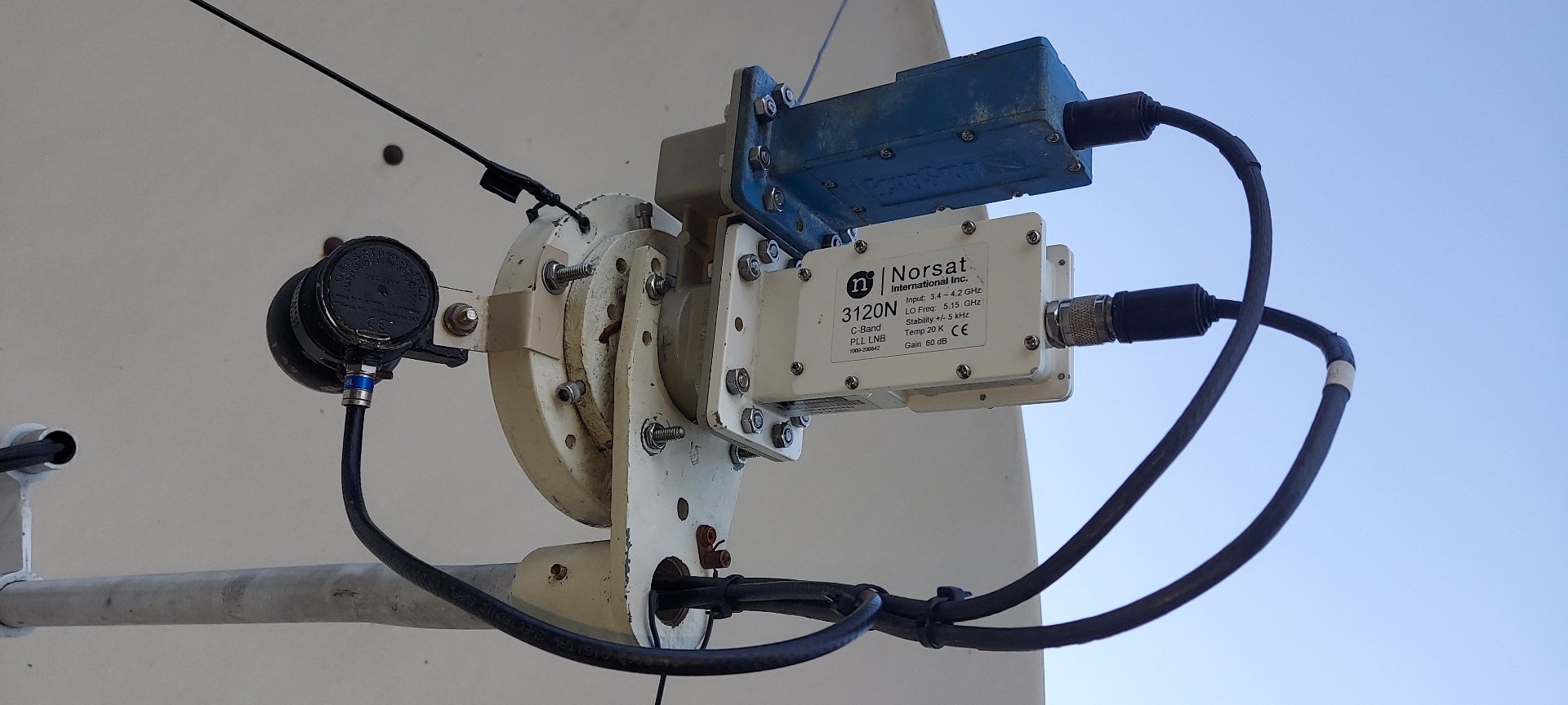

I want to add Ku Band to my Cband Dish.

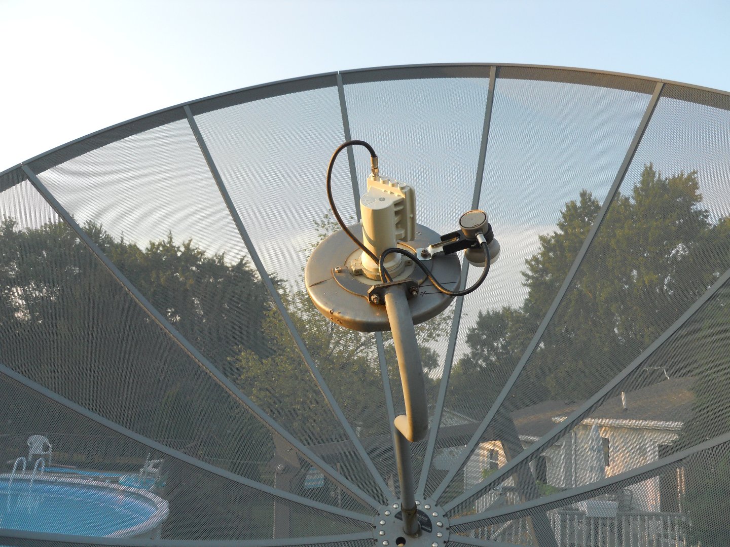

Proof Of Concept today! Ku Band Side Car on a C Band dish for under $30. I have been wanting to try this for some time, and today i finally did it. Thanks to LEEHRAT and arlo for the inspiration, advice, and the pictures. I am using a 10 Ft Winegard Pinnacle BUD and an Amiko Mini HD265 FTA Receiver. For the Sidecar Ku LNBF i am using a GeosatPRO SL1PLL as recommended, and IT IS WORKING! Also using a Universal Single LNB Bracket for the Mount. So far tonight i have scanned in all the Channels on Galaxy 19 97.0W Ku and also scanned in channels on Galaxy 16 99.0W. So i am tracking the ARC, but I am not 100% dialed in yet. A HUGE problem is that the dish is way higher than my ladder can handle at True South (83.0W) so my minor adjustments are difficult and time consuming to do. I am 6 Ft tall and standing on my 6 Ft ladder i can not reach it. So I have to move the dish all the way East to work on the LNBF, make adjustments etc..., then move it back West again to check my results.
I KNOW my Ku LNBF is pointing way too far out from center. From reading this thread i realized you dont want to point it right to center on a dish like this with a Button Hook with a Center Plate in the middle. I started like that and i could find no signal whatsoever. So i moved the angle of the KU LNBF out from center to illuminate a larger circle on the mesh and Bam - i got signal! But i moved it to far out from center. To put it into perspective 97 W C Band for me is at count 886 on my dish mover. For Ku Band on 97W with this set-up its at 963. That is where 89.0W would be on C Band for me. So i think maybe i can move it in for a better signal. But not tonight, i am tired and satisfied with my results for now. So lots of work to do but i can say this works, and i am very excited to get it dialed in. I will update as i go.

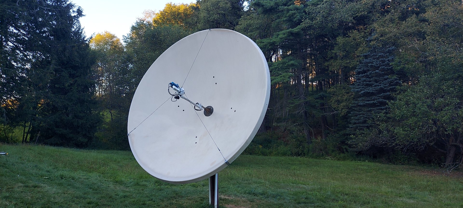

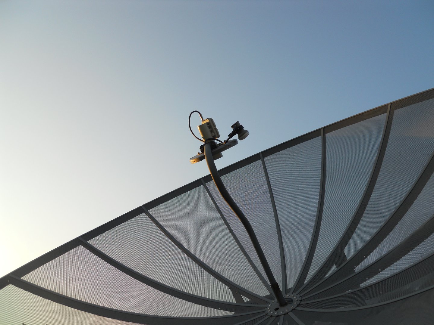

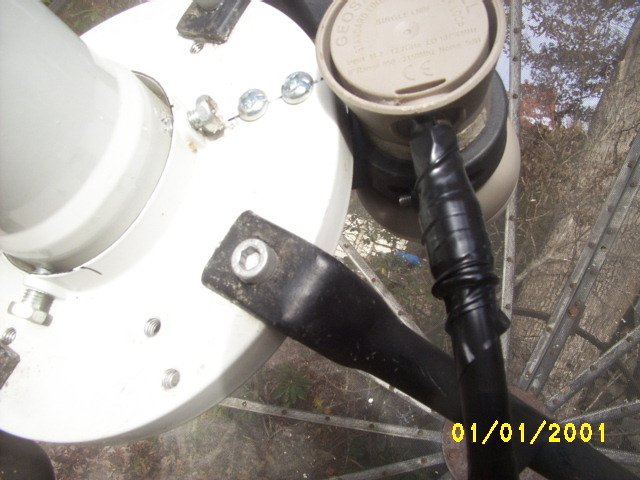

I attached a sidecar to my 8 foot solid dish several years ago and it's performing very well.
At Titanium's suggestion, I used a pipe hanger, slightly modified to attach my kU lnb, with great results. Most of the signals on 97w for example, come in slightly above 12dB.

cheapest way it sidecar your ku lnb....iget the same strenth as i did on my 48 inch ku dish. 3 pictures attached

Hypercasey choose to reflect West and on the same side of the ku lnbf mounted to the scalar.
If you do have a buttonhook feed, you're going to get reduced signal because of all of the "junk" in the way.
Because your lnbf is on the side of the scalar, expect a bit of offset. So a c band sat peaked for signal may have the ku signals peaked a touch East or West.

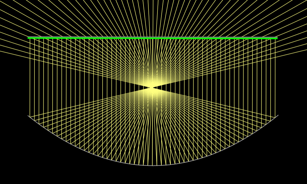

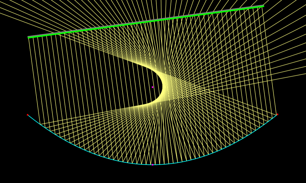

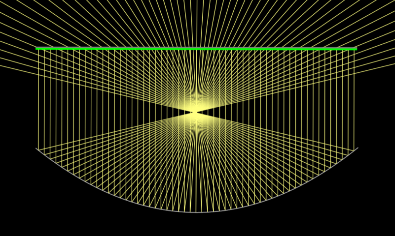

The ray optics ("applied math") simulator was handy to create the following images. First, we have a prime focus parabola with the focal point outside the reflector depth. Second, we have a prime focus parabola with a signal at an offset angle. I exaggerated the angle for illustration purposes. Whether the incident signal changes angle or the reflector changes angle, it is the same effect. The focal point changes into a crescent-shaped wavefront of varying constructive interference with an increasing void in between the wavefront and the parabola's natural focal point. This is the Ku offset LNB "where to position it?" issue.
The purple dot is the focal point. For a 2-degree reflector, the signal strength at that location is going to drop off at a previously-described mathematical rate. To the right of that wavefront? Well, one might describe the signal levels as "increasingly muddy".
In the offset image, only a fraction of ray merge immediately horizontally right of the focal point. That's the "4-foot effect". The efficiency of the reflector diminishes quickly when not at the focal point. Because all of the ray that converge at that location are source from points inside the dish, the angle of the Ku stepped conical scalar rings could be drawn in, further illustrating the concept of illumination limitations. It is also possible that removal of the Ku stepped scalar entirely might improve signal gathering. Hack saw exercises and experimentation are left to the reader.
Others have noted they are nudging the dish positioners sufficiently to be a number of degrees off the original target boresight. The point of that is to attempt to peak the wavefront. It has a point of diminishing returns because, well, you're now running essentially an offset reflector with gain parameters based on a parabolic mechanical equation rather than an elliptical equation. You aren't trying to hit a new focal point; you're trying to maximize a relative position in a goofy wavefront. Because we only use hand tools and not pesky math, we have to experiment with where to position the Ku LNB and how to adjust the reflector azimuth. <whisper> If someone wanted to know where to nudge their positioner, though, I would suggest that the arctan of (Ku offset from natural focal point / focal length) might be a good starting point. </whisper>
This is the illustrated HOW and WHY of antenna and offset LNB performance for prime focus systems. I apologize to all readers for using my 30+ years of experience in electrical engineering, mathematics, and RF regulatory filings for terrestrial microwave systems designed to five and six 9s availability. I will not derive anything from first principles again. I know that I have hurt many people with my HP RPN calculators and graph on log paper. I also apologize to all female techies for the joke. (Let's go shopping regardless.)
Everyone else's mileage may vary.

"A Ku LNBF offset on a 10' prime focus antenna performs like a dedicated 4' " statement starts to make a bunch of sense.
I think I illustrated above, that this is mainly the consequence of the mismatching illumination angle of the LNB-feedhorn towards the opening angle of the (PF) reflector.
Do you agree to that?
The data in the PDFs illustrate both the ITU and NTIA requirements from four decades ago for antenna designs to be able to select satellites spaced at 2 degree separation. This is in order to receive a signal without co-channel interference from an adjacent satellite, but more specifically to allow an antenna to transmit and not cause interference to other users. In RF theory, this is reciprocity. For the same frequency, an antenna's performance for RX and TX should be the same on paper and very close in reality. The roll-off graphs show the maximum signal strength allowed in order to maintain 2-degree compliance. The graphs start at 1 degree off the boresight. This is important because 1 degree to the left and 1 to the right is 2 degrees (a.k.a. starting at 1 degree on the graph is not arbitrary or "magic").
So I read your ITU documents a bit more thorough, and they are indeed about interference of neighboring satellites (your "2-degree compliance"), not about multifeed setups.
Do you recognize the difference?
In a multifeed setup, to receive a noncentral satellite, the feedhorn is displaced from the focal point at the center of the dish to the 'focal cloud' of the non-central satellite.
All these 'interference' articles assume the LNB feedhorn stays at the focal point of the dish.
To me it looks like you confuse the one with the other.
For your Triax, I will assert that the mechanical equation and associated physical design of the reflector has multiple focal points that where the signal intensity is such that a lock is achievable.
The Triax TD Unique indeed is a multifeed dish, with 0 dB loss over the range from -13 degrees to + 13 degrees (see graph).
The just "1 dB loss for a 10 degree off-axis-mounted LNB" is for the Triax TD78 (see the same graph).
This is because of some sorts of abberations, as they are called I believe, for the reflection of a parallel beam on a paraboloid reflector with the beam not along the symmetry axis of the (mother) parabola.
[ The interesting thing here of the focal cloud being shifted away from the focal point, is the beam deviation factor (BDF), I think, which according to literature is about 0.9 for common satellite dishes. I've never found equations that came to that outcome though, though I might have made errors. And I wonder if (or how much) the BDF in the offset dimension (in case of an offset dish) is different from the BDF in the non-offset dimension.
I've made my multifeed-skew (or multifeed-tilt) calculator with the assumption, that they are (about) equal. ]
I have no experience with PF dishes, or C-band, though. But I've learned quite some things about the geometry of (paraboloid, spherical, toroid) reflectors and multifeed calculations, I would say.

Sorry for the delay. A bunch of "real life" got in the way over the last few weeks.
A number of ideas did not make sense to me from an engineering perspective, so I did a bit of a deep dive because I knew there had to be better explanations available out there.
As it turns out, there is a plethora of information available dating back over four decades and in some cases, back upward of six decades. When commenters in other threads have mentioned "2 degree compliant dishes", there is a lot of information available from ITU and NTIA sources to explain the derivation of the parameters. Long story short, anyone having experiences with offset LNBs with minimal changes in gain is likely either using a reflector that is either not designed to 2-degree-compliance or is using a reflector that is capable of capturing signals from multiple satellites. Between ITU REC-465 and ITU REC-580, there are side lobe envelope definitions that are the minimum technical requirements of an antenna design to provide protection against signals that are not on the boresight. By electromagnetic reciprocity, the transmit and receive functions of an antenna design should be largely the same, so determining the parameters around a TX-certified design should get the reader into the realm of a TVRO design pretty quickly.
A33: Specifically above, the fixed, stepped, conical scalar design for Ku offset dishes is meant for a different f/D ratio reflector. The placement of the LNBF on a PF reflector based on the offset scalar design f/D ratio would not have that element not at the PF focal point. Using a C120 flange Ku LNB with a flat scalar would, hence the "focal length disparity". From my standpoint, the f/D "disparity" is really just due to the scalar design grafted onto the LNB.
Looking at the various attachments and seeing the theoretical and empirical graphs, it becomes more clear to me that the performance of an offset Ku LNBF on a 2-degree-compliant reflector is going to be partially influenced by the scalar design as well as the offset angle. "A Ku LNBF offset on a 10' prime focus antenna performs like a dedicated 4'" statement starts to make a bunch of sense.
In the past, I have mentioned that C and Ku performance can be approximated by looking at a similar diameter reflector used for terrestrial microwave. I now believe that to still be true, but with the major caveat that, once learning about "32-25*log(theta)" and "29-25*log(theta)", the terrestrial antenna designs are much more conservative. Practically all microwave antennae in the last three decades are "high performance" and include a shroud that is essentially a sidewall that is the depth of the antenna edge through to the height of the feedhorn. You really cannot purchase a microwave antenna for use in the western world that does not have an integrated side shroud. And that shroud acts basically like a scalar in that off-axis signals are attenuated or outright blocked, hence the greater selectivity and discrimination on the radiation plots. Once I recognized this because of the need for hyper-reuse of terrestrial channels and that satellite reflectors rarely have any perimeter "fencing" and after analyzing the mid-1980s NTIA docs, it all started to become very clear to me.
For the interested, please take a look at the attachments.
I went down this road a few years ago. Look at this thread
However since then a couple of hurricanes dislodged my KU LNB and just now I am getting to fixing everything. I am not have much luck with the alignment.
Here is my question. I did just buy a combined C/KU lnb and got the C band working but the unit does not have the 5G filter making the channels unwatchable. Thus I never even tried to get the KU working. I want both.
So instead of doing the sidecar method of adding KU, I cannot find a combo lnb with C/KU with C band 5g filter built in. This would be perfect in that one only has to aim the dish once to get both bands.
Can someone tell me where to get such a LNB. Does not seem that they are made!
Thanks

A combo lnbf was also an interest until hearing of the poor performance of them in comparisons and reviews. So no big surprise nobody is making a filtered new unit.
You could probably go with an old Chaparral feed but would need a dish mover with polarity control. Or an ancient ebay receiver/dish mover with polarity control built in. You'd have to get up to change settings.
Or an orthomode feed for 2 c & ku lnb's. Did anyone say $$$? Plus the multiswitch and diseqc switch involved.
Do the sidecar. If you do it right. You may not get the same satellite in both bands. But you could aim the ku to be spot on 6 or so degrees East or West from it. Depending on the side you mount it on.

Thanks for the replies, I did have the sidecar working a few years ago but last year hurricanes Helene and Milton took care of that. So I am starting from scratch to get the KU lnb aligned. We will get there as this is a hobby so not the end of the world.

For me make sure your dish is pointed at true south, then I put the ku at 90 degrees and mine is about 4 degrees from c location, exp 99 c would be pointed at 103 k. I have attached picture of my set up
I gave this a try today using the pictures from this thread. I was able to tune VAKN on 105KU by moving the C-band actuator to 99. I got 80% SQ, which is about 8-10% higher than my 90cm GeoSat Pro.
I then tried PBS on 99 by moving the dish to 93. Was able to get decent SQ, but the LNB needed to be skewed.
I guess the question is, would the LNB need to be skewed every time the dish is moved to a different satellite?
