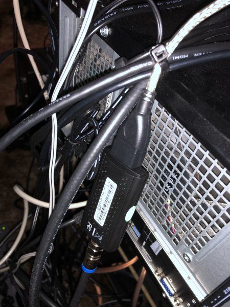

If you have a cooling device, the OTA dual tuner works PERFECTLY!!
Mine is placed in front of my PC cooling fan

Like another op stated - keep the adapter suspended mid air and it will perform just fine.
