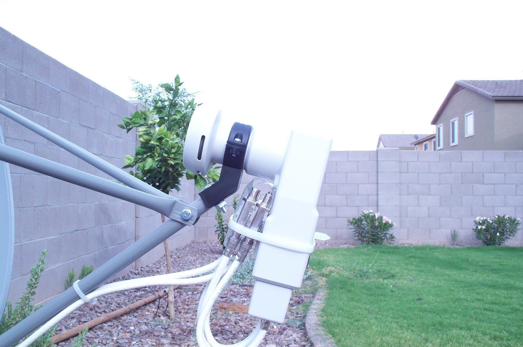

There is about half an inch that can be adjusted in the focal length, can someone who has a geosat/azure/3abn and an invacom quad lnb provide some feedback or recommend where the best signal strength can be achieved by adjusting the focal length?

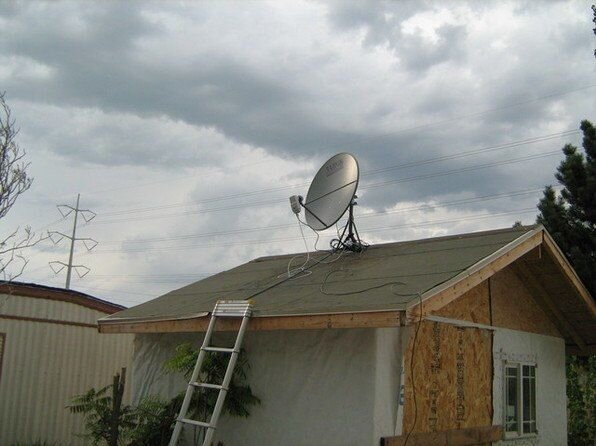

Hooray! I'm sure it's not 100% peaked, and I definitely need some new RG6 jumpers... but for now at least I'm so very pleased! Here's some pics of my new setup aimed at our favorite bird. I even scored a 120GB hard drive for $10 locally, I just need an external drive casing to make my Visionsat IV 200 into a PVR :D
Yeah, it rained while I was up there. Too bad! I refused to wait anymore.

Congrats, CharredPC! Glad to see you back in the game :) How do you like that 3ABN dish? I am really impressed by the quality of these Azure Shine dishes.
Congrats and thanks Charred! All I can say is Yee-Haw wrangle them satellites space cowboy!

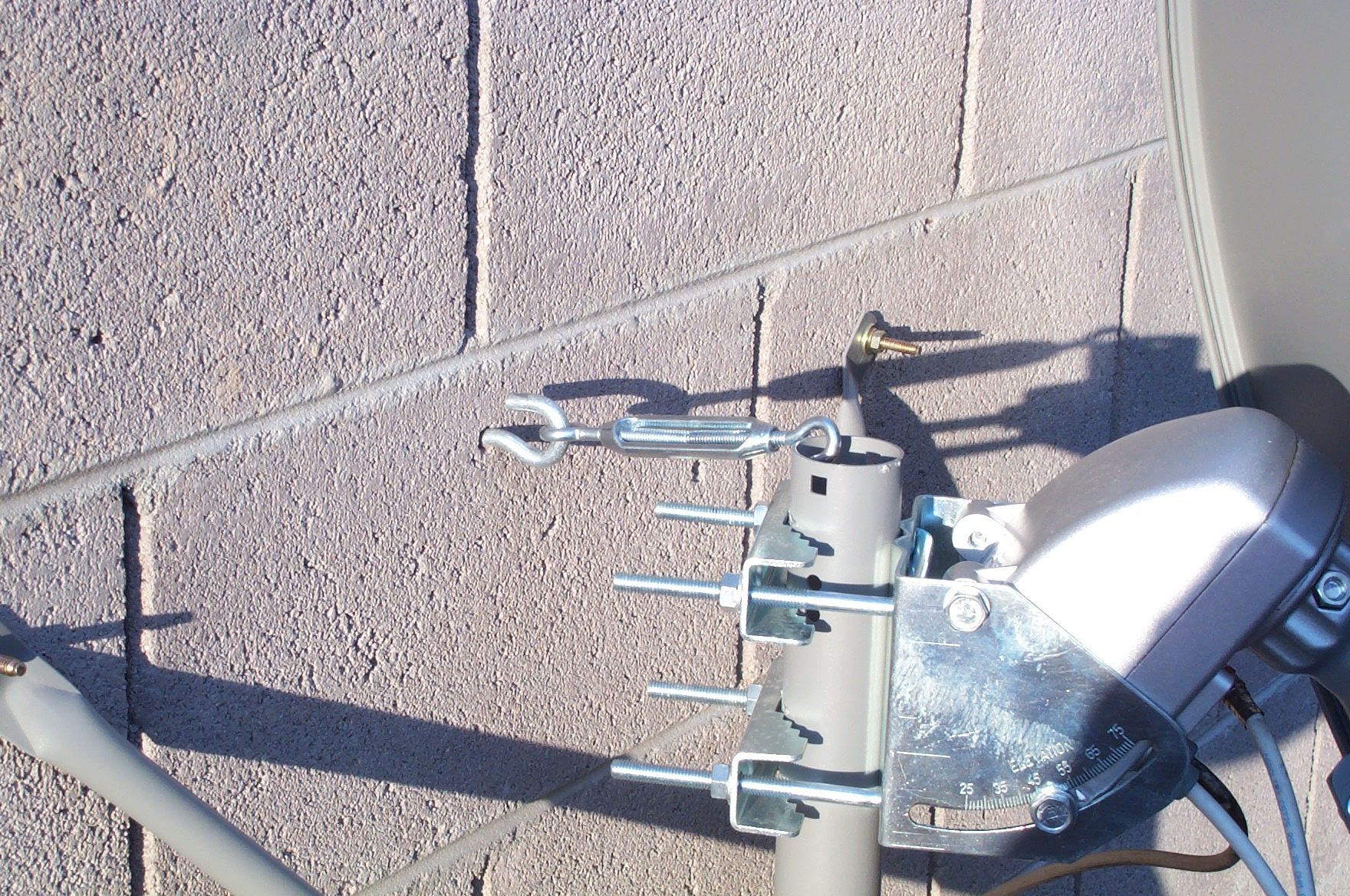

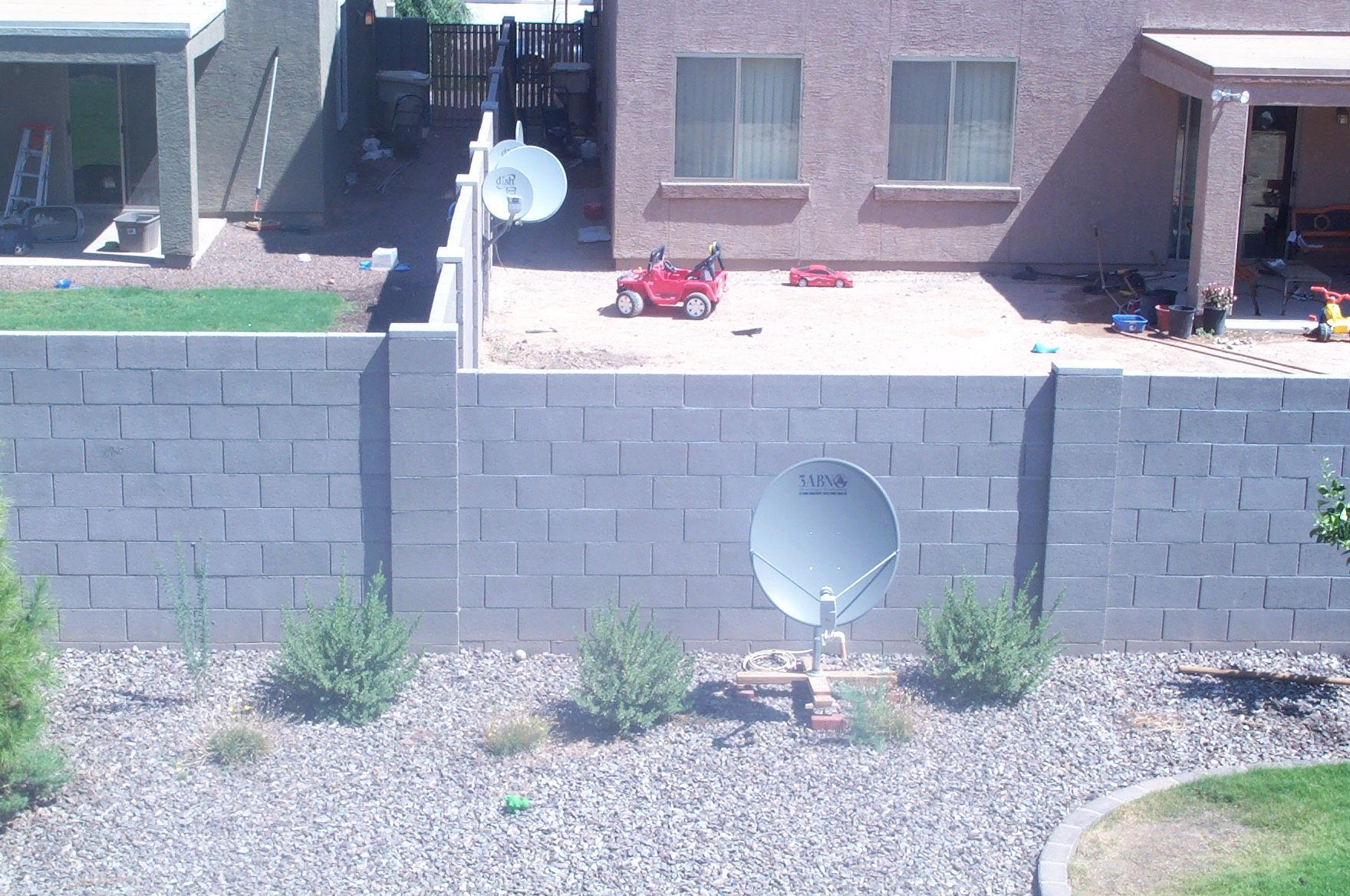

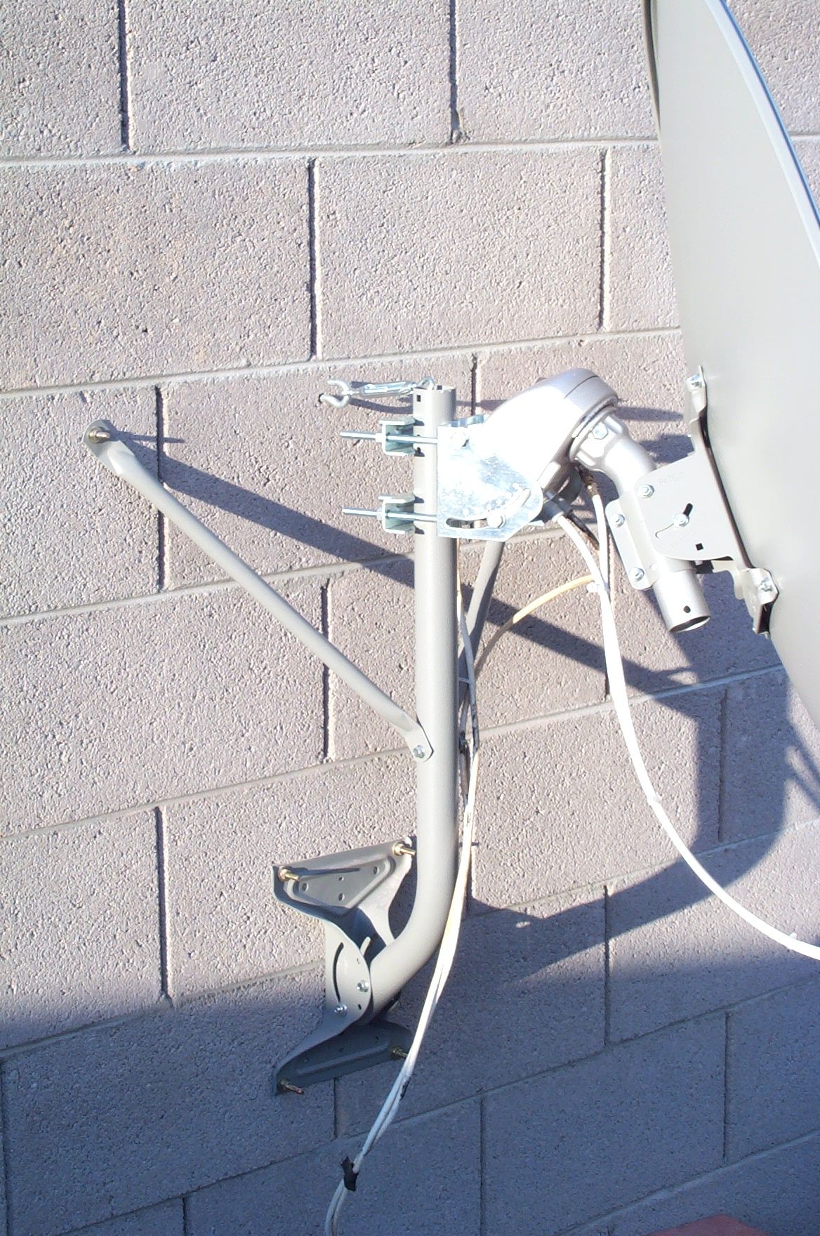

My 3ABN dish is up solid, the mount is fairly good for wall mounting though I couldn't get it to lock in perfectly vertical with the weight of the motor and dish on it. I added a hook and turnbuckle and it then went plumb easily, improving my signal strength immediately. I can currently see from 61.5 to 121 fairly well, a few weak signals there, I expect to tweak it onto the arc better and hope I'll be able to see anything from 61.5 across to 129 with it. The 3ABN definately gets better signal then the old primestar did.
So far I can see over my two story home pretty well.

Ziploc -
Kudos on the turnbuckle idea.
Great pix, too.
I may post one using your idea, later.
Heck of an unusual place for a dish - just love it.
Pretty much out of the way, yet easily accessable.
Just not sure how good the signals would be if you had a lawn party. :cool:
Also answers some previous questions of how much arc one can see when mounting to a south-looking wall:
