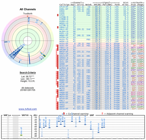

TVFool is out of date, the database is over 2 years old and there has been a lot of repack activity. Attached is a better report. The important thing is to have it mounted on the southwest side of the house, facing town. It is not very directional, and the angle is not going to affect it as much as you think. Point it southwest. You have many strong towers, all in the same direction. There are no VHF high band signals so the little dipole on top will not be in play. This little Clearstream should do reasonably well, recommend raising it some above the gutter. As far as a mount, maybe a 1 1/4 pole to the ground with supports. Use your imagination. RabbitEars.Info
