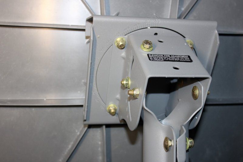

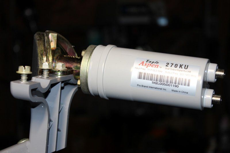

Assembled the dish today. Very nice hardware and reflector! Think I should have purchased two LNBFs though, the dish came with a dual LNBF holder for 6 deg satellite spacing, perfect for 91 and 97, so might have to order another to complete the assembly as these feed horns are made to match the dish. Also the dish IS skewable.
Also came with a nice mast, might set it up on an NPRM I have already holding a 120cm dish if I don't install it on the HH120...

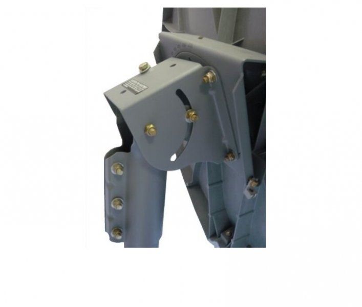

While I don't have one of those dishes, here's a pic of the back of the dish from the Impakt ad.
Reactions: phlatwound

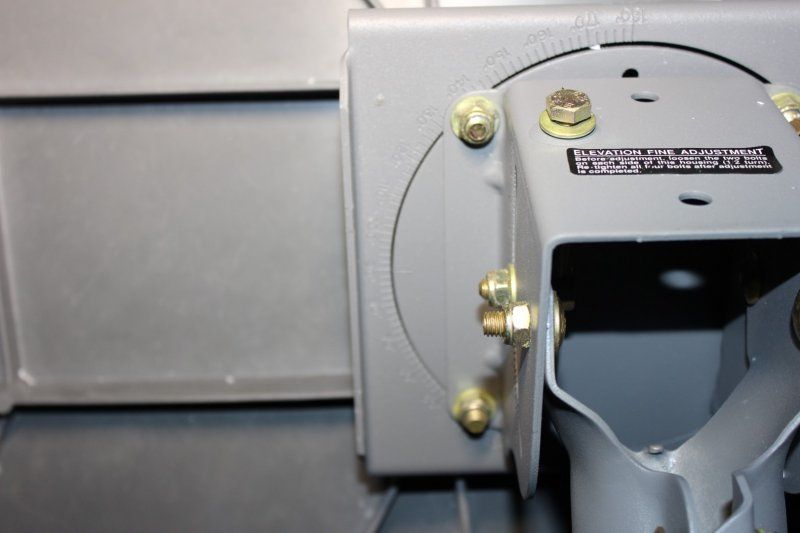

Installed the dish last night and tuned it up this am. Was rather unimpressed at first, could barely get a signal on 91W using 12010 V 13330 (ABC news feeds) as a beacon. Really nice having the elevation bolt to fine-tune though. Messed with the dish skew and got the signal up to 8dB but it was way off kilter from where it should be... then I realized the LNB skew can be adjusted... so I could skew the dish to where it should be at almost 90deg, then adjusted the LNB skew to get a bit more than 12dB CN, and it's heavy overcast here this am. Now I'm happy! :)
