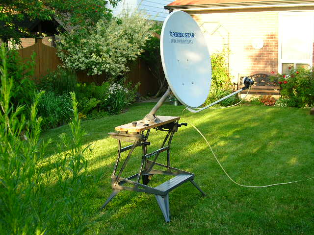

Yesterday was lets snag AMC-1 and watch COZI TV.

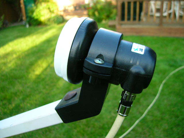

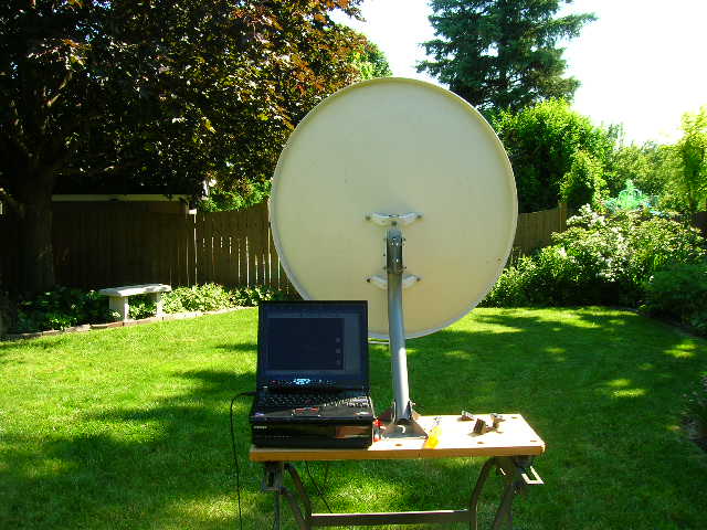

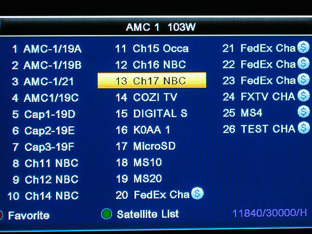

The S9 was mated to an IBM pc with a screen capture device. The 33 inch Fortec dish secured to a Workmate bench. This combo works well and also allows access to the internet via wifi. Took a while to find the right spot due to the trees. The LNB, PLL321S-2, skew is touchy but manageable. The DVB-S2 channels need a strong and solid Q to lock. Anything below Q 50 would not lock.
I used TP 11943 to find the sat since it is DVB-S, strong and locked easily. Tweaked the dish and got Q75. TP 12146 also Q75. Q on 11840 was 70.
Skew on LNB is about -10. The elevation markings on the Fortec dish were spot on. Dishpointer specified 34.5º elevation which is what I set the dish to.
All in all a very successful half day. Pics attached.

Apparently the LNBF skew is critical. -20 is recomended. My skew here in the province of Ontario is approximately -10. I guess I must be lucky because it all came together rather easily. Again I must stress PATIENCE is a must. Also the bigger the dish the more critical is the alignment because the beam width becomes more narrow as the dish size increases.

The fact that the Q is jumping means more very lite touch tweaking required. Also make sure you have clear line of sight to the sat. With the S9 here, it would not lock on an S2 TP with a Q less than 50. Look at my first post, I have a pic of what my S9 scanned in. Also you may get different channels on different days depending on the feed that day.
