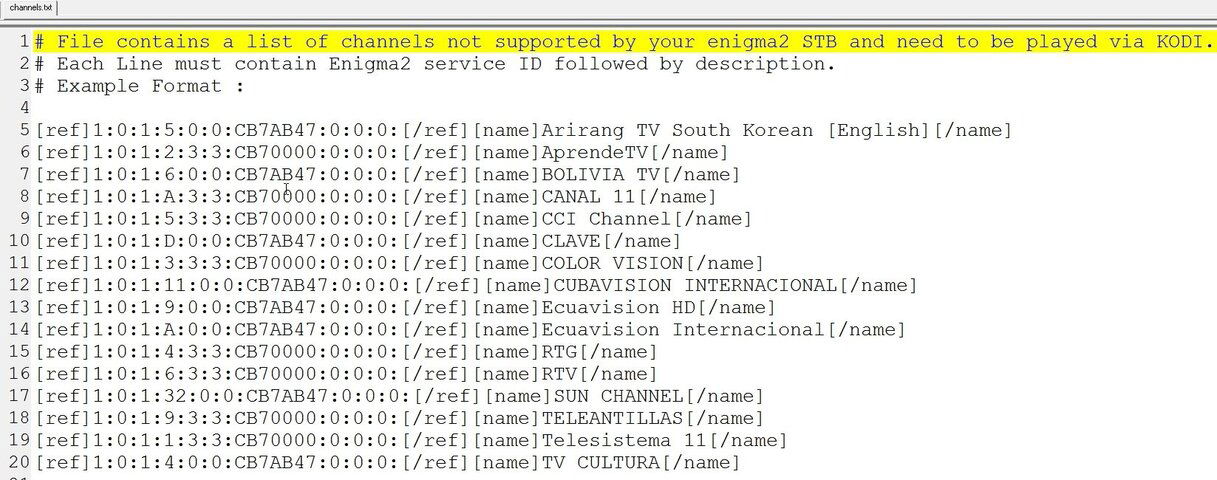

Well, I took a couple hours, and i wrote just that. I made a list of the enigma2 service reference #'s for the corresponding channels that wont play on my STB. My program checks every second what service is playing on the STB, and the moment i switch to a channel in the list, the program automatically changes my Video input to my KODI and then the program automatically tells the KODI to stream/play the service channel... When im done watching that channel, on my remote, i just change the channel to the next channel, and if it needs to play through kodi, it automatically initiates the next stream, and if its a channel the STB can play, the program automatically switches the video source back to my STB. - I don't have to do anything other then hit the channel change on my remote and my program automatically makes the adjustments that are needed. The program is smart enough to know what video source its on, so im not changing video sources every time, only when needed, ie switching from compatible channel to a non compatible channel.

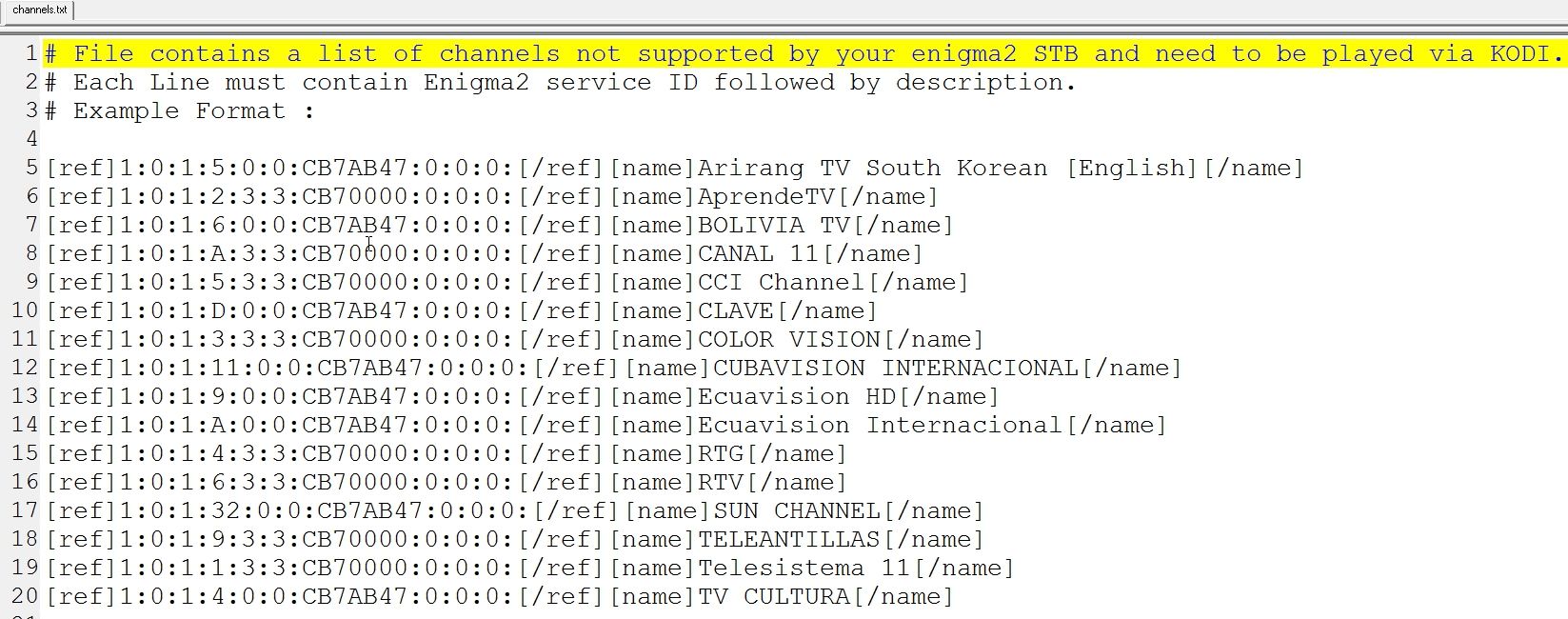

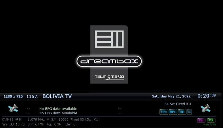

Here are a list of the channels that will not play video on my DreamBox 920 and DreamBox 520 units.
Code:
    "Arirang TV South Korean [English]"
    "AprendeTV"
    "BOLIVIA TV"
    "CANAL 11"
    "CCI Channel"
    "CLAVE"
    "COLOR VISION"
    "CUBAVISION INTERNACIONAL"
    "Ecuavision HD"
    "Ecuavision Internacional"
    "RTG"
    "RTV"
    "SUN CHANNEL"
    "TELEANTILLAS"
    "Telesistema 11"
    "TV CULTURA"
11079v10000 and 11652v10000 are the only two transponders that have this weird format, but its not all the channels in those muxes. For example : AME47 and others on 11652 plays video fine and SeoTV on 11079 and others play video fine. In another words, not all channels in either muxes won't play video, only the ones listed above.

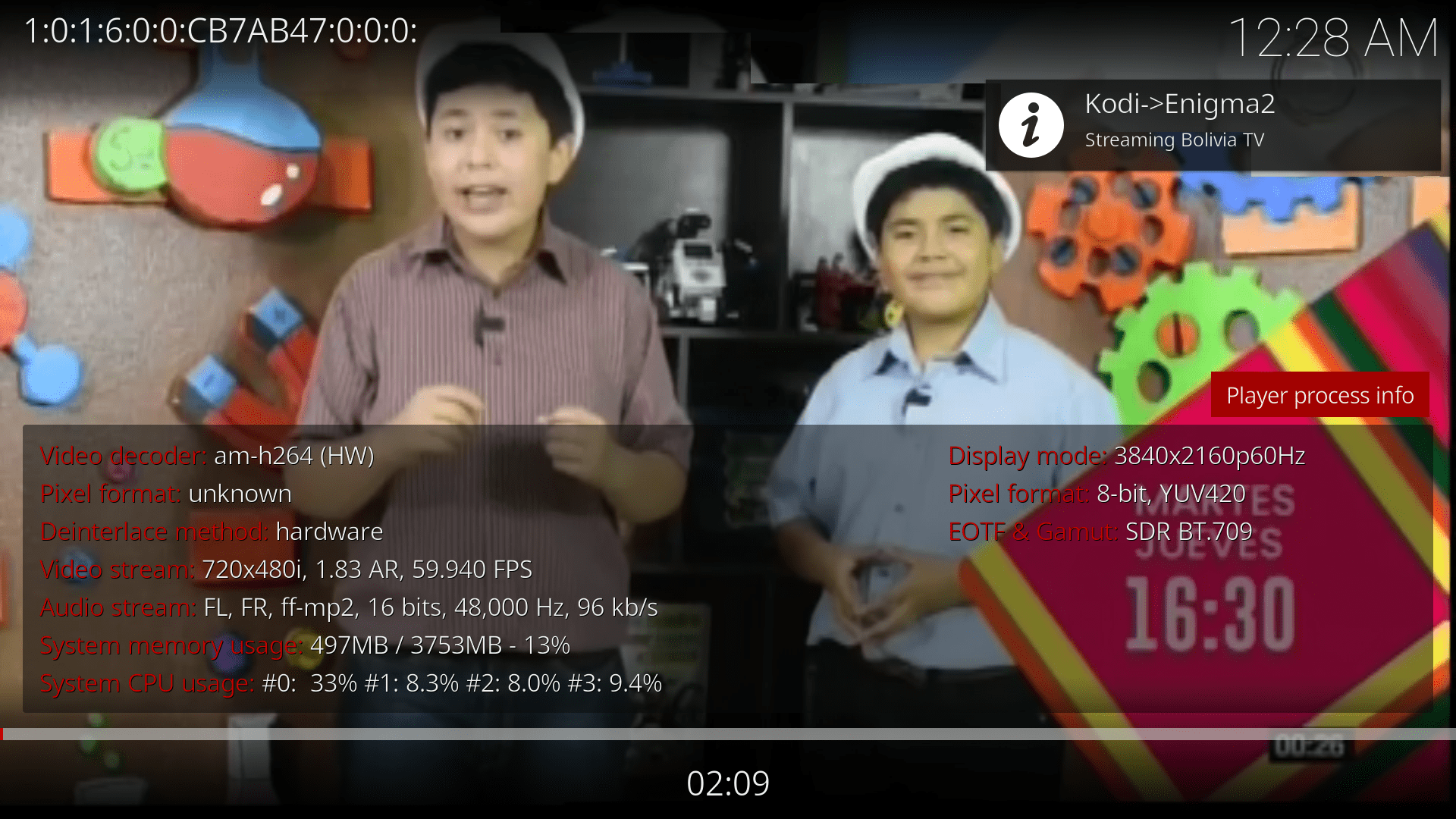

I haven't used any special program to look at the codec information between the ones that work and the ones that don't work, but looking just at VLC codec information, working and non working channels look to be the same, so i have no clue why they won't play video.

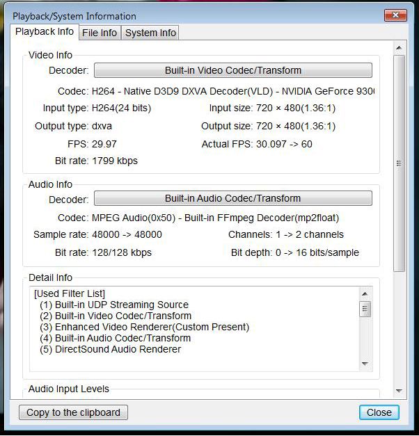

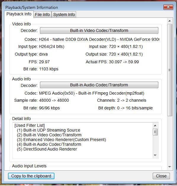

From my AZBox (which does play all the channels) I streamed to my computer and used PotPlayer to view. I did notice that all the channels that aren't playing for you have the same information/format:
Whereas some of those that are playing for you in the same 720x480 format have the following:
The difference appears to be the line after 720x480, those listed as 1.82:1 don't play, and those listed as 1.36:1 do play! Strange, but I wonder whether there is something there that is causing the problem.

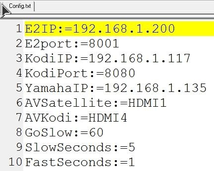

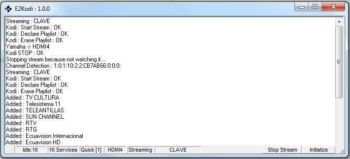

Okay, I am finished with version 1 of the program. I moved it to its own separate program, ie not apart of the DSRC program. I also made it so it can be configured via config files. I also made a slow mode so its not querying the service every second. When your actively turning channels, it is quick to pick up channel changes, and when you have been idle for awhile, it goes into slow mode. I am going to give this a try and run it on my server and see how it goes.
The first time you run the program without any configuration, it runs you through allowing you to specify settings and creates a dummy channels.txt file for you to add your customer enigma2 service ID's.
Well, i have been running the program 24/7 for a couple weeks. I am impressed with how stable it is. Its so stable, i added Arirang to my News Boutique List. In another words, the once incompatible channels are now intermixed with normal channels.
