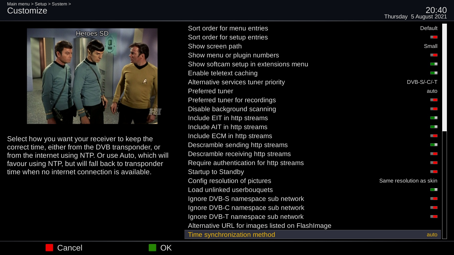

Explanation for the Auto choice with the time sync screen.
Reactions: FTA4PA
