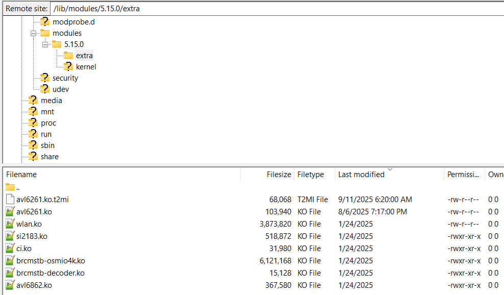

Rather than jumping around in the TNAP menu swapping drivers and rebooting. A handy way is to put them all in the same
/lib/modules/5.15.0/extra
directory and append the names with the according functional purpose.
Currently the regular driver is used and the name remains avl6261.ko
The T2MI driver is waiting to be used after appending the regular driver something easy to remember. avl6261.ko.regular (for me).
And the .t2mi edited out. A reboot of the receiver then uses the driver it expects.
At one time I had all of the drivers in the directory appended to try out. Not sure if the TNAP drivers directory is the same (this is OpenViX).

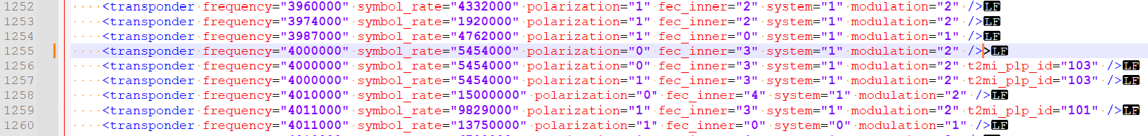

Further. Adding the transponders to the satellites.xml does require care. They must be entered exact. In Notepad++ there is a plugin named XML Tools. In that menu is a Check XML syntax now function. Any errors will be highlighted. In View>Show Symbol. Check all of the options. Hopping from driver to driver with a known transponder to check becomes quicker.
As you might notice. 4000 has both H&V (L&R) polarities. Duplicates come from me not using a depolarizer.
