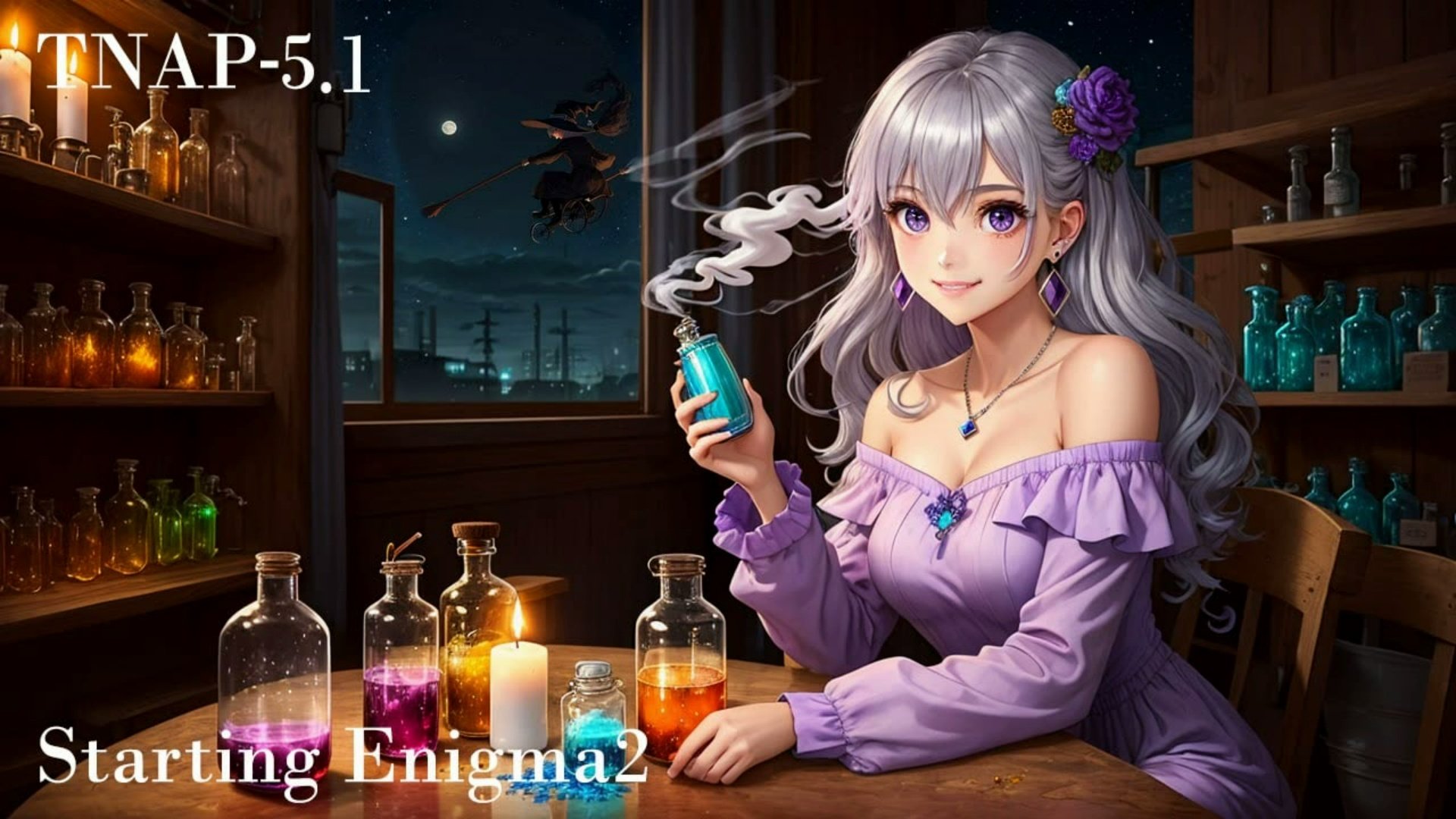

Is there a way to get rid of the awful stock image that comes loaded with TNAP 5.1?
It looks like this software was programmed by teenage boys.
The boot logo is stored in /boot/bootlogo.mvi
What can you use to create a .mvi file? No idea. Why didn't Enigma use a more popular format? No idea.

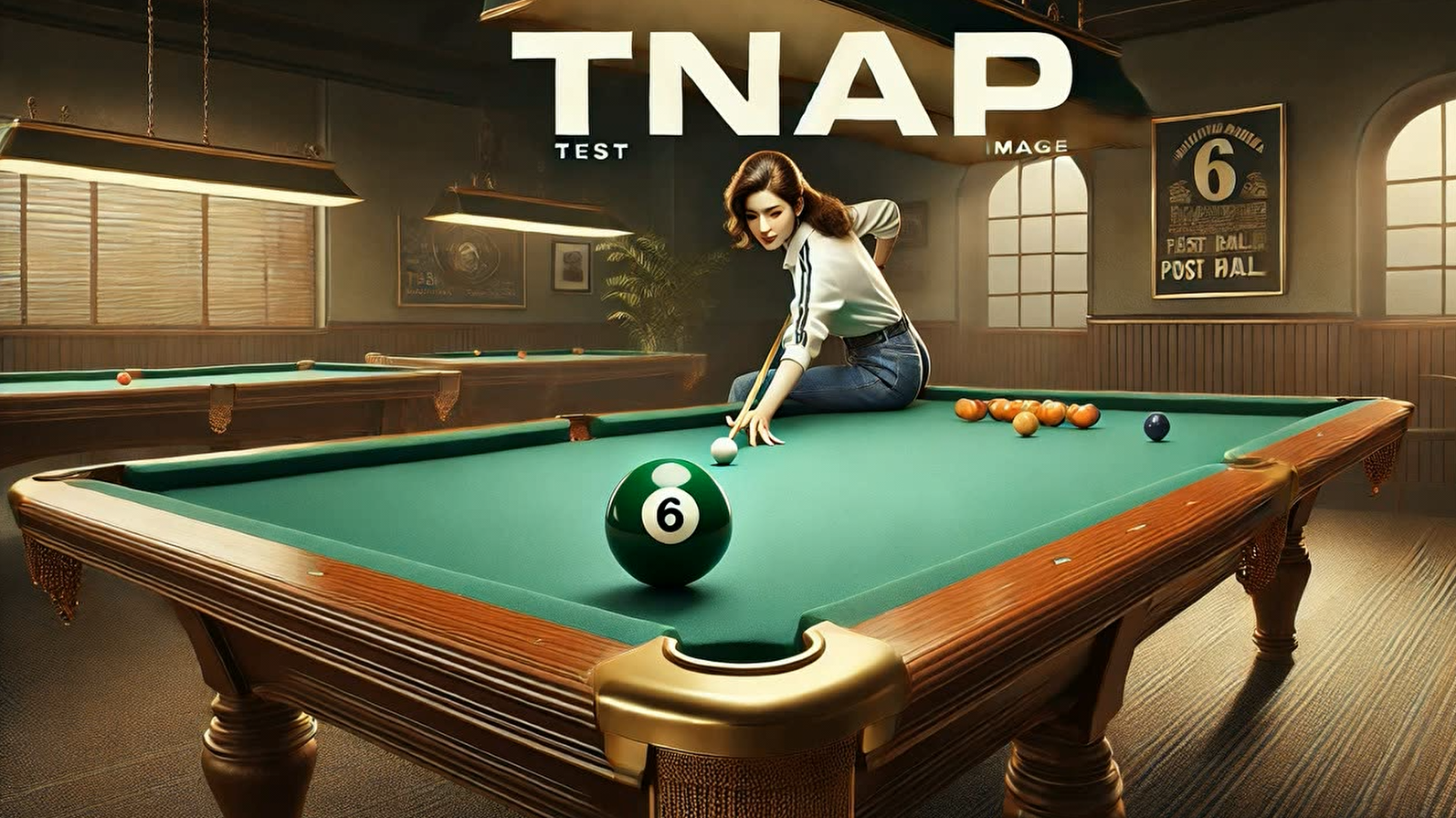

There seems to be more to the story. This location has two images called bootlogo.mvi and bootlogo_.mvi. They are the same image as below. Similar but not quite as 'interesting'. So the final image being used must be located elsewhere. .mvi files can be opened using PotPlayer.

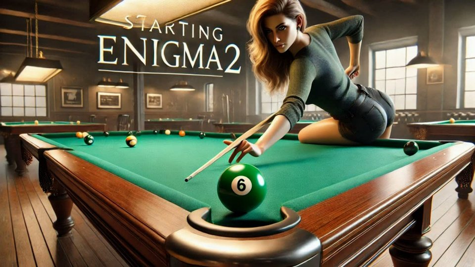

These wallpapers are really immature-looking for software we're supposed to take seriously. I suppose the programmers can do whatever they want, but when I see anime wallpaper I think of kids trying to write software while living in mama's basement 😆
And what's with the woman sitting on the pool table?
The older TNAP images had a Route 66 neon theme which was much more professional IMO.
