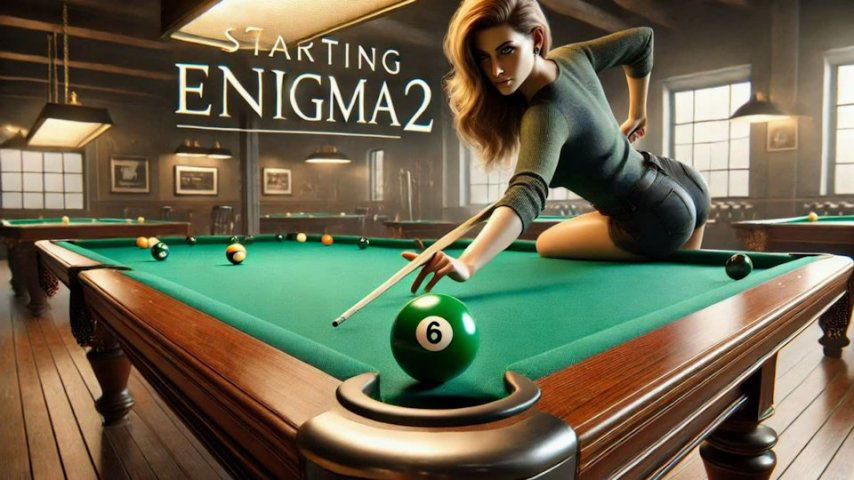

Is there a way to get rid of the awful stock image that comes loaded with TNAP 5.1?
It looks like this software was programmed by teenage boys.
The boot logo is stored in /boot/bootlogo.mvi
What can you use to create a .mvi file? No idea. Why didn't Enigma use a more popular format? No idea.
If you have access to a Linux system with ffmpeg installed the following command supposedly works although I have not tried it.
ffmpeg -i mypicture.jpg -r 25 -b 20000 mypicture.m1v && mv mypicture.m1v mypicture.mvi
Replace mypicture with the correct file name of course. :)
The boot logo is stored in /boot/bootlogo.mvi...
There seems to be more to the story. This location has two images called bootlogo.mvi and bootlogo_.mvi. They are the same image as below. Similar but not quite as 'interesting'. So the final image being used must be located elsewhere. .mvi files can be opened using PotPlayer.
These wallpapers are really immature-looking for software we're supposed to take seriously. I suppose the programmers can do whatever they want, but when I see anime wallpaper I think of kids trying to write software while living in mama's basement 😆
And what's with the woman sitting on the pool table?
The older TNAP images had a Route 66 neon theme which was much more professional IMO.
I'd be very hinky doing this to my Mio. I distinctly remember a couple guys bricking their receivers and having to go through hoops to recover them when they messed with the boot logo a few years back... For SURE if you try it, that your replacement image is about the exact same size of the one you are replacing.

sorry for long post, and apologies if it's greek to some...
the anime image bothered me too, so i replaced mine with shots of the mountain ranges that are safer to look at when the wife is around, haha.
anyhow..
root@osmini4k:/boot# ls -ltr
lrwxrwxrwx 1 root root 18 Mar 29 2024 bootlogo_.mvi -> /boot/bootlogo.mvi
lrwxrwxrwx 1 root root 23 Mar 29 2024 bootlogo.mvi -> /usr/share/bootlogo.mvi
- /boot/bootlogo_.mvi is a symlink to /boot/bootlogo.mvi
- /boot/bootlogo.mvi is a symlink to actual /usr/share/bootlogo.mvi file, which is the one you want to update.
so both /boot/bootlogo* references should be left alone. just replace (or backup then replace) the one in /usr/share/bootlogo.mvi if you want changes to be effective...
while we're at it...
these are all the locations you can adjust for different screens...far as TNAP is concerned...
./usr/share/backdrop.mvi
./usr/share/bootlogo.mvi
./usr/share/enigma2/radio.mvi
./usr/share/enigma2/black.mvi
below, you will see that one is also a symlink in /usr/share (bootlogo_.mvi) that just points to bootlogo.mvi in same directory. again, leave the symlink alone...
but the others here are files you can change* as desired, *long as you know what you're doing.
root@osmini4k:/boot# ls -ltr /usr/share/*.mvi
-rwxr-xr-x 1 root root 154536 Mar 29 2024 /usr/share/bootlogo.mvi
lrwxrwxrwx 1 root root 23 Mar 29 2024 /usr/share/bootlogo_.mvi -> /usr/share/bootlogo.mvi
-rwxr-xr-x 1 root root 178107 Jun 23 2024 /usr/share/backdrop.mvi
root@osmini4k:/boot# ls -ltr /usr/share/enigma2/*.mvi
-rw-r--r-- 1 root root 157501 Mar 29 2024 /usr/share/enigma2/radio.mvi
-rw-r--r-- 1 root root 20876 Mar 29 2024 /usr/share/enigma2/black.mvi
hope this helps.
