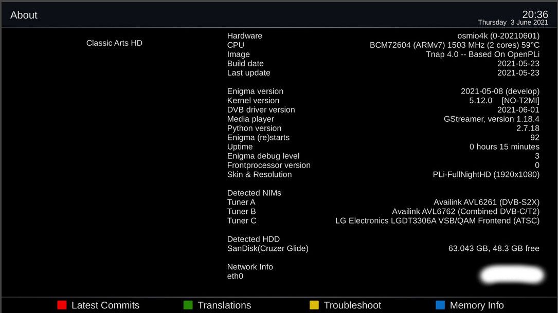

Latest TNAP4.0 is 6/02/2021. Use the Setup>flash image menu. That image fixed the about page and only shows the kernel version as 5.12.0. Should not see no T2mi next to it.

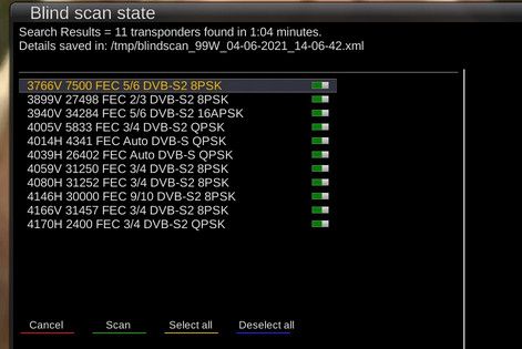

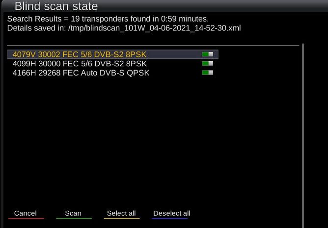

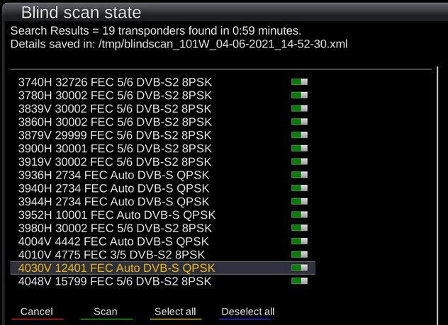

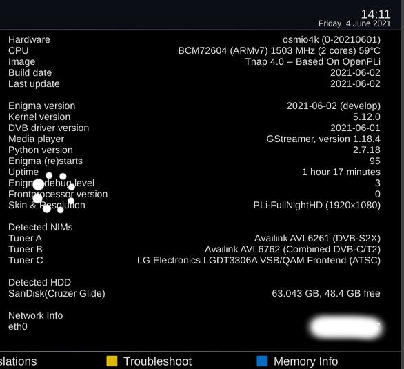

I updated to the latest version of TNAP4. Blind scan still not working right. Most services scan in OK but I sometimes have to manually scan both horizontal and vertical transponders on more than one satellite. Attached is the results of a blind scan on 99W and 101W C-band. You'll see that some transponders are missing.
So the services parameters are found with the blind scan part but is not scanning any services with the service scan? If that is the case then it could be a signal issue or just slow to lock transponder.
We can get the parameters from the blind scan log so want I do when that happens is try scanning the services using signal finder. Yes it takes longer but it is what it is. At least the parameters are mostly found with the blind scan using the Mio 4k. Most other enigma2 boxes the blind scan and getting the TP parameters is very hit and miss.
If there's a transponder hit during blind scan, it will log the transponder and scan in the services. I'm saying that some transponders don't get logged so I can't scan services on the missed transponders. That is the problem with blind scan. If I go to tvrosat and find what transponders were missed, I can manually scan them and get services from them. So, it's not a dish alignment problem or signal strength problem. Blind scan is not finding all active transponders. I hope I explained the issue well.
Ok, Yes missing a Transponder does happen. That is why keeping your sat. xml up to date is best and then use the manual scan for known services. If you think an older image works better then you could go back to that one. I have lots of full image backups here that work fine but I just like to keep up with the latest updates mainly for checking for problems. Like I said in another post I have pulled all sat. dishes down so I can't check the new sat. tuner driver at this time.
