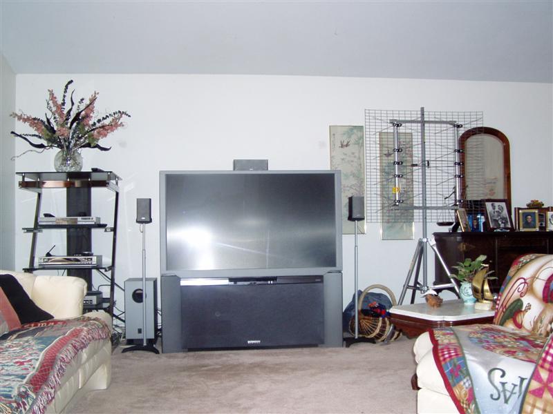

I've tested a lot of indoor antennas and I have to say that the Clearview models are outstanding. Their smallest indoor model pulls in as many or more than the ones you plug in or are larger. It advertises 25 miles but some of the channels are definitely further...
Check it out here...
Antennas Direct | C1 ClearStream HDTV Antenna for the DTV Transition
I just installed this in my summer place in Union Pier, MI and it pulls in both South Bend channels and most of the Chicago ones. (the lower frequency channel 2 is an exception).

Do yourself a favor and try this:
[ame=http://www.youtube.com/watch?v=EWQhlmJTMzw]YouTube - Coat Hanger HDTV Antenna![/ame]
It really does work exceptionally well.
That's a UHF only design. It's not a good antenna for Toledo.
Same with the coat hanger antenna.
I have the coat hanger antenna in the attic with an AntennaCraft pre-amp, and it brings in channel 7,(real, not virtual), which is about 45 miles away at 209° and the antenna is pointed to 340° for the Canadian stations. I also get real channels 11 and 13 good with it and they are farther away. It doesn't do well though with VHF low (2-6). YMMV.
I had no problem with the coat hanger antenna either other than I needed it tb mounted outside and it isn't exactly designed for outdoor use...At least not for long...But indoor it should last indefinately...
