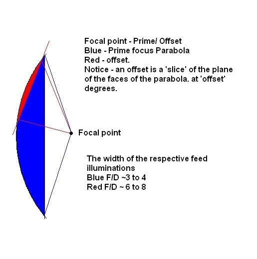

now this is getting more interesting. can I fabricate arms for the dish so I could make it an offset dish instead of prime focus? I would use the c-band lnb'f?' as prime focus and use the k-band lnbf as an offset. is that possible? charlie
No - an offset dish is simply a section of a much larger prime focus dish. Think of taking a petal out of a flower. The curve of the petal is the same as the large flower it came from, so its "focal distance to the pistil" is the same as when it was part of the whole flower.
Bob
Yes/ and no, I guess??? To operate as an offset you'd just place the Ku LNBF looking at one quadrant of the BUD. The feed would still only see that 'corner' - That 1/4 or so of the dish. The focal point does not "move". It's at the same place for prime focus and offset.
attachment.php
Being the focal point is 'the same' no strut mfg needed.
Hope this helped explain that an offset dish is still a parabola, just not the 'whole' of the prime.
You can very slightly offset a feedhorn by mounting it close to the prime focus spot... usually done when using multiple feedhorns to pull in more than one satellite at a time. I've done this on my 10' dish with a Ku LNBF. Problem is when it is offset, it doesn't track the arc properly if you are using an equatorial mount/actuator. Farther the distance from the prime focal point, the more distorted the focal point will be and thus lower gain and more interference (noise) from other satellites etc. (lower s/n). With a Ku LNBF mounted right on side of the c-band scaler ring you should get 4-5 sats (10 deg?) before the focal point moves too far off to the side. Hope this makes sense...
