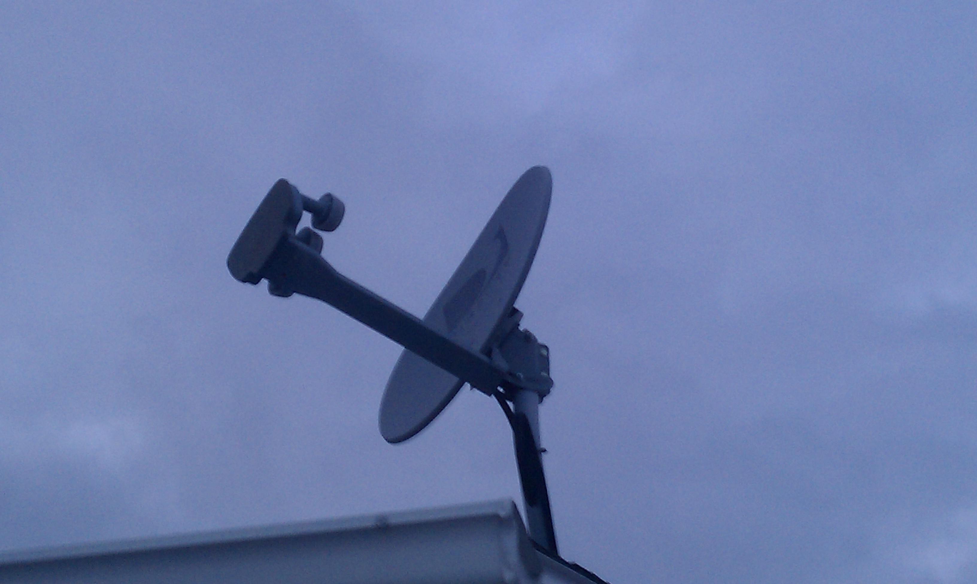

I am trying to set up a D12-100 receiver and I'm not having a lot of luck. The receiver was recently in service so I am confident that it is working properly. Also, the dish I am trying to connect it to was professionally installed and last in service just under 2 years ago. I am fairly confident that it is still pointed correctly, but of course, not certain.
After turning on the receiver, I went to the setup menu, but no matter which combination of settings I select, I cannot seem to show a signal. The dish on the roof comes into the house and is connected to a multi-switch (I've tried with the switch and without). I even tried doing a full reset, followed by setup with no luck.

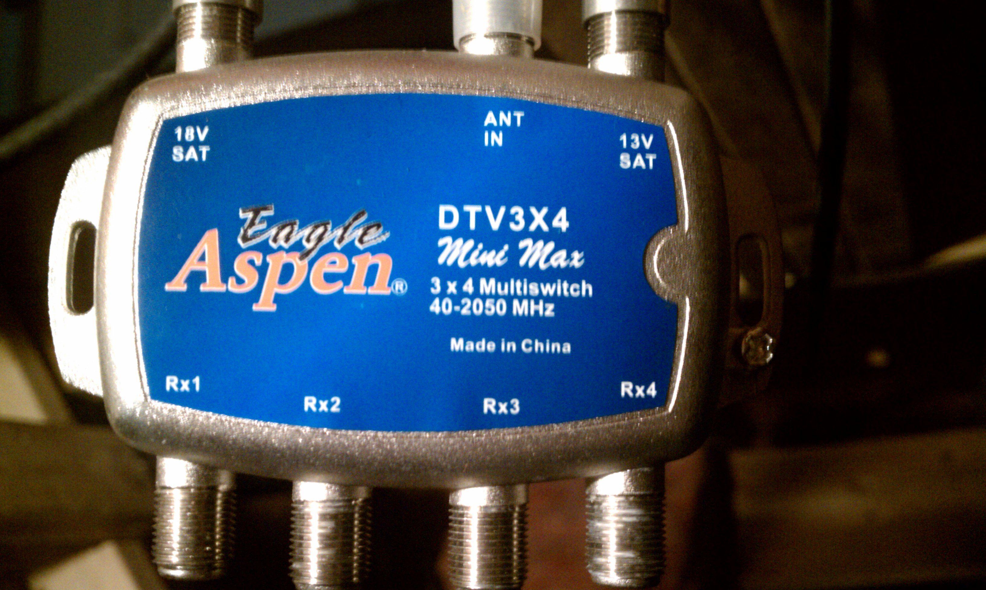

I am attaching a pic of the dish (sorry, best picture I could get) and switch. Any help in choosing the correct settings is appreciated.

Did you go through the Satellite Setup menu to configure the receiver for Multiswitch and 3 LNB 18x20 dish? No amount if wiring and rewiring will fix not having the receiver configured correctly.
I'd recommend leaving the multiswitch out of the equation (but you still need to configure the receiver for it). Try both cables coming down from the dish.
It is probably an old wive's tale, but if you're determined to complicate things by using the multiswitch, connect the D12 to Rx1.
That multiswitch and that dish are not compatible.
That dish will pull from the 101, 110 and 119
That multiswitch will only pass the 101 properly.
That dish has 4 outputs at the LNB.
You can run up to 4 tuners off that dish without a mutiswitch.
After that you need a 6x8 multiswitch.
Thanks for the info guys. Kjlued, that's interesting. That dish and switch are the exact setup that was in use 2 years ago. We had no problem receiving any channels at the time.
Certainly not married to the idea of using the multi-switch since I don't really need it. I did try the setup without it but will try again. Can someone explain why the multi-switch has a 13V port and 18V? When bypassing the multi-switch, does it matter which lead I use?

That mutiswitch might work work if you are only using the 101 sat but it could cause ghosting on certain channels.
If you do only need the 101, it might be easier to swap the dish out instead for a standard 18".

It has been described to me as ghosting, but maybe bleed over is a more proper term.
Apparently some have experienced bleed over from other channels on some channels when attempting to use a 3x4 on a multisat dish.
I don't know how common this and have seen it used before on that dish with no "known" problems (the customer may never have seen it on the channels they watched).
Of course, the 110 and 119 if being used will never work properly using that multiswich.

Well, still no luck. Bypassed the multi-switch and on the setup screen, selected 18" 3LNB and multi-switch. No signal on any of the sats or transponders.
This morning I got my hands on a cheap little sat finder. Next step is to hook that up and make sure I'm getting a strong signal.
Just 2 quick questions for you guys. The cabling from the dish comes down into the crawl space, from there I am using a connector to tie that line to the existing wiring which appears to have been run by the cable company. Is it possible that the cable company wiring is not allowing voltage to go to the dish. It's basically just a piece of coax from the room to the crawl space. Second, on the back of the receiver (D12), where the signal from the dish comes in, it says Satellite In (swm-1). Is it possible that this receiver is only compatible with swm?

Coax is probably good but without going down there you cannot be sure ... are you SURE your connected to the right piece of coax ?
Possibly a bad connection somewhere ? Or a missaligned dish ...
As for the SWM question, your fine .... theres only 1 input there anyways if its not a dvr.
It is likely that some of the couplers aren't rated for 2GHz. Multiple couplers also cuts into the ability of the cabling to transmit the voltage.
It would probably be a good idea to get the dish set up before exploring what's up with the inside wiring. Attacking one problem at a time is easier.
